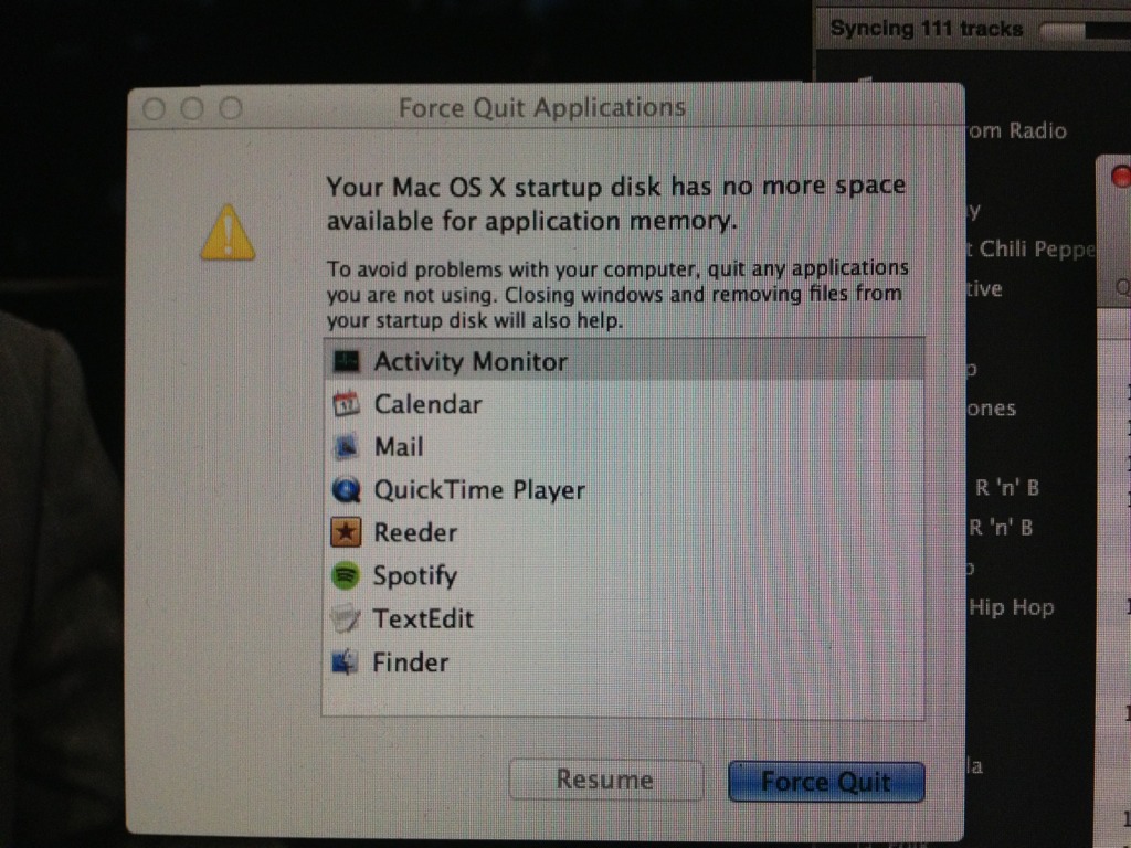

I had to restart my new MacBook Air with 4 GB of RAM because there wasn't enough space left as it as using all the available memory for SWAP. It's a bit ridiculous.

What version of OS X are you running? IF you're running 10.7.x, make sure you update to 10.7.5 and the the security update that will be available. If you're running 10.8.x, make sure you update to 10.8.4.
And looking at the process list, are you running the latest version of the dropbox software?

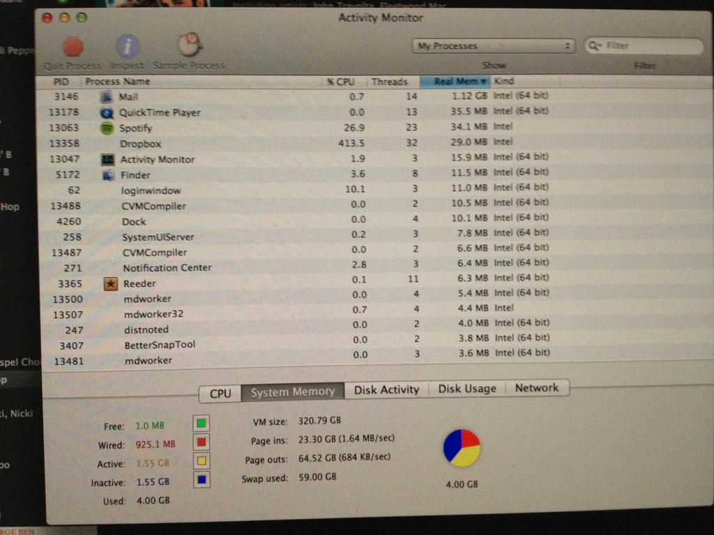

My question is what is dropbox doing that it is using so much CPU? (According to the images you posted.)
It could very well be the problem application. It might be stuck in a loop or race condition that is using up all of the system's resources.

Hi op, change 'my processes' to 'all processes'... Lets see what root activities are running.
I bet kernal_task is high.

Why is Mail using up so much RAM and why is Dropbox running at 400+ CPU usage?
Restart your computer, neither of those things are normal

Page Outs: 64.52 GB
Swap Used: 59.00 GB
I run 4 GB RAM on both my 2012 Air and 2007 iMac. Even after being on for several days, including lots of browsing and some video encoding, I have never seen numbers bigger than about 5% of the ones you are getting.

WTF? With just that? Something there has a fierce memory leak. The stuff you have there shouldn't even require 512mb ram lol.

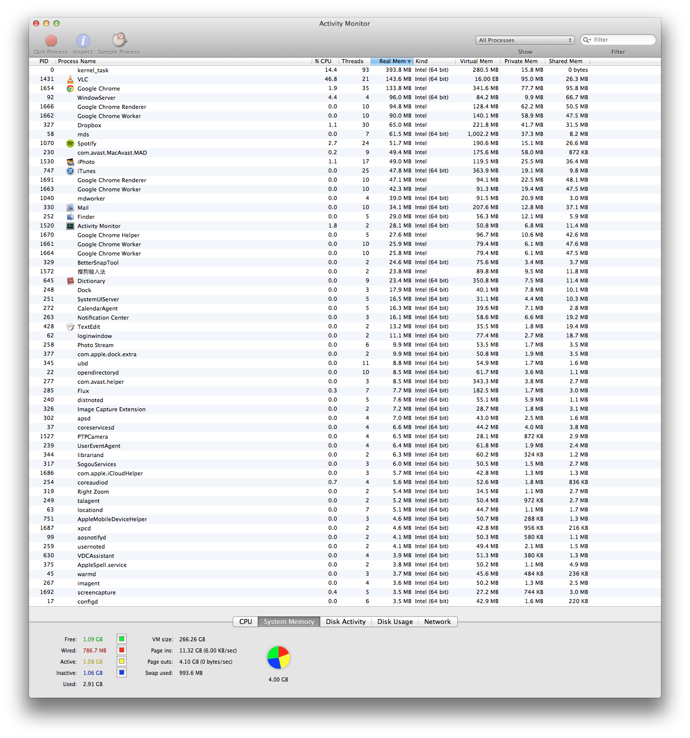

Ive been running my 2011 MBA with 4gb of ram since launch and ive never had that warning come up or even close to that amount of swap used. There is defiantly an app or process playing up there. Why is mail using 1gb of memory lol??? Here is a screenshot of my activity monitor.
