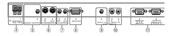

I have a Powermac Dual Ghz MDD with and Ati Radeon 9000. I want to hook it up to a Pioneer 43 inch Plasma. My 9000 has ADC and DVI. My Plasma has the following inputs, AV in, S input, i/o link.a, RGB in and Y/Pb/Pr In. Are there any cables to hook them up?

Call me retarded but which of the connections I listed is vga: AV in, S input, i/o link.a, RGB in and Y/Pb/Pr In?

There should be some VGA to RGB and S-video convertors out there, they may even have embraced DVI.

Use two adapters.
ADC (or DVI) to VGA adapter.
Then an SVGA to BNC breakout cable.
VGA is analog RGB with either composite or separate sync, depending on how the ID bits are returned. Your RGB inputs should be either 4 or 5 BNC connectors, three for Red Green Blue and one or two for either Sync or H Sync and V Sync. The VGA breakout cable will usually have 5 BNC connectors on the other end. I had several of the VGA to BNC cables but sold them, but they're a very common item.
The other connectors you have would require electronic conversion: AV = composite video (fine for Playstation), S = RGB connectorized onto a mini-DIN (for camcorders), Y/Pb/Pr luminance and quadrature chroma (for TV stations?); I have no idea what Iolink.A is.
Somewhere along the line the computer will have to decide what resolution to run the screen at.

Originally posted by Sun Baked
That link lists - PDP-433HDE
PC Signals VGA, SVGA, XGA, True XGA
OK, so all I need is a VGA adapter. What would be better about True XGA? Just quality?
EDIT: I just did a quick search and DVI to True XGA appear to be very few in number or non-existant. Well looks only £14.99 I'll be spending on this. Not too bad of deal.

Re: Use two adapters.
I looked at the manual for a Pioneer Plasmar tv, and one of the input is analog RGB in a computer style connector.
You should have support for VGA 640x460 through True VGA 1280x768
[read the manuals - or download them ;)]
