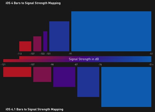

    Settings> General> Reset> Erase All Content and Settings.
    Make sure to do a back-up before, but when you set it up do it as New, if this doesn't work then you can repeat step 1 and restore from your back-up to get all of your data back.
    Also, you can conduct a test to see just how bad your reception is.
    In your Phone.app dial *3001#12345#* and press call.
    The farther away from -51 (or closer to -120) the harder your phone has to work to maintain that connection = reduced battery.
    [​IMG]
    [​IMG]
    I agree.

    ok, just restored the phone and setup everything as new.
    Ive only used exchange for contacts and used normal gmail settings for email and calendars.
    Have also dont the signal strength test and with 3 bars of 3G I have -88
    Will see how this goes and report back later.
