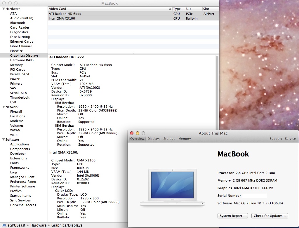

its very interesting to see the weird name that SL gives the Auto inted AMD Radeon HD 6870, I suspect that's due to early drivers for the card etc looking at the driver code 10.6.8 might actually ID a AMD Radeon HD 6970 properly, if you have one of those lying around as well might be worth a quick test :) (although it's worth noting no mac ever shipped with that GPU so the drivers may be buggy esp in later OS X versions)
Would a 6950 also work? I might be able to borrow one.
does anything show up under PCI devices?
Nothing at all.
its a shame the card does not have a reference port layout as those have 2 display ports :)
Yeh, unfortunately I didn't pay attention to that when I bought it.

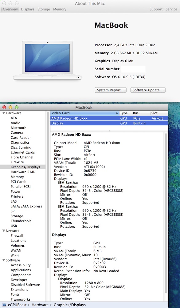

Here's what Lion, Mavericks (and Yosemite) make of the card - I noticed that ATM shows the X3100 in Lion and Mavericks whereas it shows the 6850 in Yosemite. However, with the 660, Mavericks also features that one in ATM.
Reactions: LightBulbFun

interesting stuff :)
I think what shows up in about this mac is down to A: what GPU your main monitor is on and also what screen you bring up the about this mac dialog box on
as for the 6950 im not sure, if you can borrow it without any fuss, its always worth a try :)

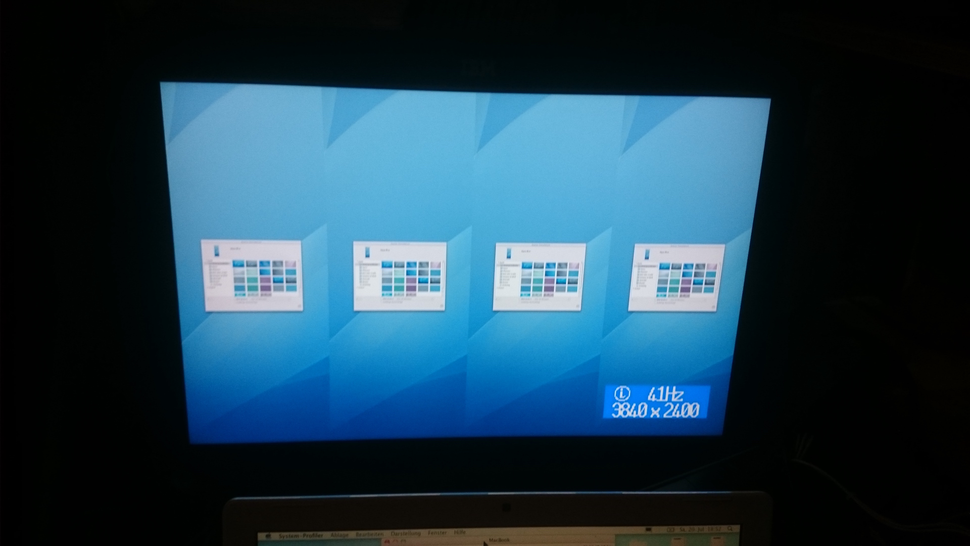

Making one of Bertha's stripes the main monitor causes the Radeon to be shown in ATM - thanks for clearing that up :)
More experiments - the newer DGP does indeed accept three 1280×2400 stripes, thus I can now get 46 Hz on it from the 6850 :)
I'll have to admit that seeing the fourth DVI just dangling is slightly... odd :p
UPDATE: 46.7 Hz at 165.00 MHz pixel clock.
