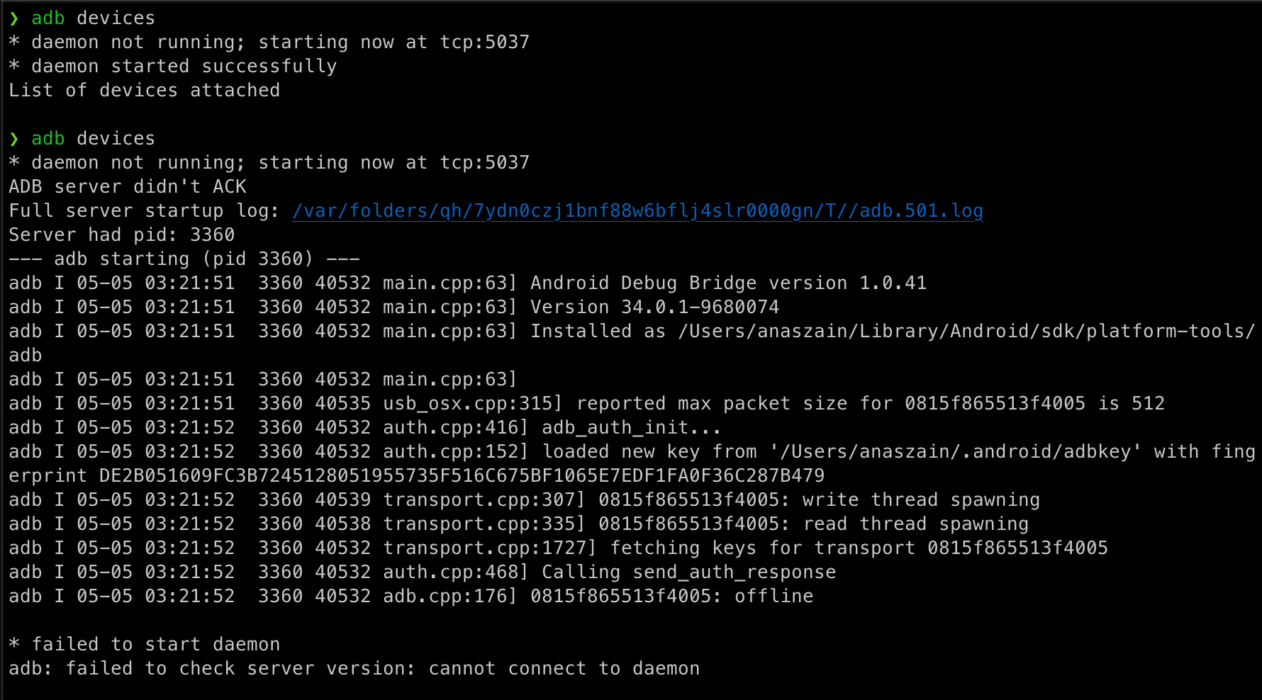

I recently installed Ventura on my old Mac using open-core Legacy Patcher. Still, after installing android studio, the ADB devices only successfully run when the emulator is connected. Still, when I plug in an Android device, the ADB server always fails to connect.
I tried every solution on the internet and nothing worked
Any solution?

Could you please be more specific? Where in System Settings is the "Disable AMFI" option? I searched in the Settings search box for AMFI and nothing was returned. Just to be clear, is the objective here to have AMFI enabled? I have the latest OpenCore 0.6.8 and `ps aux` shows /usr/libexec/amfid running as root so do I take it that AMFI is enabled? adb is still not working. `adb server start` returns "ADB server didn't ACK ..." as before. That's with my Galaxy A7 connected via a cable which works fine with Anroid File Transfer.

I don't know if this will clarify anything but I only had this issue when I upgraded Ventura to 13.3.1. Prior to this adb was working and Android Studio connected with my Galaxy A7 without problems.
