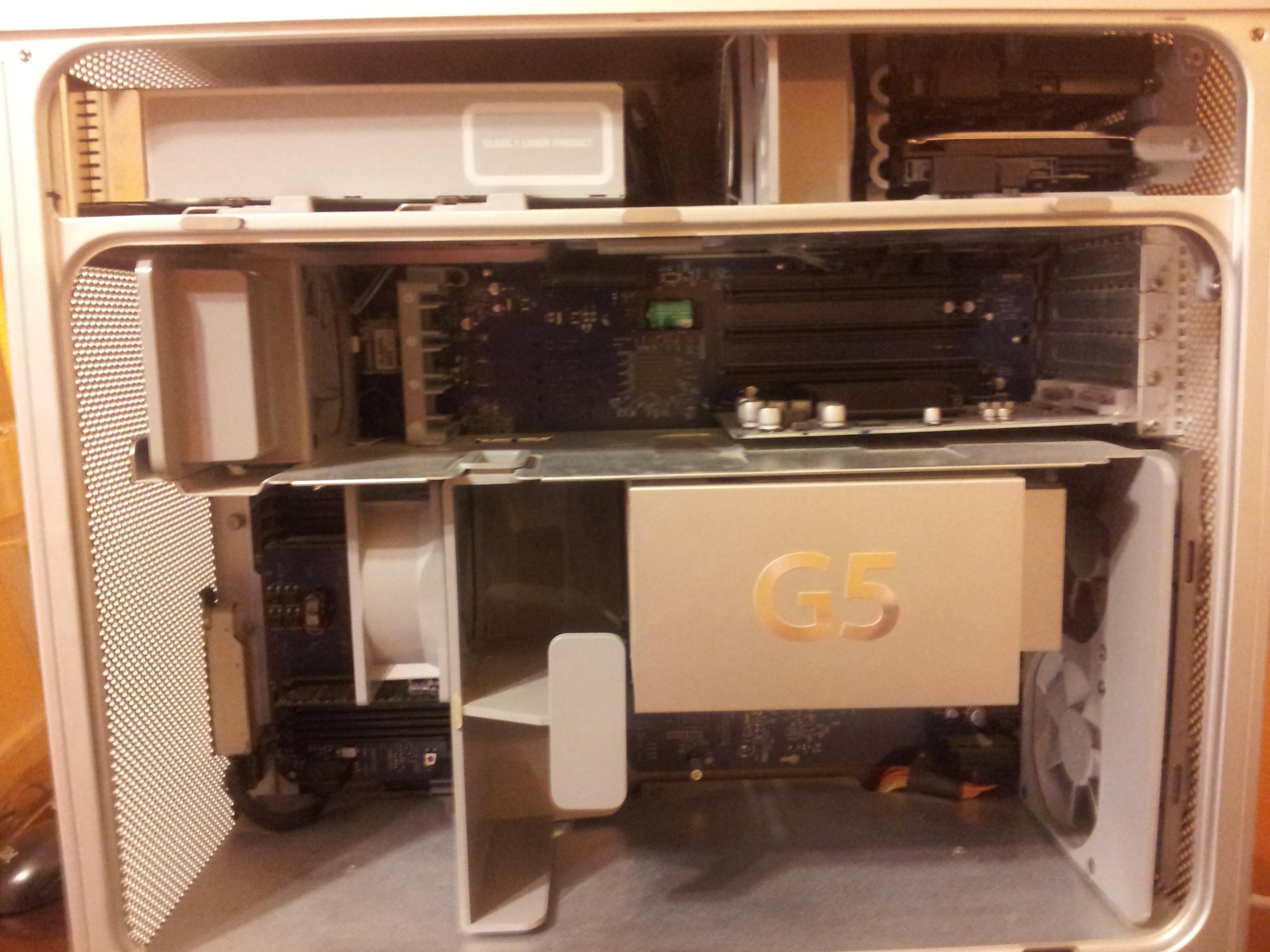

The card is airport extreme. There should be 2 sets of wires. One for Bluetooth and a single that plugs into the card. Shoulb be middle left right below the fan with the speaker that blows air across video card area.
This is the inside...

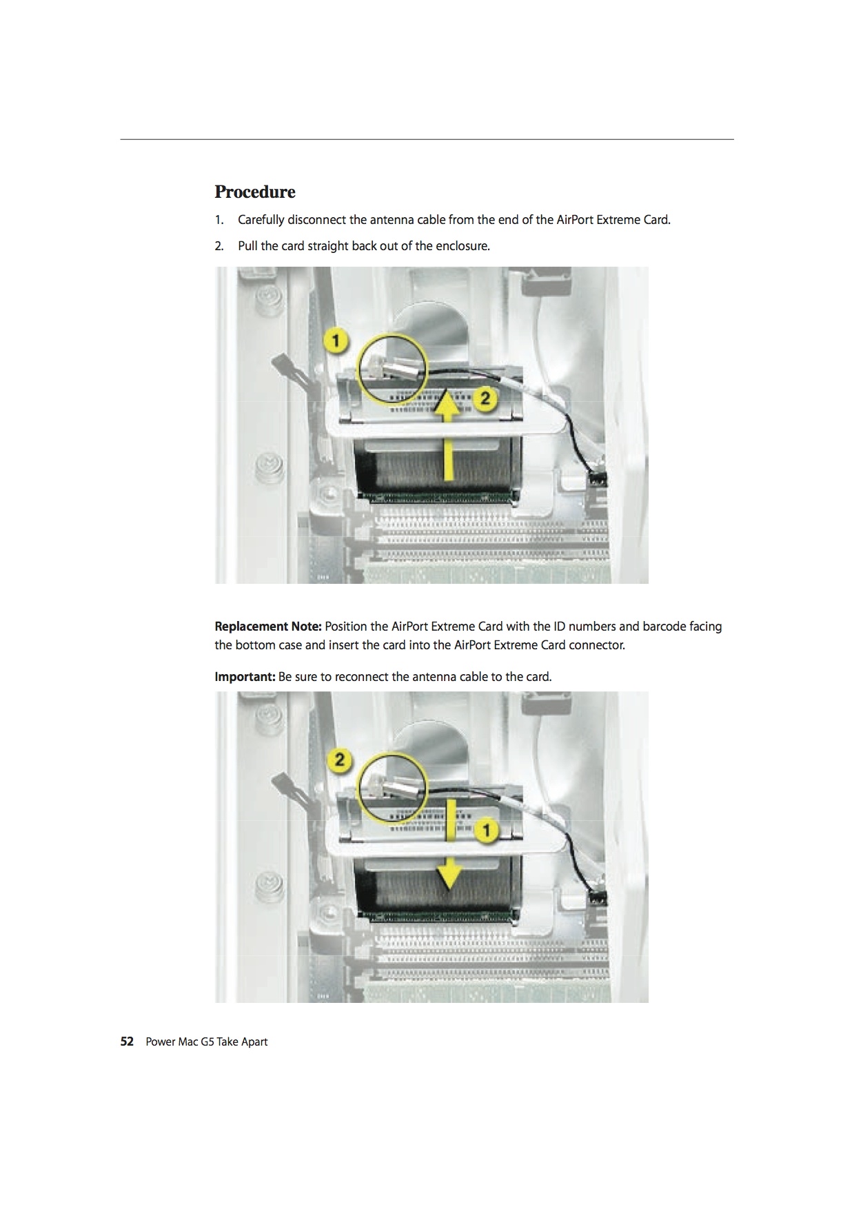

This a copy of the Apple service manual page for a June 2004 1.8 single processor. I assume yours is a June 2003.
Can you see anything just above the RAM slots?

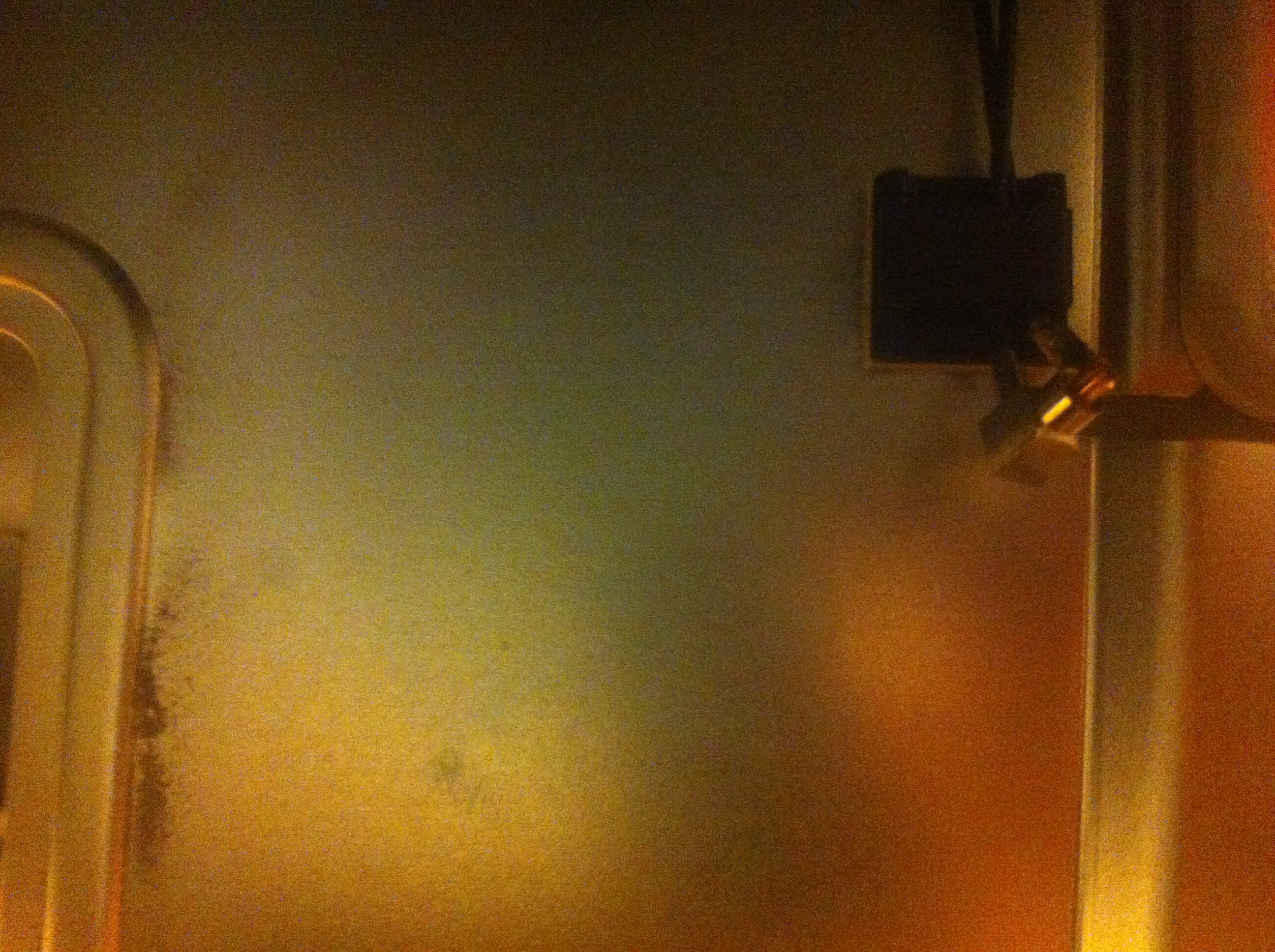

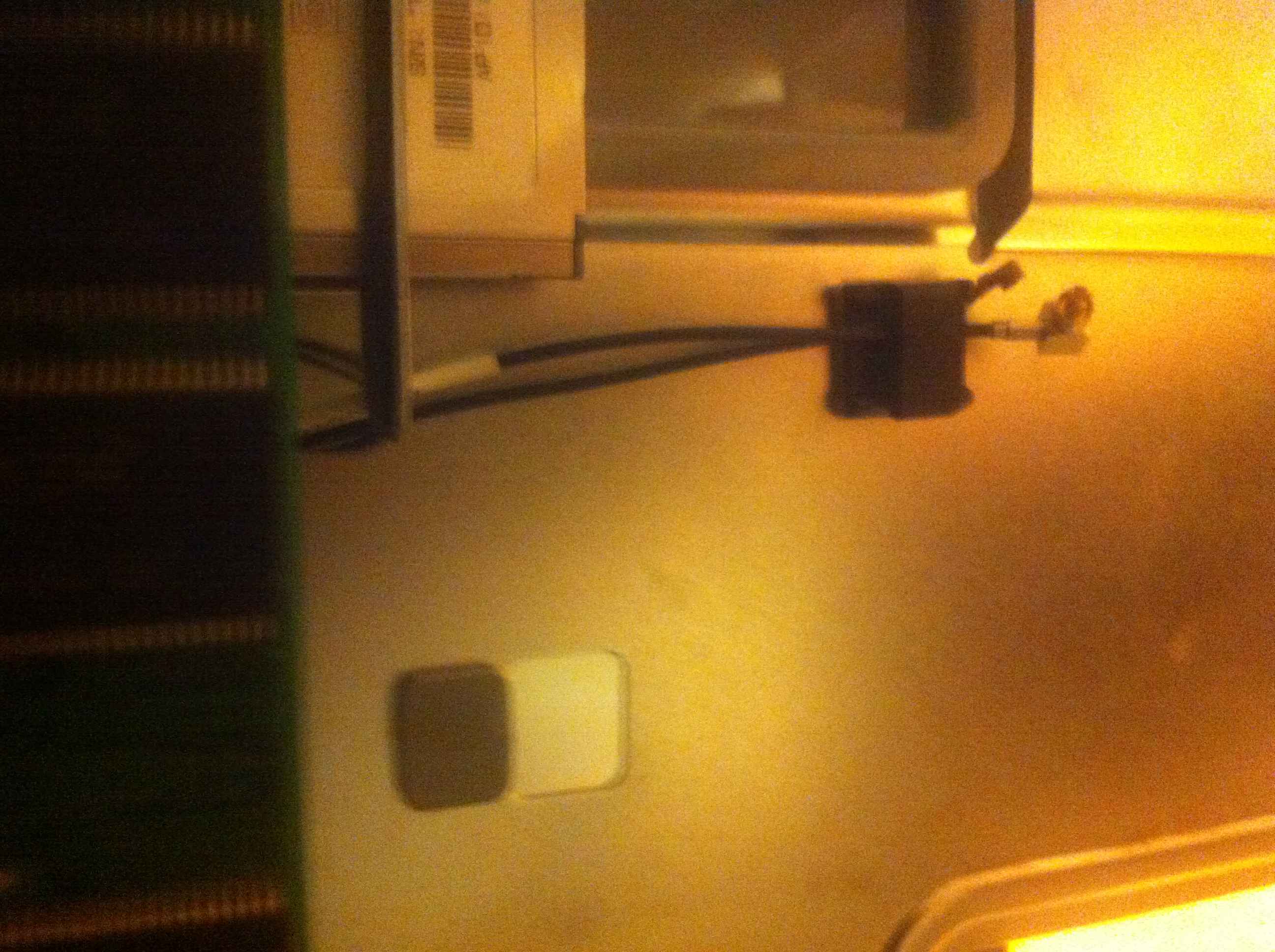

Okay, got the card in. Still having trouble with the cables though. Here they are...

Rather slide screwdriver's blade between clip "arms" and try to turn it left or right (gently ofc).
Wow, what an adventure!
Managed to get the clip off, took a few pushes, but then I saw it open its little arms and knew I was getting closer, so pulled out the wires gently as I held the clip open.
