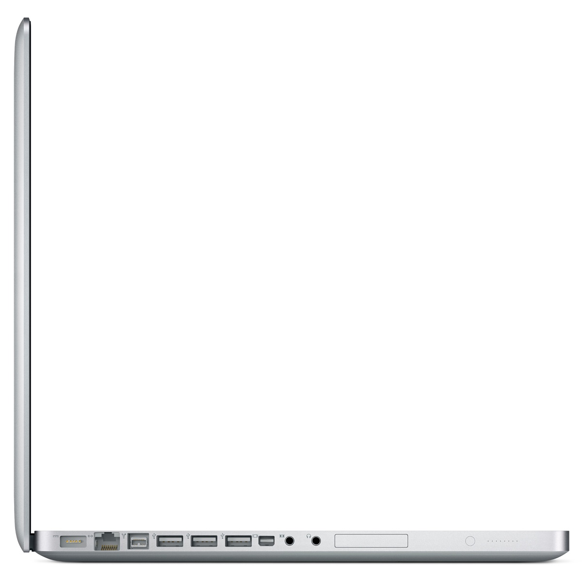

Frosties
macrumors 65816
Jun 12, 2009
1,079
209
Sweden
The picture is from the link above and the description is below, not the first ad to have questionable info in it. Call apple and find out what computer this is before purchase.
Display 15.4-inch (diagonal) LED-backlit glossy widescreen display, 1440-by-900 resolution
Expansion Three USB 2.0 ports (up to 480 Mbps)
One FireWire 800 port (up to 800 Mbps)
