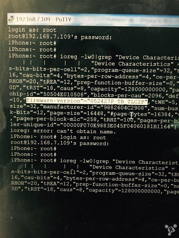

    Chinese geeks made a tool for identifying which memory the device has in it. I myself didn't try yet because I don't have the new iPhone.

    Don't believe the test results from phone doctor too much. It can't distinguish the actual writing on memory from RAM and the caching from RAM. That's why sometimes writing is seemingly faster with TLC than with MLC. It's just what Apple wanted to be shown like using cache memory trick.
