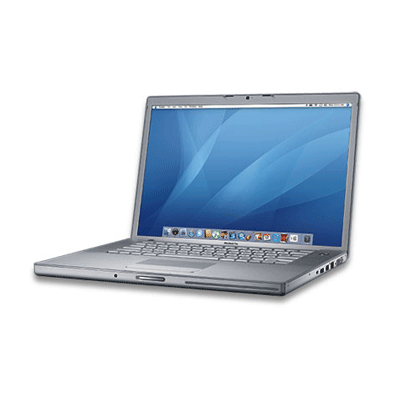

    Is it the new one:
    [​IMG]
    or the old one?
    [​IMG]
    If it's the new one you will need a Mini DisplayPort -> DVI Adapter
    If it's the old one it should work right out of the box since it does have a regular DVI port on the right side of the machine.

    Ok, then you will need a the Mini DisplayPort -> DVI adapter that I linked to above.
    You should not get the Mini DVI -> DVI since it won't fit, it's the one that the old Macbook's use.
    How is the HP monitors currently connected to your PC? If they're connected over DVI it can be quite the hassle to switch back and forth between two cables if the monitors don't have dual DVI inputs.
