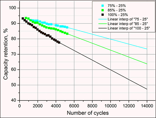

  24. BigMcGuire Contributor
    BigMcGuire
    Joined:
    Jan 10, 2012
    Location:
    California
    #24
    Definitely. I'll be 100% honest too. Days I know where I don't need my phone's battery, I'll let it drop to 50-80% and smile knowing I'm being a bit nicer than usual. Today is one of those days :). Both my watch and my phone are under 80% (sitting at around 70%). :)
    I imagine the battery would last significantly longer if I did that all the time.
    I love looking at this chart:
    http://batteryuniversity.com/index.php/learn/article/how_to_prolong_lithium_based_batteries
    [​IMG]
