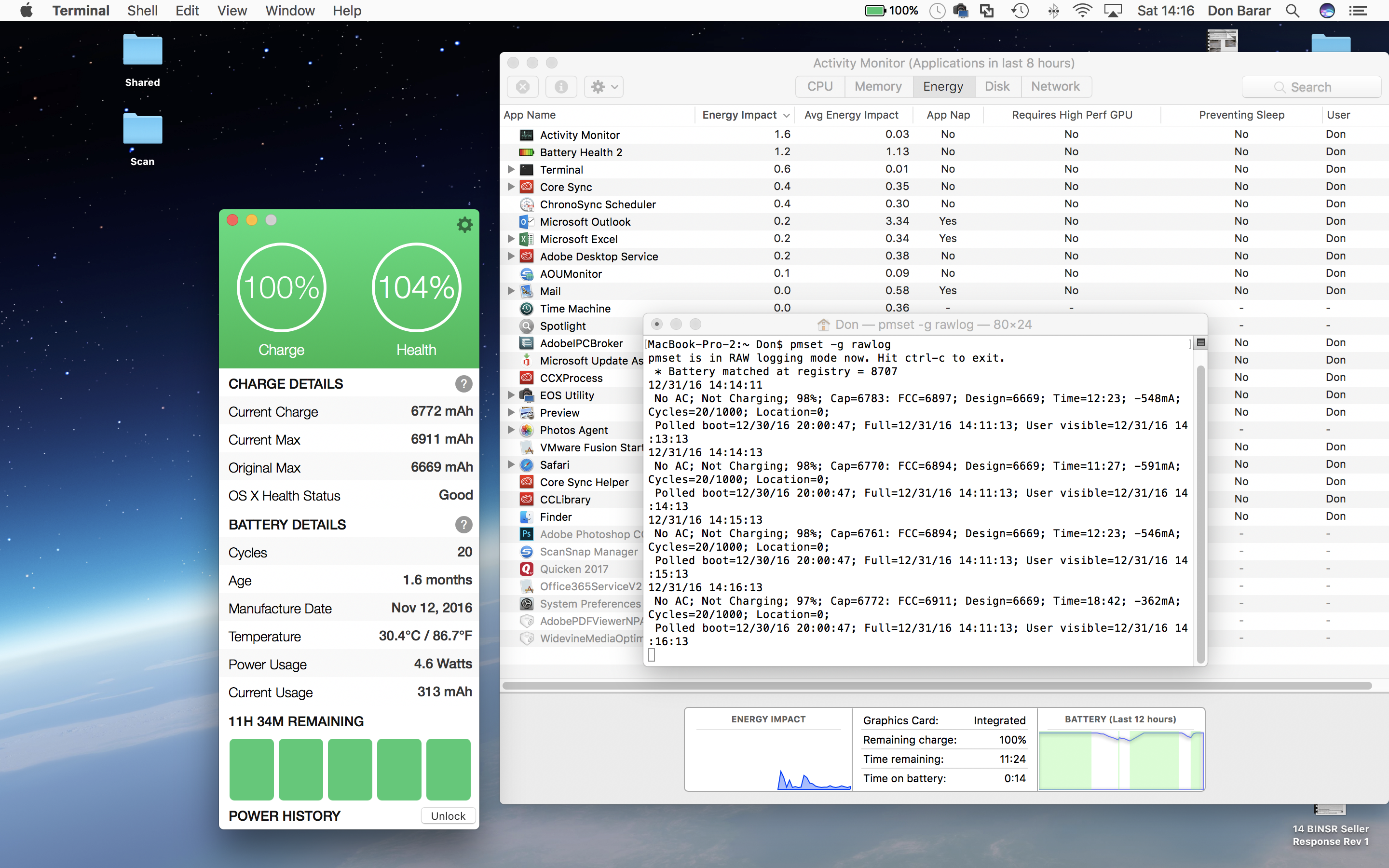

What I could see with pmset is that remaining time reported each minute is exactly the qoutient of capacity and current drawn as reported by pmset.
The remaining time from pmset seems to be identical to what coconut battery reports.
When running a mixed load of Office an Adobe CC apps, current draw could vary a factor 2x between consecutive minutes as would then the remainnng time, hence I doubt this is a long-term average.
Please note that these observations are for a 13" 2014 MBP run 10.12.3. I ordered my 15" maxed out MBP the day after the keynote from a local reseller and I am still waiting. ☹️

[doublepost=1483219563][/doublepost]Hi M,
Just ran a test with Battery Health 2.0, Activity App, and pmset -g rawlog. I took a screen shot just as pmset updated. See attached--last log item. In summary, I got the following results:
pmset: Charge Remaining = 6772 mA, Draw = 362 mA, Time Remaining = 18:42
Battery Health: Charge Remaining = 6772 mA, Draw = 313 mA, Time Remaining = 11:34
Activity App: Charge Remaining = N/A, Draw = N/A, Time Remaining = 11:24
From this information I would agree that pmset is an instantaneous result. However, what is displayed by Battery Heath and the Activity App is something different. My impression is that is average of something. Most likely results from pmset over some unspecified time period.
Great find. I was unaware of pmset.

Hi M,
Thanks for info. Let me try again and see if this revises my opinion.
Happy New Year,
Don
Just ran a test with Battery Health 1.3, Activity App, and pmset -g rawlog. I took a screen shot just as pmset updated. See attached--last log item. In summary, I got the following results:

What is the Green APP showing in your post ?
