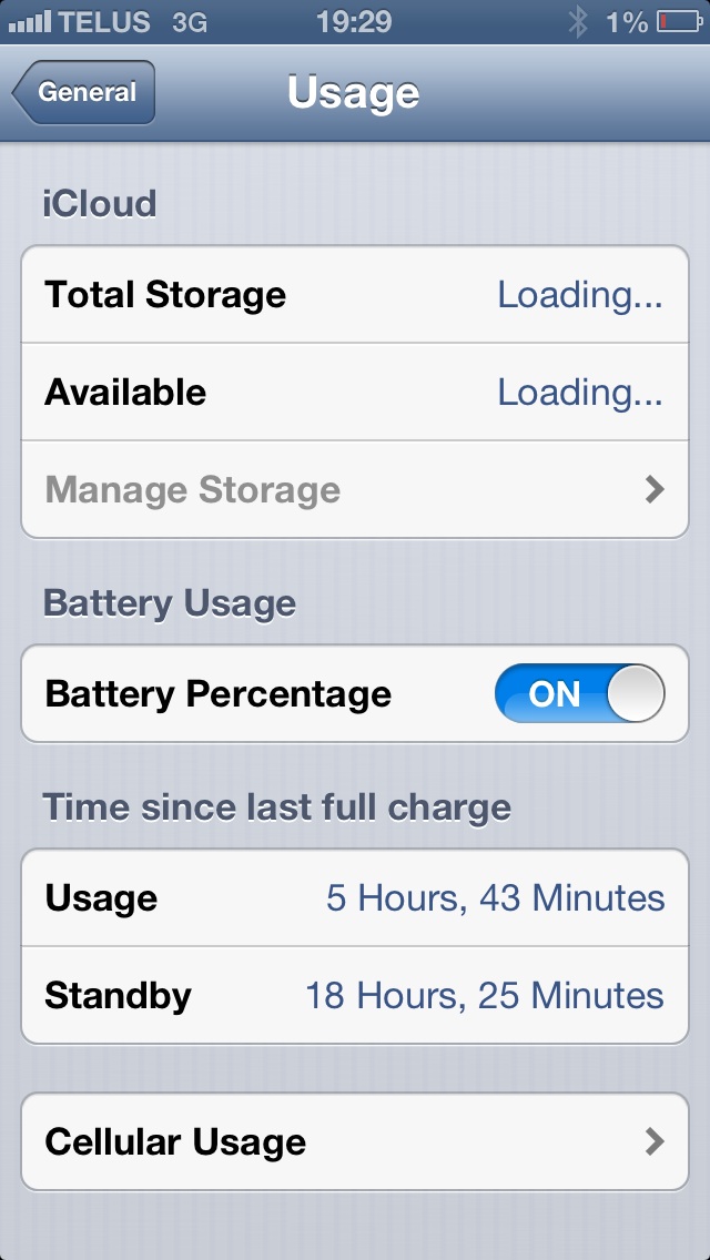

    Hi everyone,
    The last two times I have allowed my iPhone 5 64 GB to get low it has suddenly dropped percentage. It has gone from 25 down to 7 in a second. Also has gone from 14 directly to 7. Then while it is draining it will stay on 1 percent until it dies. Is this a normal issue? It has been on 1 percent for an hour now and it's still going.
    Any input would be appreciated.
    Thanks.

    Sounds like a calibration issue. The battery's actual charge remains unaffected, but the battery is incorrectly reporting remaining charge to the OS.
    Usually, discharging the phone from 100% (fully charged) till it shuts down, then charging it back to 100% (fully charge) will solve the issue. Make sure you complete calibration all in one step - don't plug in or unplug the phone until you have completed a full cycle.
