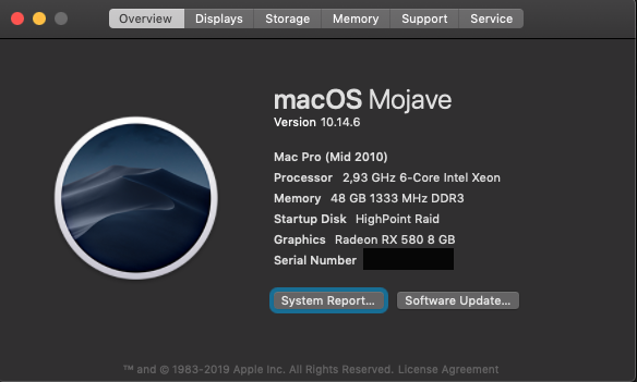

I, respectfully, disagree with you. Got a HighPoint SSD7101A-1 with 2x970 Pro in raid0 and is bootable and running macOS Mojave without a problem.
This is the speed I get and is fairly consistent

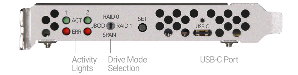

AFAIK, PCIe NVMe cards with a physical switch for hardware RAID do not yet exist. You'd really need something like this with drive mode selection, but NVMe instead of SATA SSD:

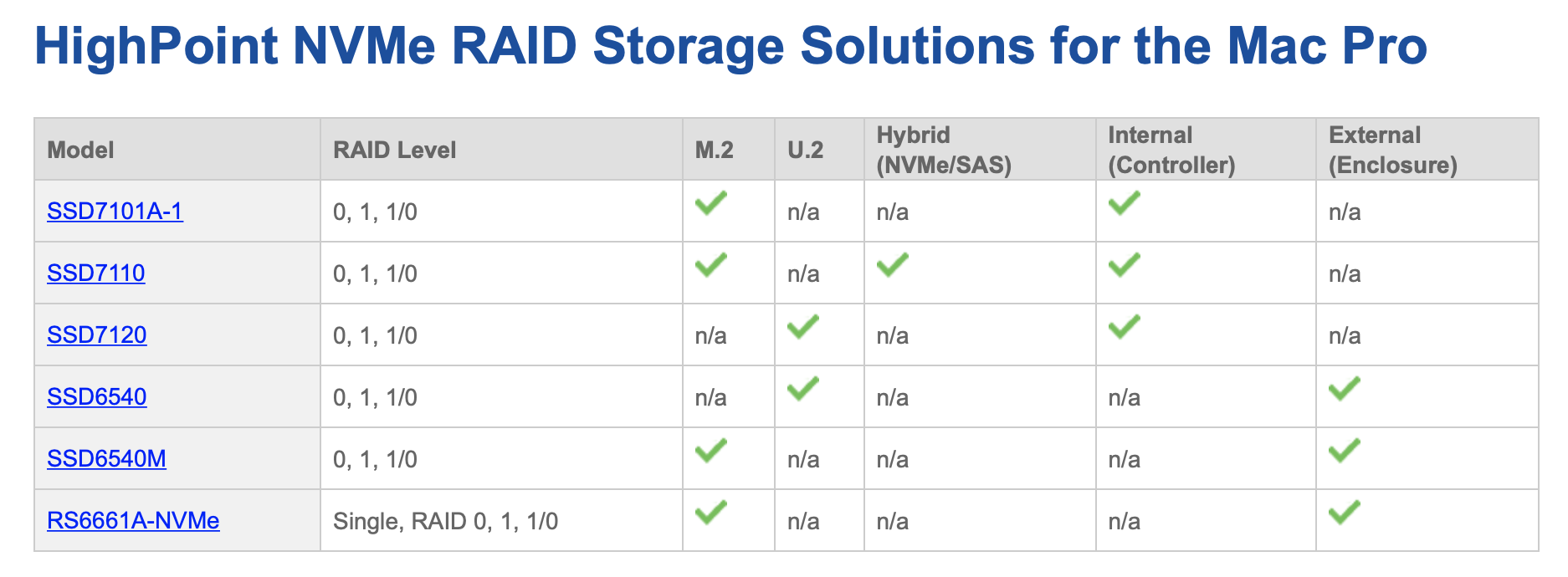

This chart is the best summary for the available HighPoint cards with MP7,1:

I checked the Highpoint website, and in the specs for the SSD7101A-1 they say:
Storage ModeData Storage only (non-bootable)
In the feature matrix two other models, SSD7103 and SSD7110, are explicitly listed with a green tick for boot support, but the SSD7101A-1 not.
So, I expect the SD7101A-1 does not have hardware raid, and is depending on driver luck to work. 🙂
this matrix reference to a windows system
the 7101A-1 has boot support under macOS
but unsupported as bootable RAID by macOS

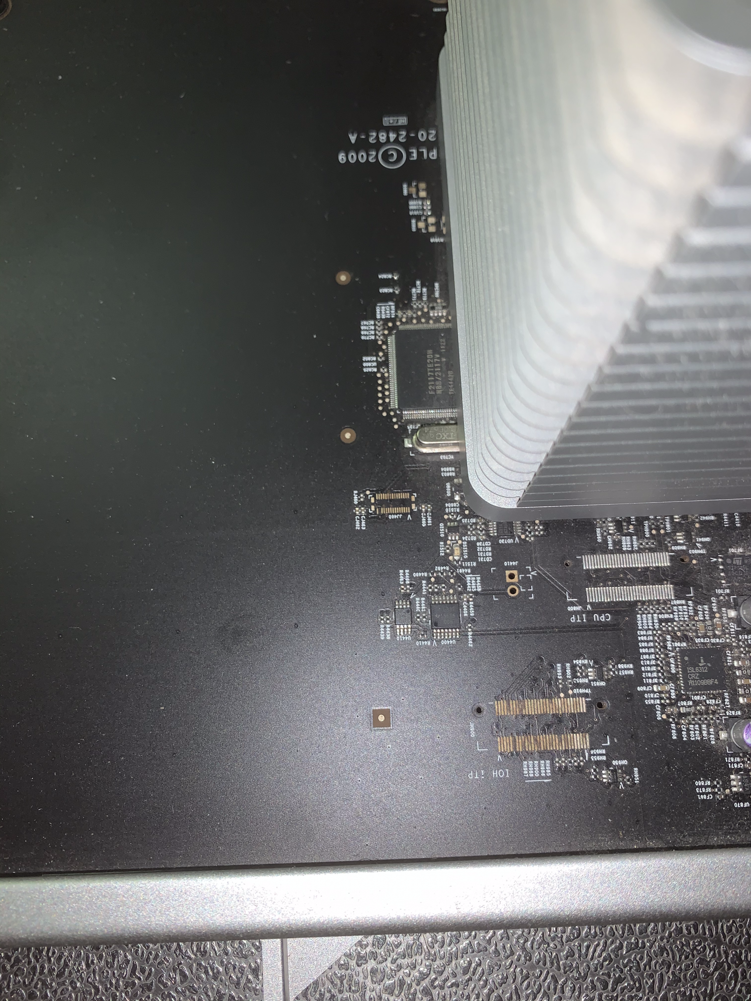

If a red led lights up when starting my cMP (which it doesn't), does that mean that my processor is gone?
If so, damn got some work to do
yes, its the one in that corner; luckily still got my Macbook Air (early 2015)
@tsialex
Bom Dia Alex
This is not the correct thread to do this, open a thread for your problem or use other diagnose thread.
Download the Apple Technician Guide for Mac Pro 2010 and go to pages 33-38 to know how to use the Diagnostic LEDs of the backplane.
