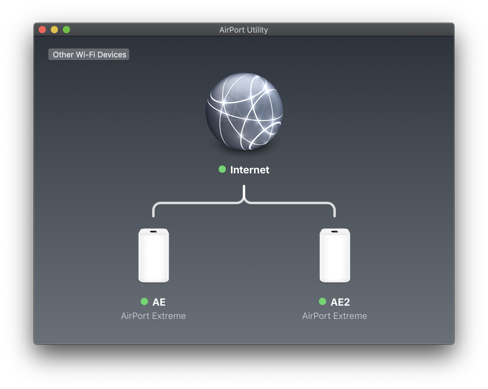

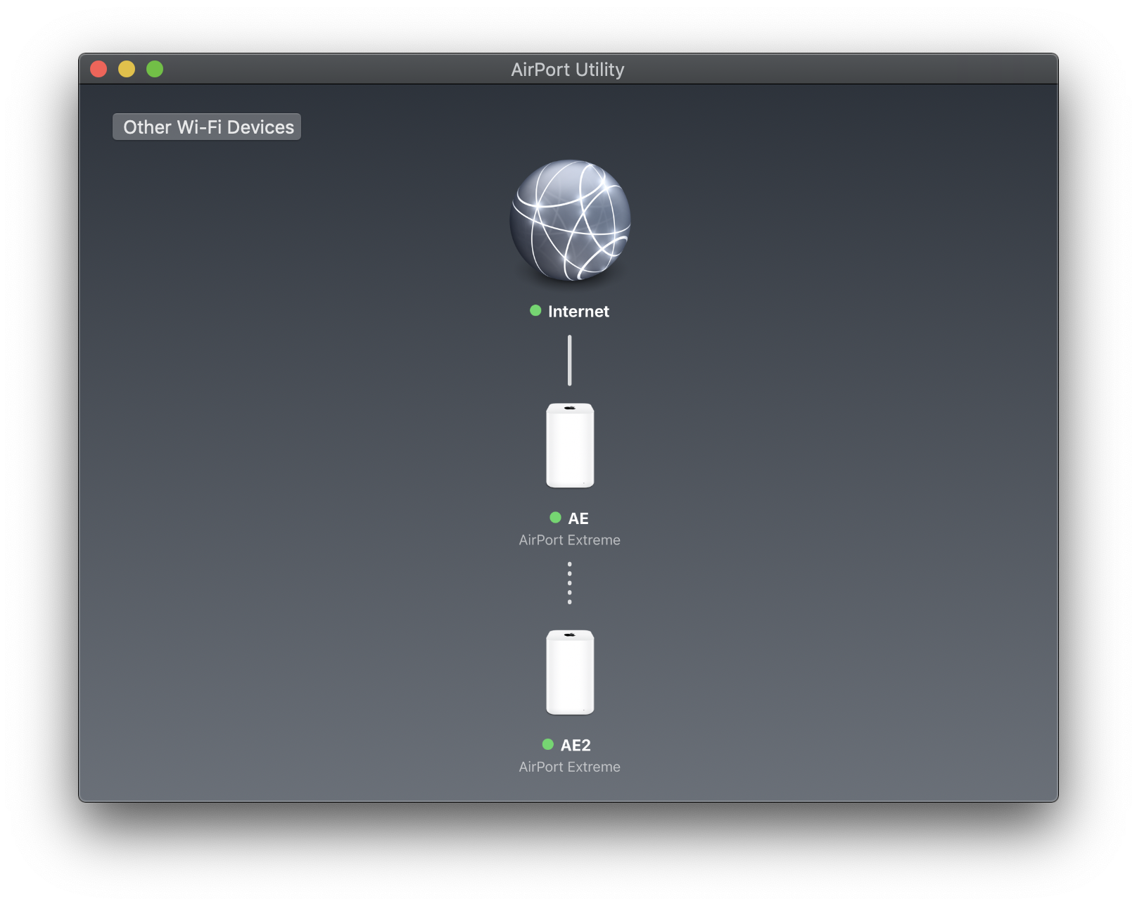

Before:
After:
Hopefully this will help others in a similar situation to mine.
