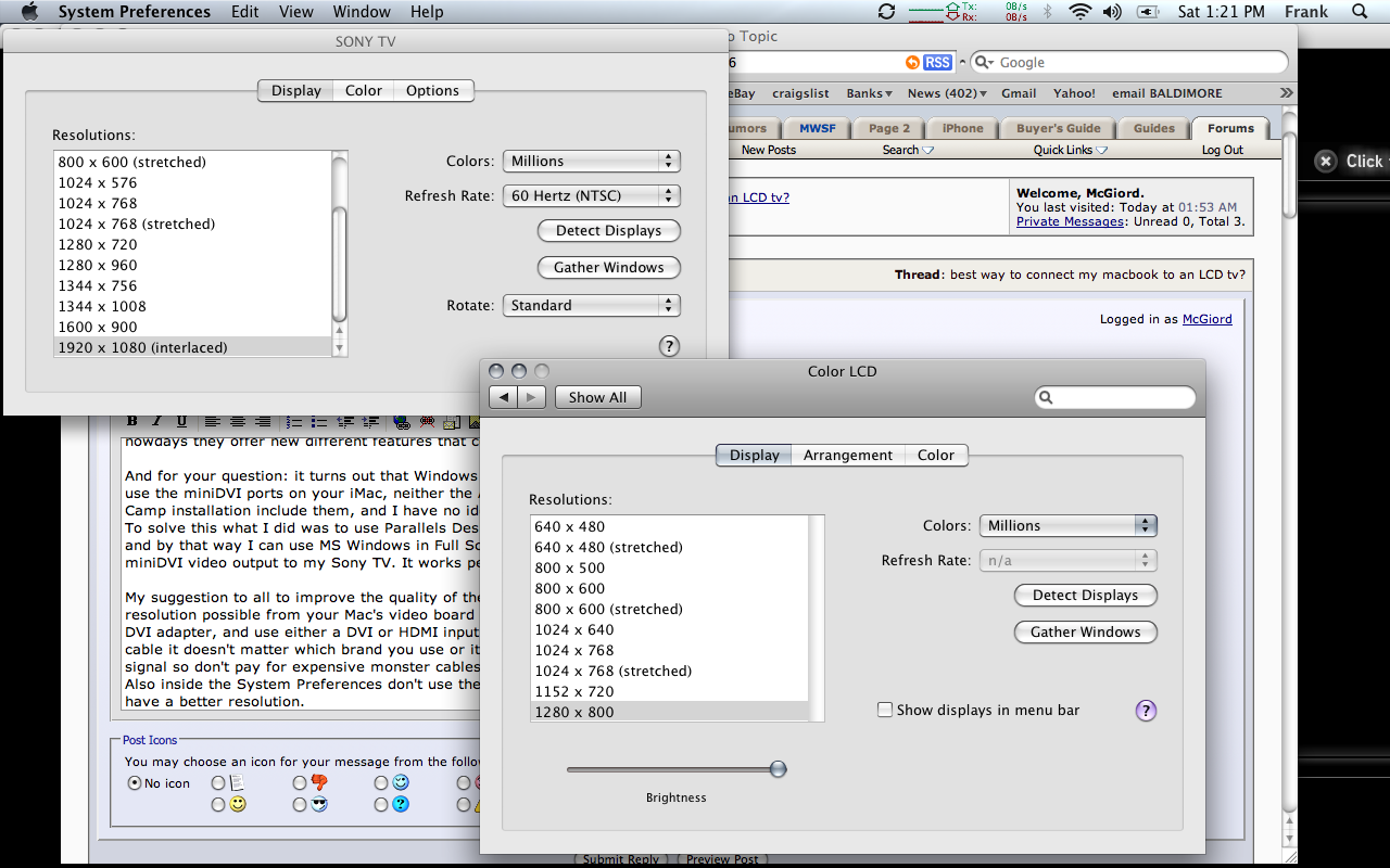

  25. McGiord, Feb 2, 2008
    McGiord macrumors 601
    McGiord
    Joined:
    Oct 5, 2003
    Location:
    Dark Castle
    #25
    I have a MacBook and a 40" LCD Sony Bravia XBR2.
    You are right, the best personal computer experience is with a Mac, I have been using them since 1986 and I can do anything on them I ever needed, maybe some of the new models don't offer the same features they had, for example the video and audio input/outputs they had in the 90s, anyway nowdays they offer new different features that compensate.
    And for your question: it turns out that Windows doesnt' have the drivers to use the miniDVI ports on your iMac, neither the Apple drivers in the Boot Camp installation include them, and I have no idea if they are goign to.
    To solve this what I did was to use Parallels Desktop in Full Screen Mode, and by that way I can use MS Windows in Full Screen while using the miniDVI video output to my Sony TV. It works perfectly.
    My suggestion to all to improve the quality of the image by using the highest resolution possible from your Mac's video board and by using the miniDVI to DVI adapter, and use either a DVI or HDMI input in your TVs. About the cable it doesn't matter which brand you use or its price, becasue it's a digital signal so don't pay for expensive monster cables, they aren't really needed.

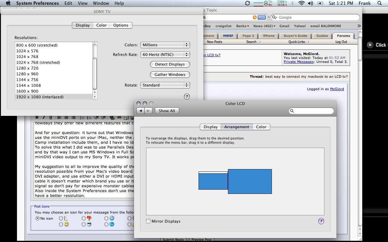

    Also inside the System Preferences you'll have 2 widnows to adjust your Mac's and TV preferences:
    In my case becasue I'm using the digital video input my Mac's recognize the TV as a SONY TV, if you use the analog video like RCA or S-VIDEO your mac just see it as a NTSC/PAL TV.
    The first window you'll have is named LCD TV, in that one you'll define your Mac's video resolution and in the Arragenment tab you will define if you want to mirror to your TV all what you see in your Mac's screen or if you what to use your TV as a second screen.
    And when you click the Gather Windows button you will obtain the second preferences window, in my case named SONY TV, where you can adjust the video to your TV capabilities with the :apple: video adpater Im using, in my case the max resolution I get is 1920x1080i (interlaced)
