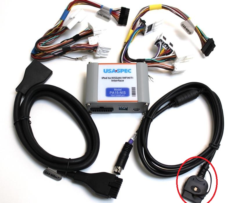

  14. myMacRumors, Mar 6, 2013
    myMacRumors macrumors regular
    Joined:
    Aug 18, 2010
    #15
    no, just buy one of the Apple lightning-to-30-pin-adapter based on your needs; the 0.2M/8-inch will provide more flexibility for other usage
    the Apple lightning-to-30-pin-adapter is needed because the USASPEC cable as circled in red
    you will be satisfied (no drawbacks)

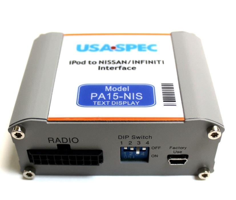

  21. myMacRumors macrumors regular
    Joined:
    Aug 18, 2010
    #22
    Make sure u tell Cartoys that u want to use the aux
    Aux input is enabled by setting the DIP Switch #1 on the interface adaptor to ON position.
