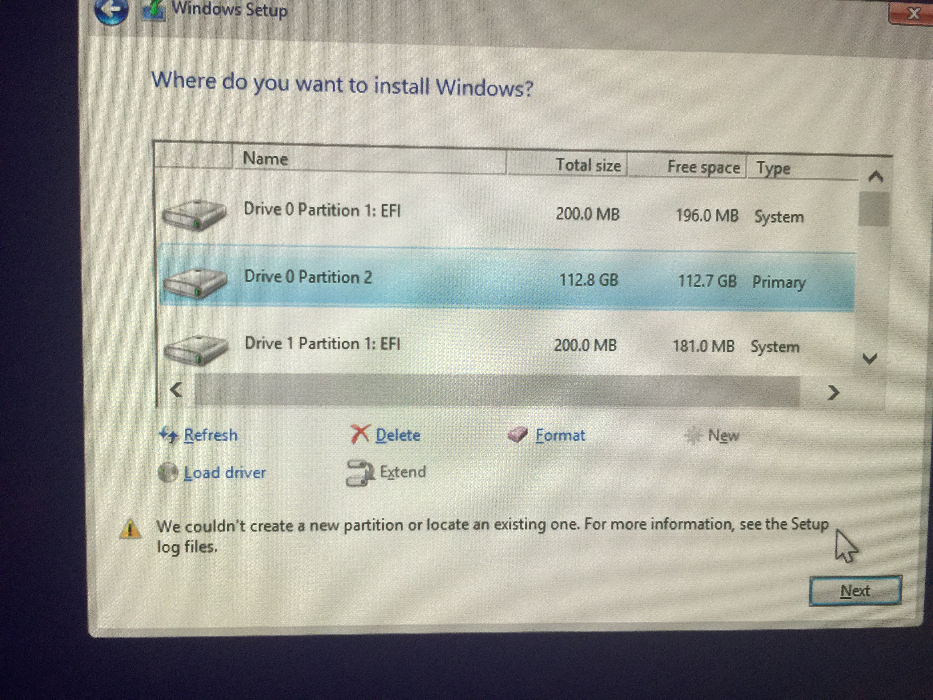

    Here's the situation. If I leave the 3.1TB Fusion Drive intact, I can install Boot Camp with NO issues at all via the Boot Camp assistant - which of course means Windows does not go on the SSD... If I split the 3TB Fusion Drive from Terminal and end up with a 3TB Disk and a 120GB SSD as intended, there's no way for me to install Windows on the SSD. I get an easily repeatable error, as seen below:
    "We couldn't create a new partition or locate an existing one. For more information see, the Setup log files."

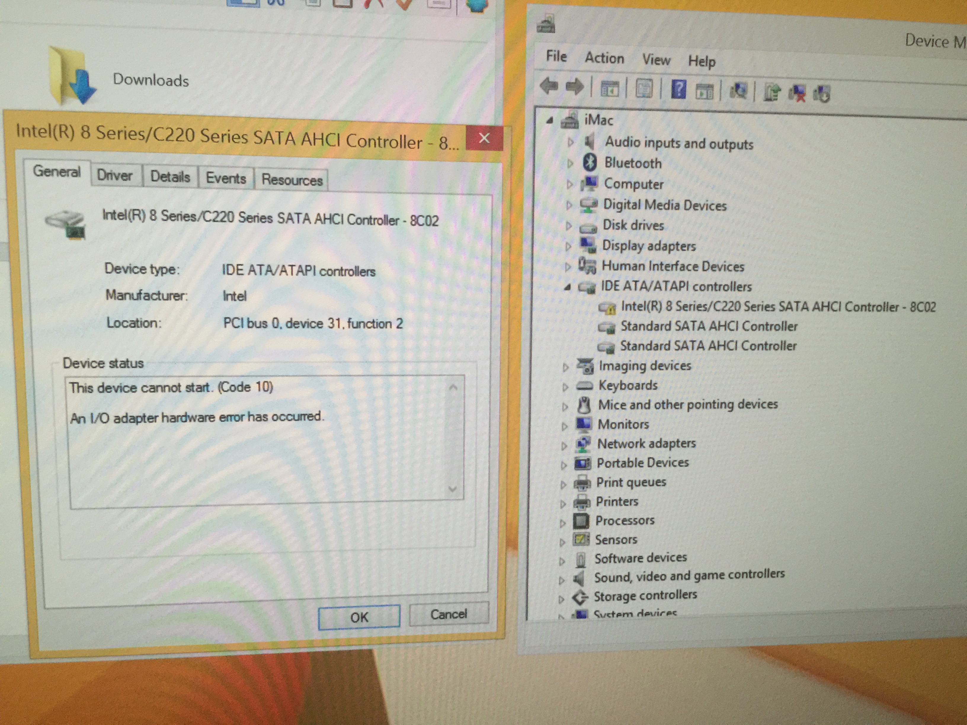

    So, I did that and it works to boot to Windows! But.... then I end up with the 3TB Disk not visible in Windows at all, showing an AHCI/SATA driver error which is NOT resolvable through re-installation. You can see the driver error in the picture below, too.

    HOWEVER, I then rebooted to OS X. And then, without touching anything, rebooted back to Windows. The 3TB disk is now missing, and the "driver" issue is back in Device Manager. I can repeat this procedure over and over, but the 3TB disk always goes missing after a reboot to OS X and then back to Windows.
    So I'm at a complete loss. :(

    Have you tried the following:
    1. Split the Fusion Drive
    2. Format the SSD to just have Free Space in Disk Utility (try using the MBR partition scheme and not GUID). Install Windows, let it do its stuff.
    3. Format the Hard Drive (GUID partition table; one HFS+ [Mac OS Extended Journaled] partition) Install OS X on the hard drive.
    4. Install Windows on the hard drive (alongside OS X a la a traditional Boot Camp setup).

    I haven't tried the Free Space thing in Disk Utility.
    FYI, I just tried the following:
    1.) Split the Fusion Drive.
    2.) Install Yosemite fresh on the 120GB SSD.
    3.) Ran Boot Camp Assistant to create a Boot Camp partition on the 120GB SSD with Yosemite on it.
    4.) Windows still failed to install on the 120GB SSD with the same error as my first post....

    I formatted the 120GB SSD (after un-fusing, of course) as MBR rather than GPT, and did the FREE SPACE option. I was then able to install Windows 8.1 with no trouble, and my 3TB disk shows up after many reboots between OS X and Windows.
    HOWEVER, I now have a "System Reserved" partition on my OS X desktop, which is about 350MB big - part of the 120GB SSD. If I can figure out a way to not have that separate partition, I'll be set! Any ideas?

    This is the way to install Windows 8 just on the SSD on a 3TB fusion 5K iMac:
    1.) Un-fuse the 3.1TB partition, following the simple instructions here:
    http://www.macworld.com/article/2015664/how-to-split-up-a-fusion-drive.html
    2.) Format the 120GB as an MS-DOS partition - making SURE to pick MBR as your partition type.
    3.) Reboot to the Windows installer and be SURE to pick the "Windows" install - NOT the EFI install.
    4.) Install Windows. Be happy.
    Again, this is only for those of us who have our OS X installation on an external disk already.
    FYI, Yebubbleman, if you do the Erase Free Space you end up with that extra System Reserved partition. Just doing MBR without erasing free space solves that. :)
