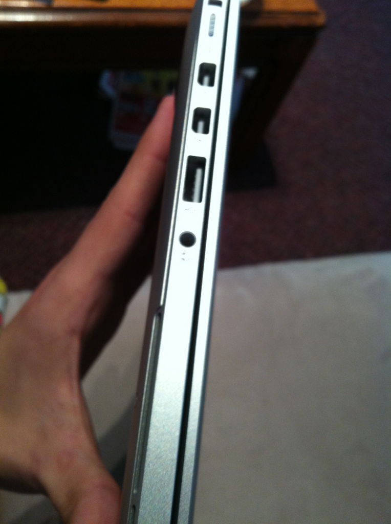

    I just got my new rMBP a few days ago in the mail and everything is perfect. I was one of the lucky ones to get a Samsung screen with no visible retention so far (besides a black screen on start up, I think the issue is the graphics switching). The only problem I have is that the bottom plate is not perfectly flushed around the vents like the rest of the plate is with the unibody. There's barely any creaking but I paid nearly 3 grand for this computer so I expect no mistakes; I know I sound like Hitler or something, but really.
    I really don't want to have to replace the entire computer because of the bottom plate not being flush with the vents (only like a millimeter out on both sides, especially the thunderbolt port side). Can they fix this issue just by reseating the bottom plate via unscrewing/retightening the screws? Or if it's not to spec, can't I just get a new bottom plate instead of replacing the machine? I was lucky enough to get a Sammy and I don't want to loose it — I just want a perfect machine. :(

    Can you take a pic so we can see what you're talking about and how severe it is?

    You can see in the corners that it's flush and in the middle it's not. I know it's not that severe; I just never experienced this from an Apple product. Kind of disappointed.

    I had a similar issue. I took it to the AS and had them tighten the screws. One side was OK after the tightening while the other didn't improve. I read a post here where someone installed a screw set for a MBA which has a shorter shoulder on the screws. I went ahead and found a set on ebay and installed them. Now my bottom plate is nice and tight.
    So basically, what I found is the original screws bottom out when fully tightened. The shoulder of the screw or the plate thickness is not correct so the panel floats a little between the bottom of the machine and the screw head. The MBA screws have a shorter shoulder so when they are tightened they hold the bottom plate firmly against the bottom of the machine.
    The picture below is obviously not one of the screws that hold the bottom plate, but it's easier for you to see. The shoulder that I am referring to is the area between the bottom of the head and the threads. The shoulder length on my original screws was greater than the MBA screws.

    Well I brought in my rmbp into the AS and they tried reseating it, it's a bit better still not entirely flush around the vents though. The genius who worked on mine stripped a bit of the screw too, pretty pointless for going.
    I guess I will just have to buy some MBA screws off the net and a driver when I can to fix this. I am not going through a replacement.
