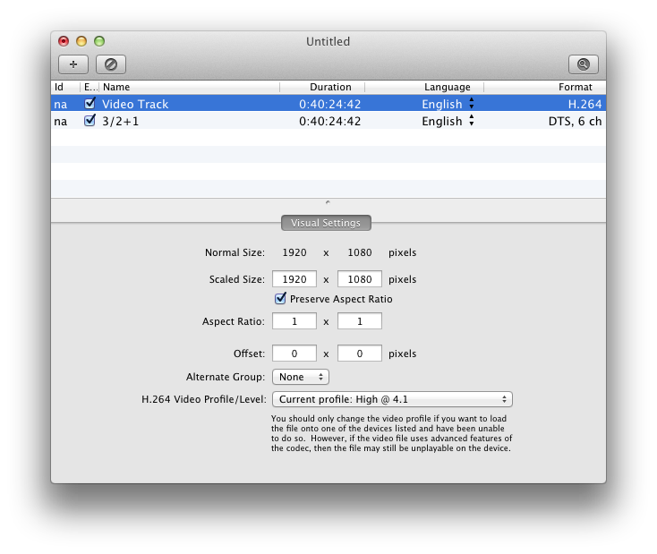

This is a snapshot of my settings in Subler. I haven't an option to select stereo or 5.1.
I just tried to take a MP4Tools created file and "optimize" it using Subler but it did not work. I wish MP4Tools would work, considering I paid $5 for it and it works with audio so well.
Any other ideas?
Any other ideas?
MP4Tools works fine, you must be using it wrong if you are having problems.
See the screengrab of MP4Tools I provided further up the thread - that is how you remux the MKV file to M4V with 5.1 and stereo audio tracks.

Subler will convert AC3 to AAC if you tell it to when adding tracks. Open the MKV file in subler and you can select which tracks to add to a new container. To get a second AAC track, re-add the MKV but only add the audio portion (deslecting the other tracks) and choose AAC instead of pass-thru.
From there you can add meta tags etc
Then just save the new file and it will create a proper m4v or queue it to do multiple at once. Subler will not convert the video track so it needs to be a h264/x264 track nor does it do DTS to AC3 (but I think it might do DTS to AAC).

3) add only the 2 audio tracks (AC3 5.1 and AAC stereo) from the mp4
4) save
