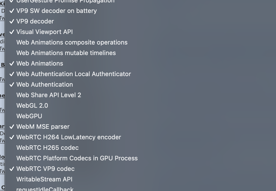

Just saw this in another thread. Apparently, this will help with YouTube. I haven't upgraded my iMac to Big Sur yet, so I can't test it. But it reportedly worked for someone. But for Netflix, I don't know.
Try - Developer menu - Experimental features - WP9 SW decoder on battery (on) - Web RTC WP9 codec (on).

Thanks. This worked for YouTube. Still not working for Netflix, though.

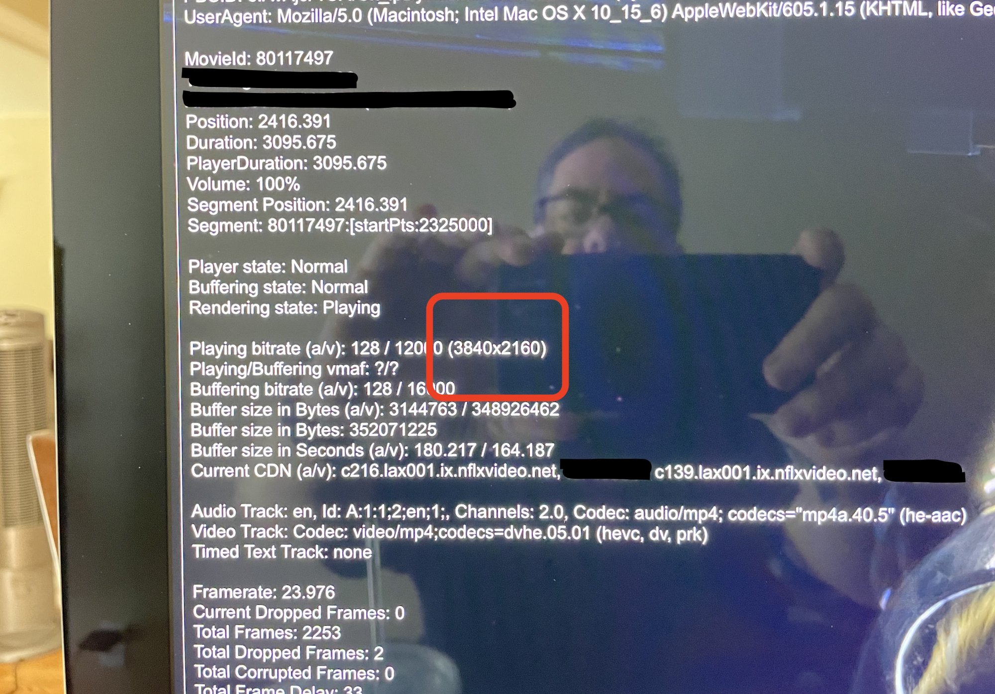

My Netflix its working. It just takes 30-60 secs for it to ramp up to that. It starts at 720, then goes up from there. This is a crummy photo of me playing Lost in Space in 4K. Didn't know what info is sensitive, so I redacted a little bit. Overly cautious, I guess. Anyway....

may I ask what is you Safari > Develop > Experimental Feature setting please?
There's a long list. I don't know what to give you. Sorry, this is the first time I've played around with this. I just followed what they said about "W9", but mine don't say W, they say "V". So I did that. I think that's just for YouTube though.
Are you subscribed to Netflix's top tier? Do you have a T2 in your Mac? I know those are requisites. Also, remember to let it play for a while. It really needs time to ramp up to that bitrate, depending on your internet speed.
My Netflix its working. It just takes 30-60 secs for it to ramp up to that. It starts at 720, then goes up from there. This is a crummy photo of me playing Lost in Space in 4K. Didn't know what info is sensitive, so I redacted a little bit. Overly cautious, I guess. Anyway....View attachment 1666837
Thank you. I can confirm that on my iMac it will ramp up to 4K after about 60-63 seconds.

I enabled WebRTC H265 codec as well.

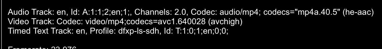

@Canaan_c Same issue here. I have a Macbook Pro 2019 with T2 chip which can play 4k youtube videos, but Netflix still 1080p.
I found a different between I an @decypher44 is the codec. I am still using avchigh codec instead of hevc. That's why we can't stream 4k Netflix, but I still can't explain why.

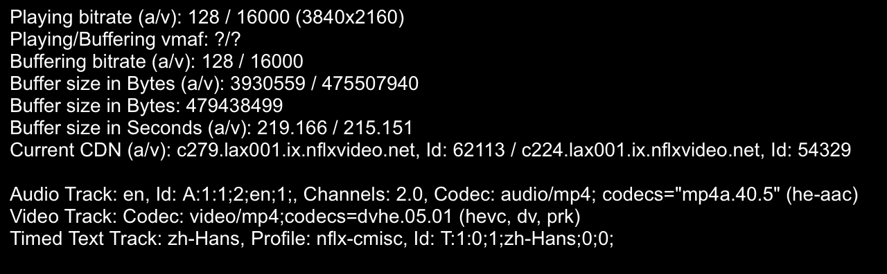

And now I got 4K netflix work by change user agent to: Mozilla/5.0 (Macintosh; Intel Mac OS X 11_0) AppleWebKit/605.1.15 (KHTML, like Gecko) Version/14.0.1 Safari/605.1.15
Which "Intel Mac OS X 11_0" in final version is "Intel Mac OS X 10_15_6".
Which "Intel Mac OS X 11_0" in final version is "Intel Mac OS X 10_15_6".View attachment 1667304
I changed to "Mozilla/5.0 (Macintosh; Intel Mac OS X 11_0) AppleWebKit/605.1.15 (KHTML, like Gecko) Version/14.0.1 Safari/605.1.15"
the buffering bitrate still limited at 5800... no luck
