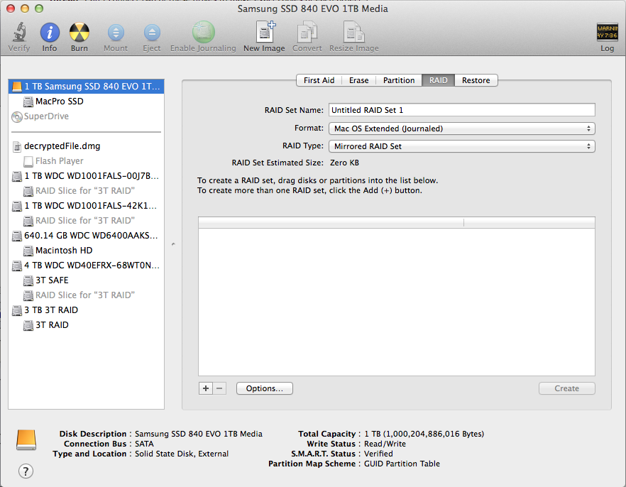

    Assuming you connect both HDD to your Mac. The "Mirrored RAID Set" in "disk utility" should do everything automatically for you..
    In case one of your HDD is broken. The remaining one should contain all the data and can work with your Mac as a normal single HDD.

    But that's not what he looking for. He want 2 HDDs make exact copy of each other. That's exactly what RAID 1 does. All change you've made will write into both HDD at the same time. And either HDD is the backup of the others in real time.
    However, If you delete any files, those file will be remove from BOTH HDD as well. Therefore, RAID 1 only protect you from HDD failure. And it's still a good idea to use time machine to protect the user from human error.
    I'd simulate his case by using 1 USB stick + 1 SD card. I RAID them together. It works exactly as I expected. No matter which device I eject, the remaining one still works with all data on it. No recover required. So, no need to wait for the files to recover (like time machine).

    Fully understood. My LaCie 2Big 6TB is running in RAID 1 for 3TB mirrored. RAID 1 is not for backup. It gives you a higher availability in case one drive dies.
    If OP wants to run two identical drives as a RAID 1 volume, no problem. Just don't forget that high availability is NOT the same as backup.
