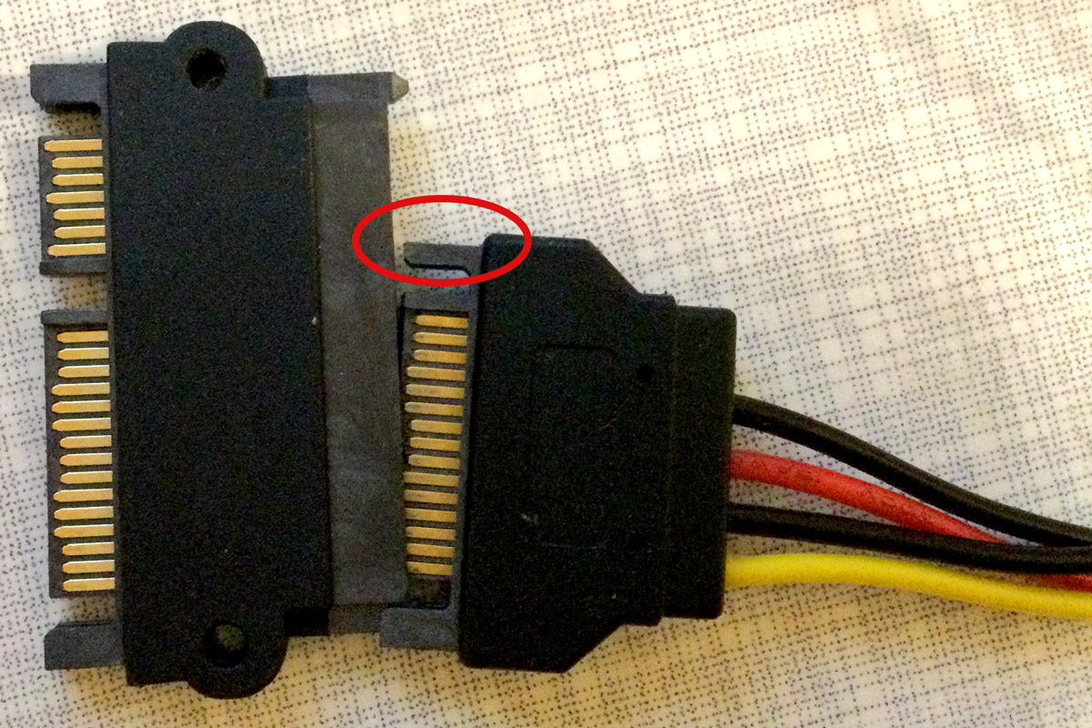

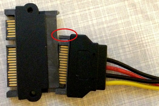

Is there a specific SATA to MOLEX connector that you guys could recommend, so that I could run the connector from one of my HDD bays? I purchased this guy, and it didn't want to stay connected to the SATA connector:
Your cable looks good.
Have you removed/clipped the nose on one side of the plug - otherwise you can't connect it properly.

I did. But, when I connected it to the HDD SATA port with the Mac Pro on its side, then righted it and booted it, the cable fell out of connection and hit the GPU fan. So, there's nothing better? I suppose I could secure it with the tiniest bit of electrical tape . . .

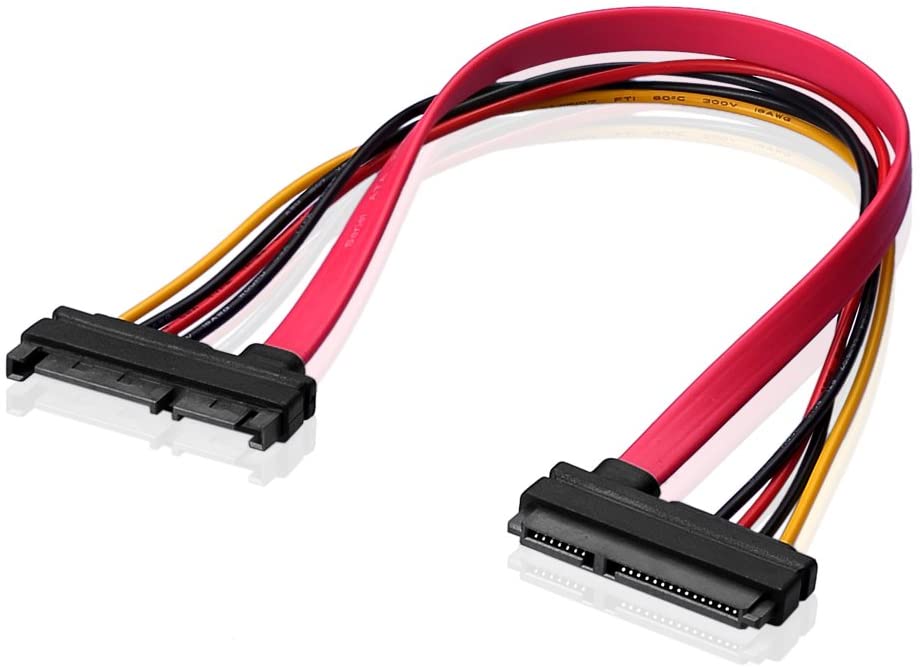

Is the other part in that image, with the SATA data and power inputs, something I could purchase on Amazon.com? If my cable connects that part, then it might make the connection more secure without using electrical tape.
Yes, it's called sth like "SATA 22Pin 7+15 Male SATA 22P 7+15 Female extension convertor Straight adapter".
But I would rather buy a flexible SATA extension cable and then connect your power cable to it.
This way you reduce the strain/lever on the Mac Pro's SATA connector and you can bond/secure both cables together how you please.
