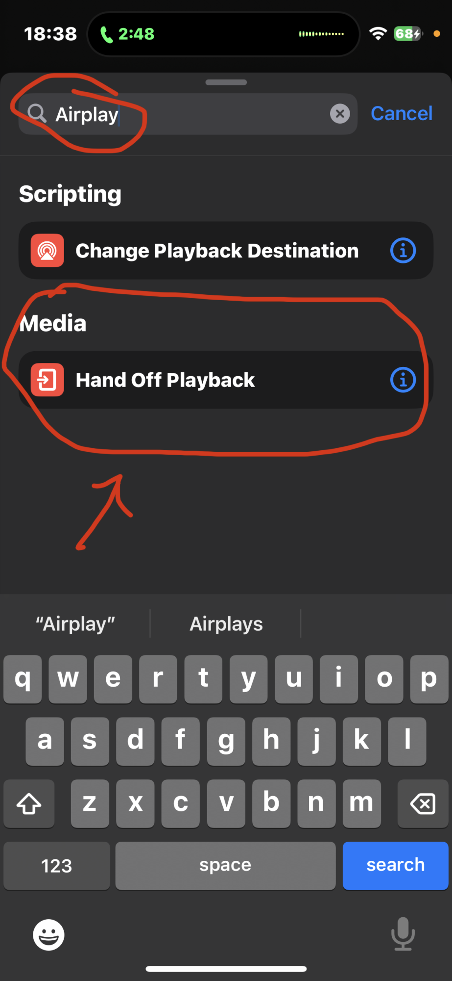

You have to accomplish this using AirPlay from your phone to the HomePods. I was doing this with a dumb amp powering dumbs speakers by my pool, that was connected to an AppleTV. The amp was plugged in with a smart plug.
I had a shortcut that: turned on the smart plug (which turned on the amp). The AppleTV would wake up. Started a playlist on my iPhone, passed the audio to the AppleTV using AirPlay and started playing. The now playing app on the AppleWatch would automatically open and I was able to do everything from the Apple Watch while I was in the pool. The shortcut was on my watch or can start it using Siri.
I’ve since deleted that shortcut since I removed the equipment by my pool for a renovation but I’ll go back and see how to do it again and report back.
So just checked the Shortcuts app. This is the function you have to use. Move from iPhone to the HomePod(s) of your choice. You can also select to “Show on Apple Watch” so you can run it from the Watch.

So I just spent half an hour doing testing, here's what I can do:
Launch Shortcut from Apple Watch, it works, my two Homepods and one Apple TV all start playing the playlist. But I have no control from the Apple Watch. Can't skip songs. Can't change volume. Can't select another playlist.
Launch Shortcut from iPhone, it works of course, my two Homepods and one Apple TV all start playing the playlist. But I have no control from the Apple Watch. Can't skip songs. Can't change volume. Can't select another playlist. When I tap the "on Phone" option from the AW the AW shows me what's playing but doesn't allow me to pause, skip, control volume, nothing.
Launch Playlist from Apple Watch then choose Airplay, then wait for it to not connect to Airpods, then give me an error message, then eventually show the two Homepods and one Apple TV, then tap each individually, now I have full control on my Apple Watch, can pause, skip, change volume, change playlists, etc.
So unless I'm missing something or haven't set up my Scene or Shortcut properly, the only way I can lie in the pool and launch my backyard Homepod and Apple TV audio from Apple Music is to tap the watch like a madman for five minutes until, finally, the music starts playing on my watch and then I can Airplay it to each device. Any ideas?
EDIT: When it comes to the 'Hand off Playback" perhaps I'm doing something wrong. In the "from" I can choose iPhone, but in the "to" it only allows me to choose 1 of my 3 speakers, either 1 Homepod or the 1 Apple TV, but not all 3 playback devices simultaneously.
