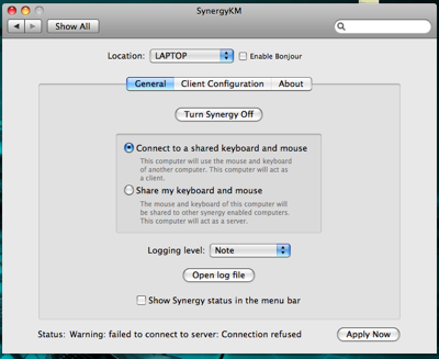

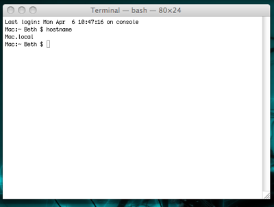

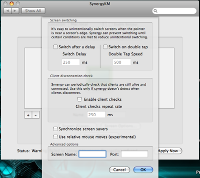

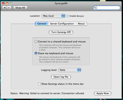

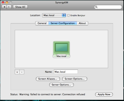

    Ok, I did a few screen shots, cause I don't know much about networking or hardware. Here's the setup on my Mac. I'm going to retrieve the dell from my son and let you know what's happening there.
    Edit:
    Ok, I have the MBP set up as the server, and the laptop as the client. You see here the screen shots with the connection refused message in the second one. The error I'm getting on the laptop side is: "WARNING: failed to connect to server: address not found for: Mac"

    My first impression is that you have found two problems:
    1) the server (MBP) is blocking this kind of traffic - this needs to be corrected in the Firewall settings. That is under system Preferences|Sharing|....
    2) I'm not sure if your Dell is "seeing" the Mac on its network neighbourhood. An exception to Windows firewall must be added manually.
