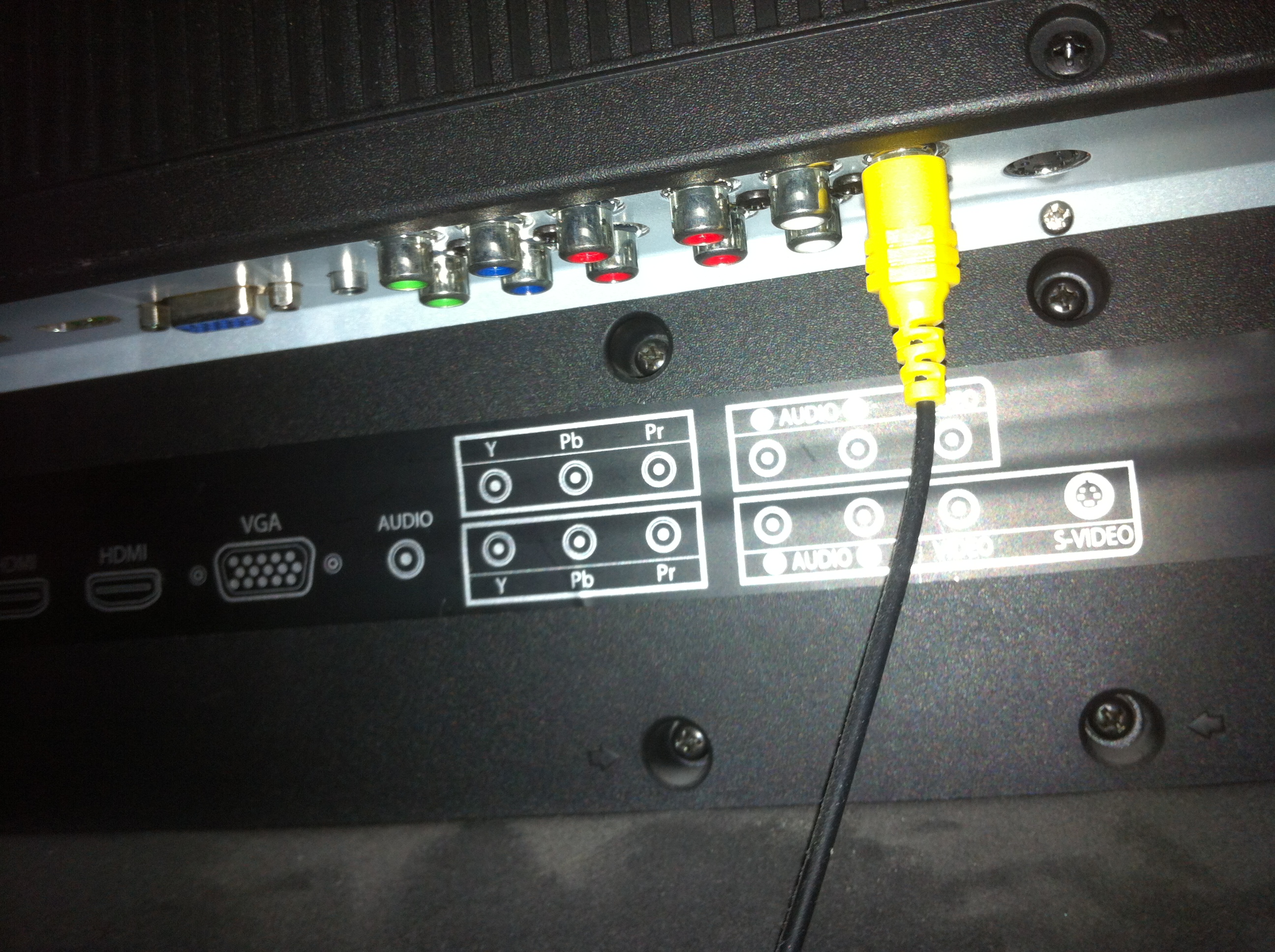

    Yes thank you I'm planning on using a 3.5 mm to 3 RCA AV Audio cable into my Sabre TV model LCT47PBKA. But I cannot find the option to use the audio from this cable on the TV.
    I've attached a picture of the back of the TV. I need help with after I've plugged it in.

    In your picture, you have a video cable attached. That one should not be plugged in, just leave it loose (it's not used), and just plug in the red and white (right and left, respectively) for the audio.
    You would get the audio when you play the video on your MacBook. You may need to select whatever input uses those ports on your TV, or maybe the audio will simply work when you get the video to appear on your TV.
    Just to make sure that you understand - you need the Mini-DVI to VGA for your video, and the 3.5mm connected to headphone jack, and then red & white on the multi-RCA to left and right on your TV - you need BOTH cables to get this to work.

    Taking a second look, you have one:
    [​IMG]
    Mini DVI to VGA should do the trick. Though you might not get full 1080p out of it. Not saying you won't but sometimes VGA doesn't like HDTV's. Sometimes it does. Depends on the TV, Laptop/video card, and adapter.

    I missed the audio connector next to the VGA port.
    I bet that will work.
    OP, you need a 3.5mm to 3.5mm stereo cable. I am pretty sure that will work.
