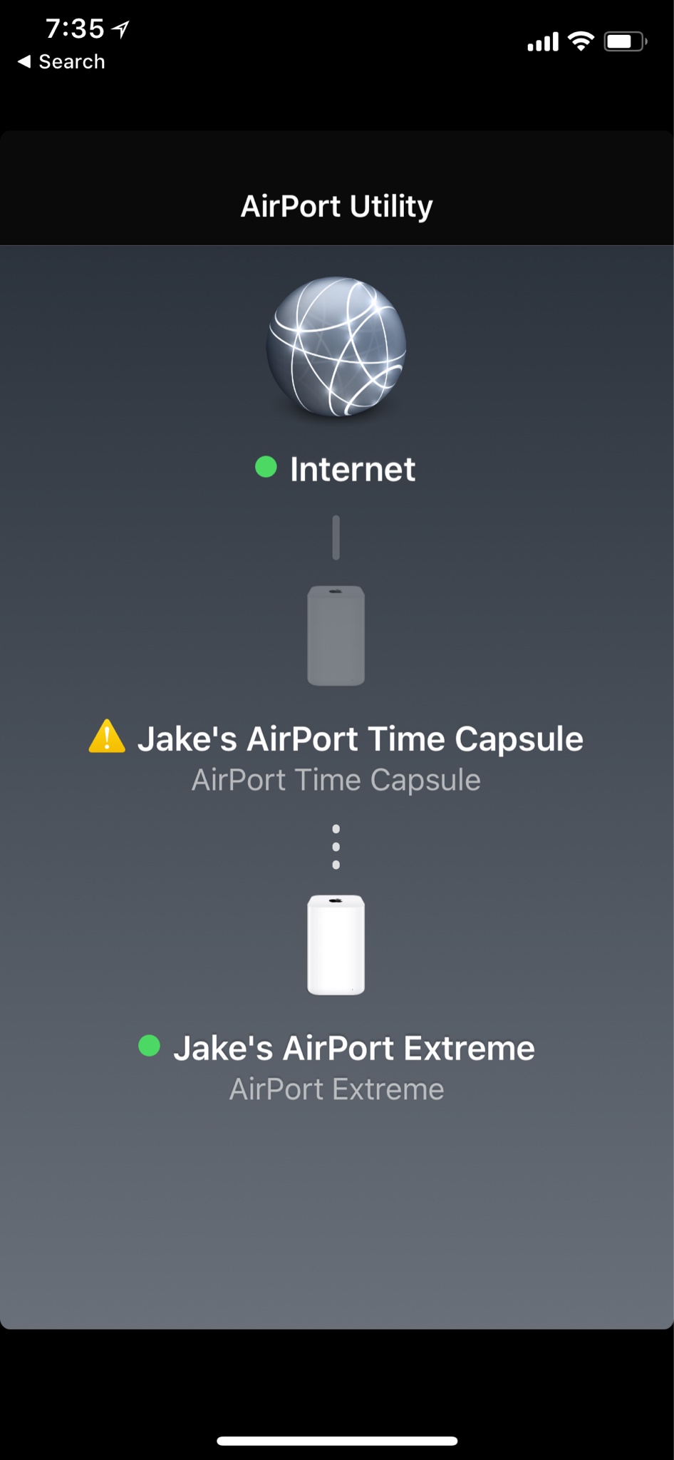

The internet has been really slow lately, so I opened up utility and took this photo...
So, from this diagram it is saying that the TC, that is connected directly to the modem, doesn’t have signal...but somehow the signal is being sent wirelessly to the AirPort Extreme...??
Not sure how this can even happen, the modem they installed is not wireless...so why is the TC showing no signal, while simultaneously sending a wireless signal to the Extreme??
Thanks in advance. Please keep answers basic, as I am pretty dumb with this stuff.
The Extreme is connecting to the TC wirelessly (dotted lines). This will slow things down considerably, airports share radios for client and uplink so your bandwidth will effectively be 50% of what it could be. If there is a way to run ethernet, or powerine adapters to link the two, it will be much faster.

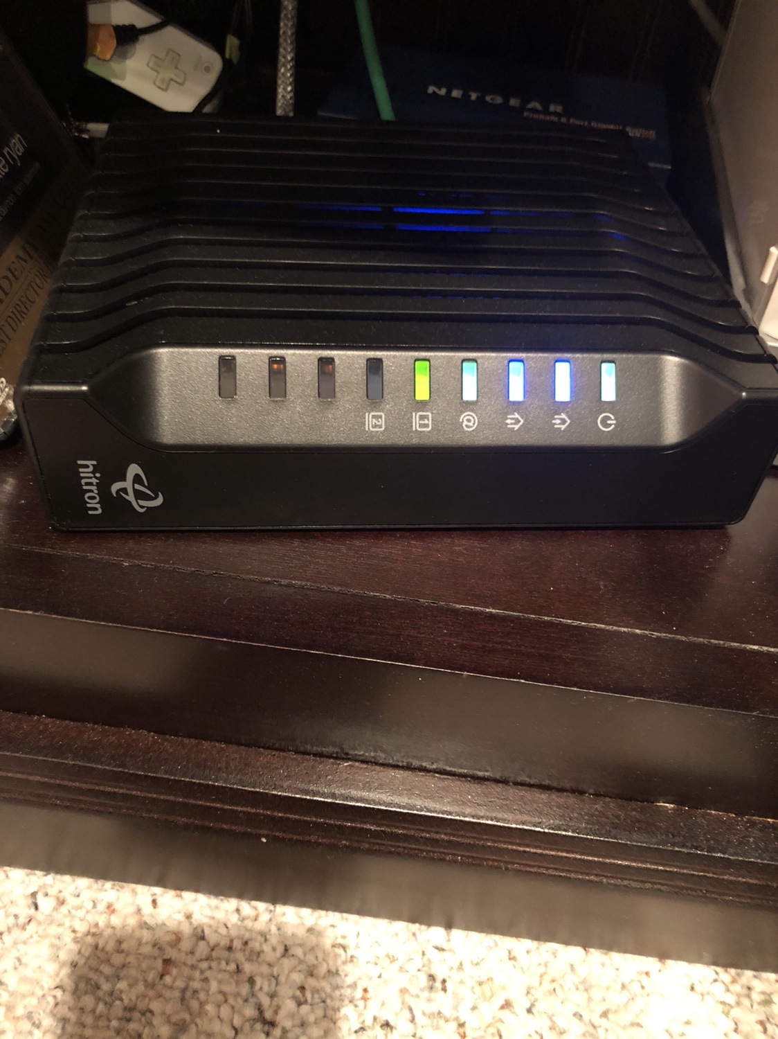

Thanks for the info, here is a pic of the modem...guessing it is also a router? As it does appear that the TC is constantly resetting. At times I can get it to show a green signal next to the TC on the utility, but then it goes off-line again.

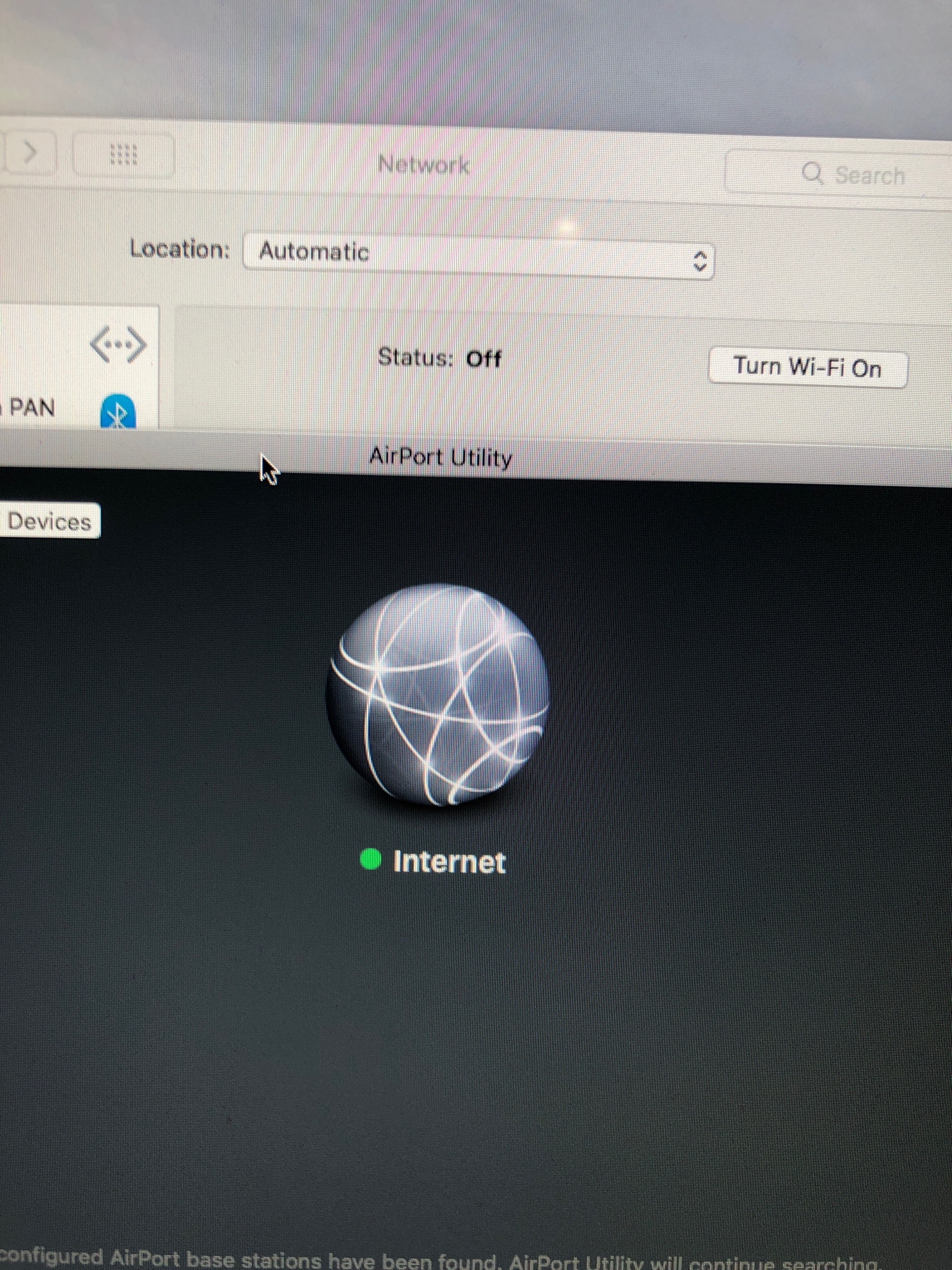

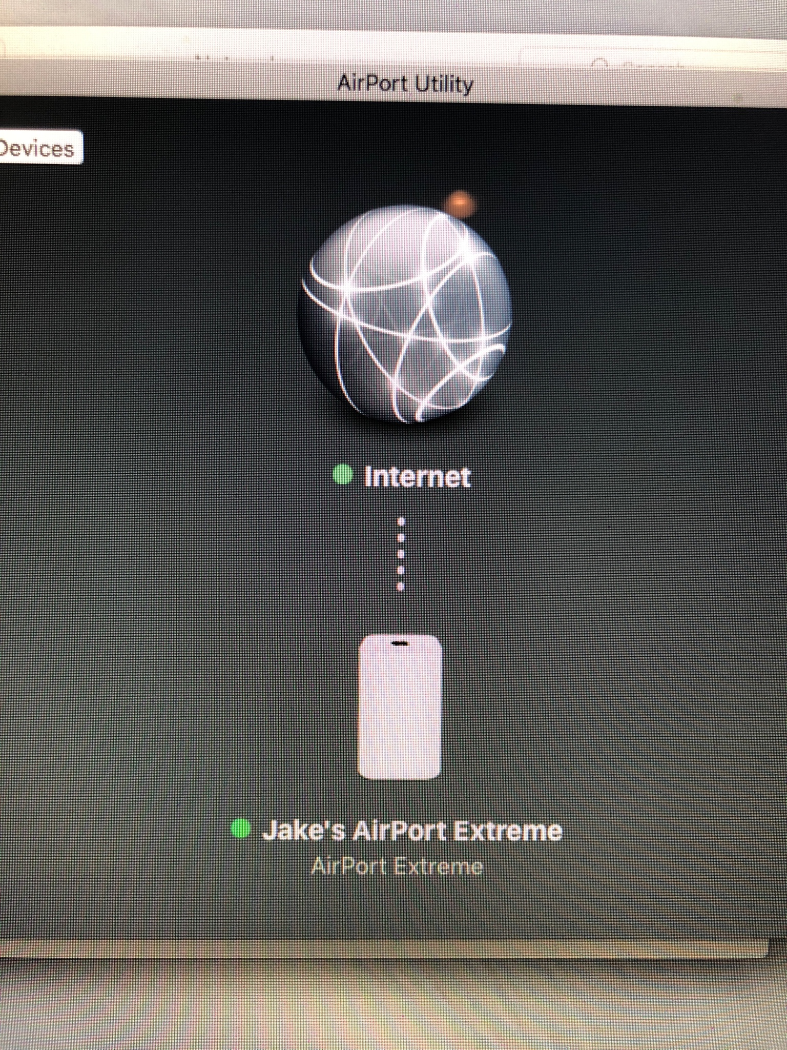

Ok, just plugged the Mac directly into the TC, the only connection that the Mac is showing is a wireless connection to the extreme...(the TC doesn’t even show up)
When I turn off wireless connection on the Mac, it doesn’t show the either the TC or the extreme, but still shows that it is connected to the internet and the internet works...

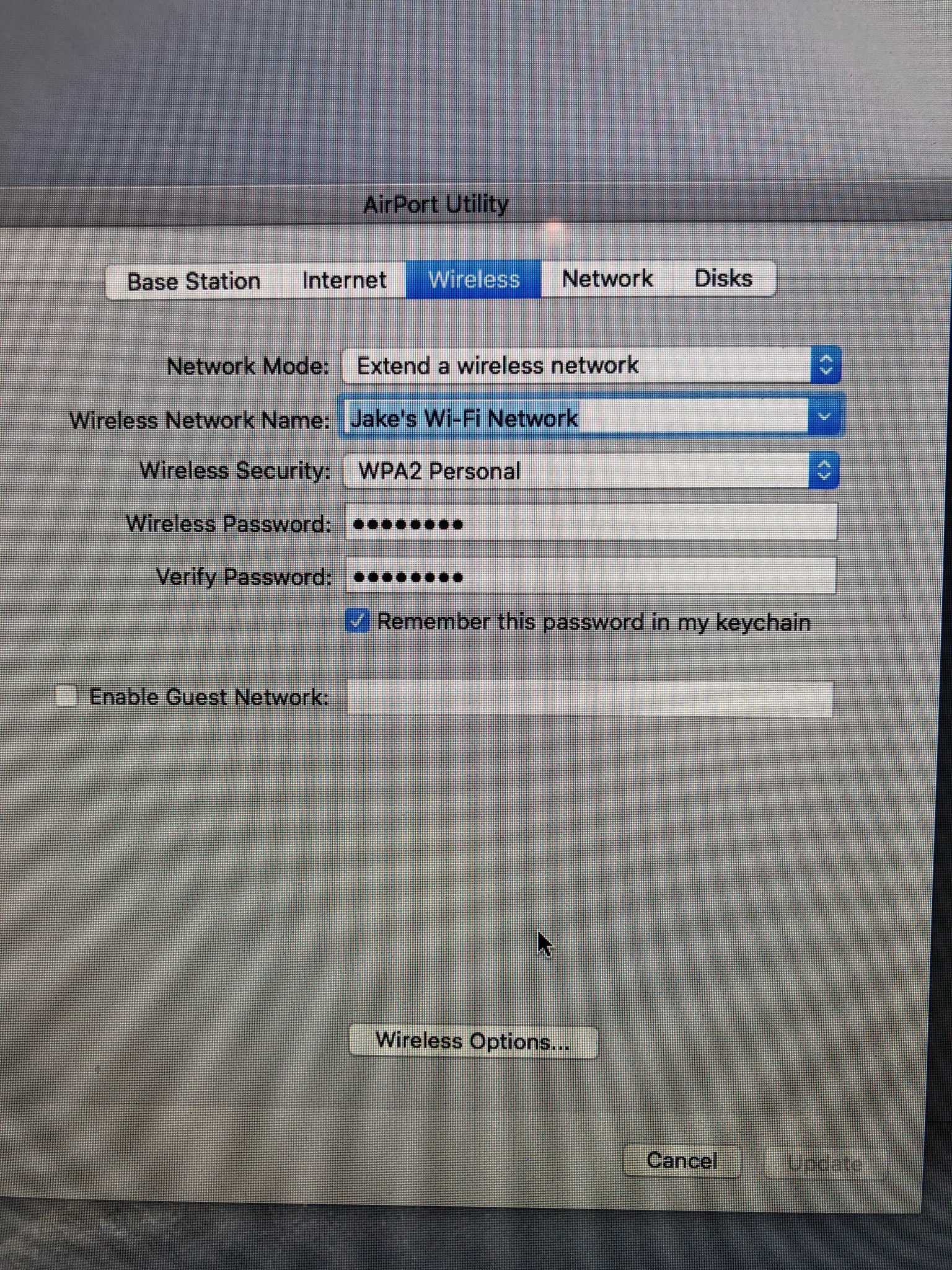

When connected to Wi-Fi and I click on the extreme advanced options it says that it is in “extend a wireless network” mode.

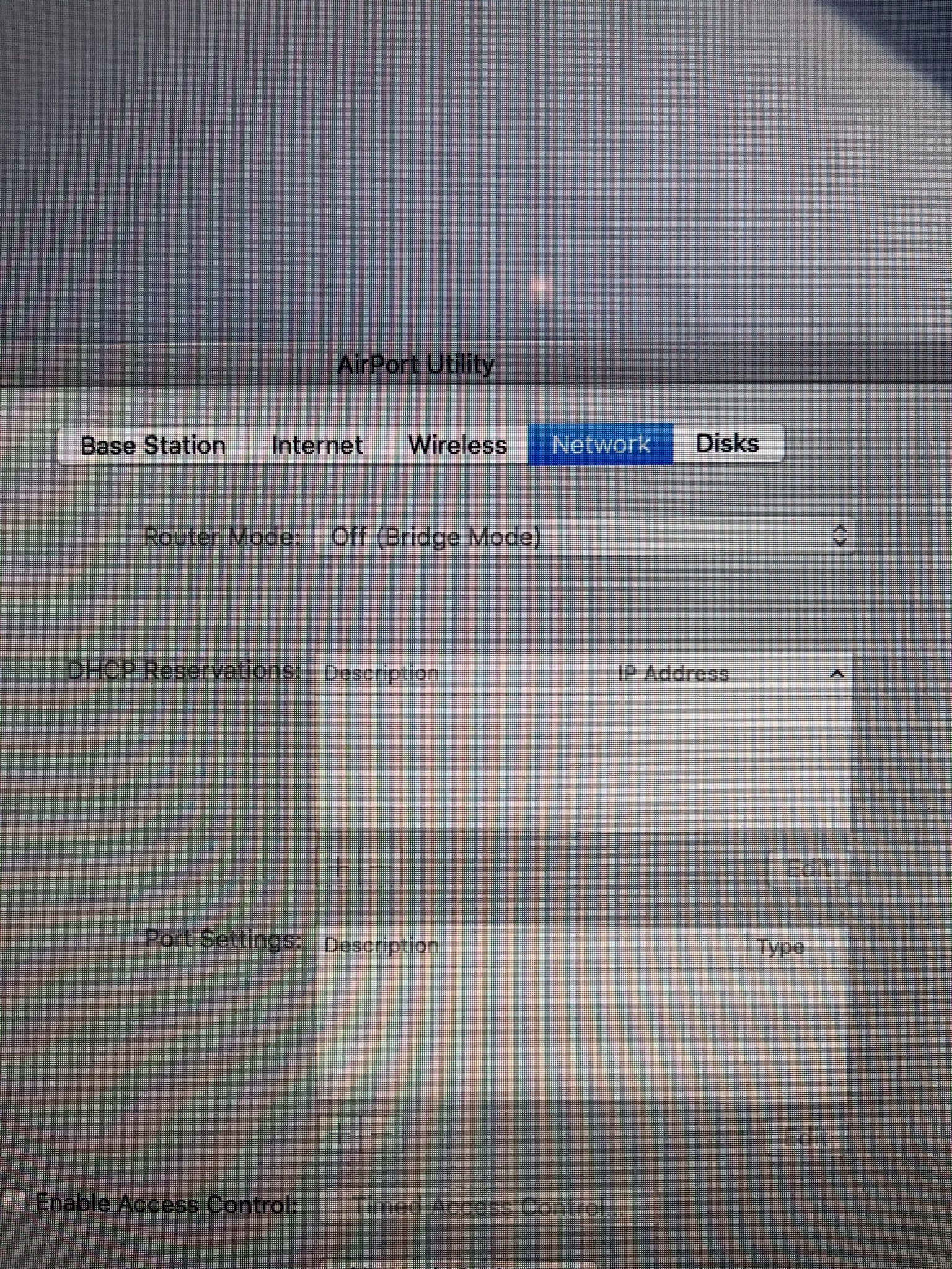

And under network it says, “Router Mode: Off (Bridge Mode).
Regardless of what I do, I can’t seem to find the TC anywhere...?

OK, so the modem appears to be a router. So, setup both the TC and Extreme to Bridge Mode. On the TC, setup the WiFi as create a network. Leave Extreme to Extend.
Make sure TC is connected WAN port to a modem LAN port.
Now, if that mostly solves your issues, consider connecting the Extreme to the TC via Ethernet. If direct ethernet is not feasible, consider MOCA or Powerline adapters which with reasonably current models will approach the 1Gbps ethernet capabilities of the Airports and will relieve the radios of the split WiFi tasks which tend to cut WiFi bandwidth by roughly 50%.
Also, if the Hitron router has WiFi, see about turning it off. Too many WiFi access points tend to stomp on each other. To login to the Hitron, check your network settings, they should show a Default Gateway which would be the router. then, go to that address in a browser and login (should be either blank or "-" for both, or cusadmin\password on newer models unless you changed it).
Not sure of the model of that modem, but it may not be up to the task of a 1Gbps connection. Check the specs or provide a model number and the community can help you determine if it is adequate.
