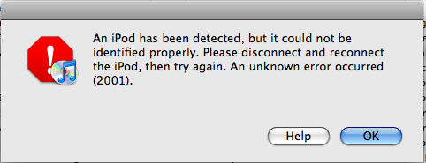

Does anyone get this dialog box when they enter DFU mode?
I connected my phone to my Apple USB keyboard and still iTunes doesn't seem to recognise the phone...it thinks its an iPod
I don't think the Apple USB keyboard is going to give you enough power. You should connect it to a powered HUB or perform the mod I posted from someone else in another thread.
I'd follow it but i dont have another macbook to get the files from. Sigh...looks like a reinstall for me then
