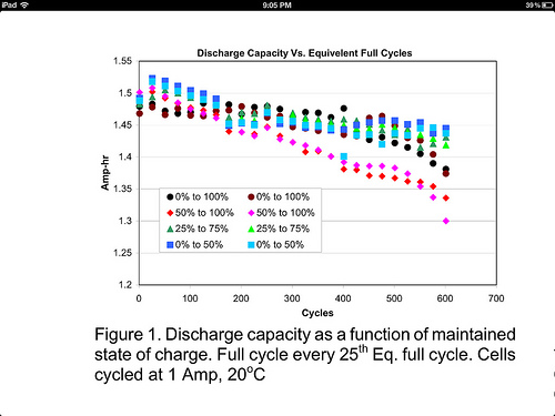

    I'll admit to being a bit anal about Li-ion battery care, especially with non removable batts. Here's a few things I do - I also use it ~ 40% per day.
    - charge daily, as mentioned shallower charges are better
    - avoid charging to 100%
    - minimize average voltage, but also leave yourself enough emergency capacity. So I charge ~ 80-40-80 or 70-30-70
    - to satisfy the last two points, I charge in the morning so the batt sits at a low voltage while idle overnight, and for convenience use a light timer to charge say 6 to 7 am, just before I wake up.
    - I also charge bareback on marble to minimize temps, just out of habit, but probably unnecessary - these devices stay pretty cool while charging.
    Here's some data to back it up... The chart is a military study on capacity loss from different Li-ion charging habits - it supports the Batt Univ points.
    http://batteryuniversity.com/learn/article/how_to_prolong_lithium_based_batteries
    [​IMG]
    I realize most people don't care and won't bother, but once your set up, there really is no extra work involved, except 5 secs to adjusting the light timer. It's worth it to me. YMMV

  19. reppans macrumors member
    Joined:
    Dec 2, 2006
    #19
    Guilty as charged... I'm a flashlight hobbyist and good ones use Li-ion batts. You really have to understand Li-ions for that since the batts can turn the airtight tubes into pipe bombs.
    Yeah, no problem topping up to 100%, it's what every manufacturer expects and plans for... the only question is whether you'd like your battery to last longer than average/expected. The military study chart shows a significant difference in capacity loss between 100-50-100 charging and 75-25-75 charging.... for me, that's worth 5 secs of setting a light timer at night.

  21. reppans macrumors member
    Joined:
    Dec 2, 2006
    #21
    I agree, I probably wouldn't bother going doing an extra charge in the middle of the day just to be kind to the battery. I just suggest the timer routine and being kind to te batt. for people like the OP and I that use around 40-50% per day.
