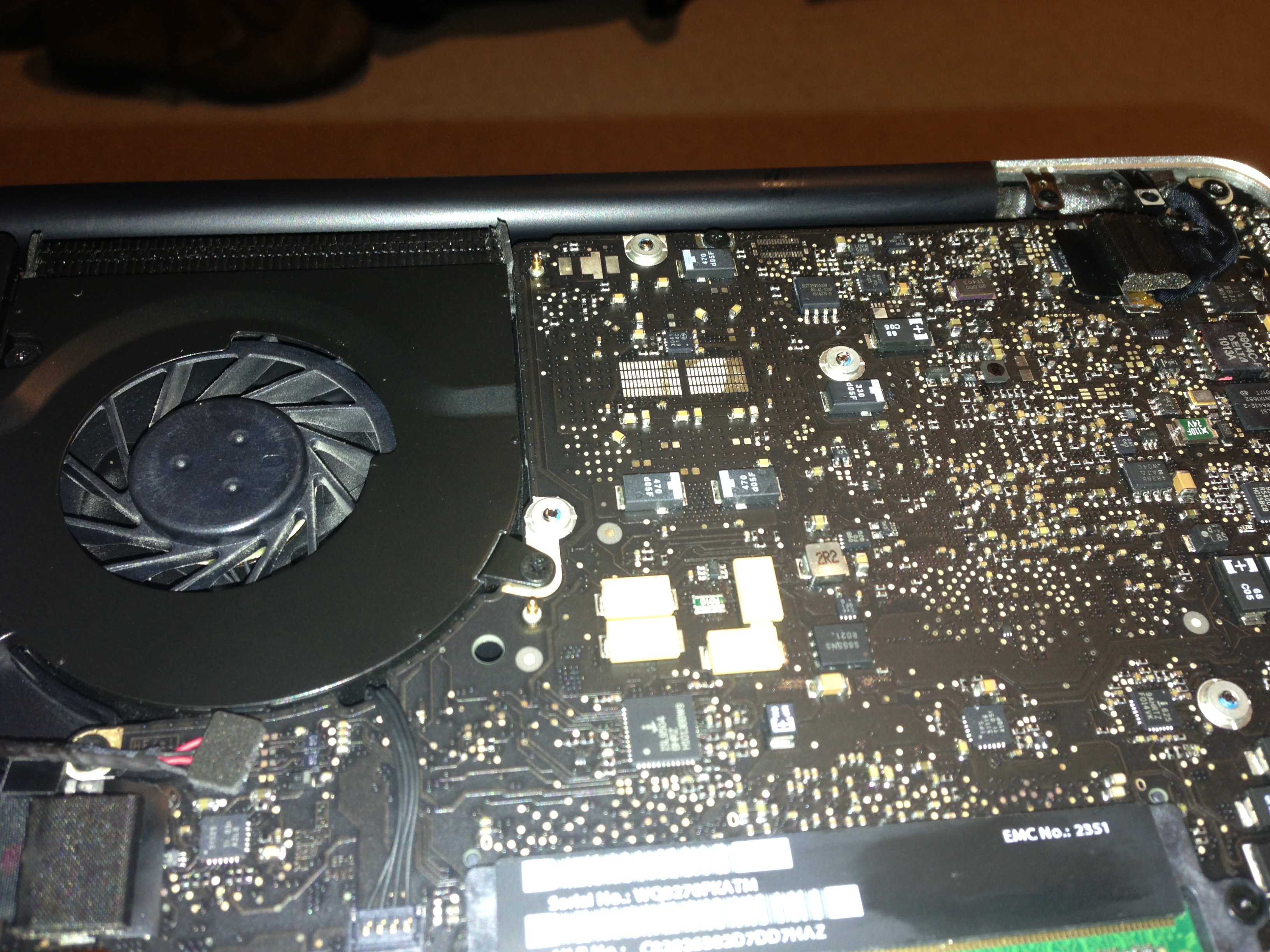

    Yea I've already cleaned the mobo area accessible from the bottom plate.
    I have NOT cleaned the part of the mobo under the keyboard.
    I guess I will wait for the tools to arrive and take the mobo out completely and clean it.
    I saw some residue on the dc board/MagSafe area. I've cleaned that with qtip/isopropylalco.
    Pic showing residue in upper right corner before cleaning.

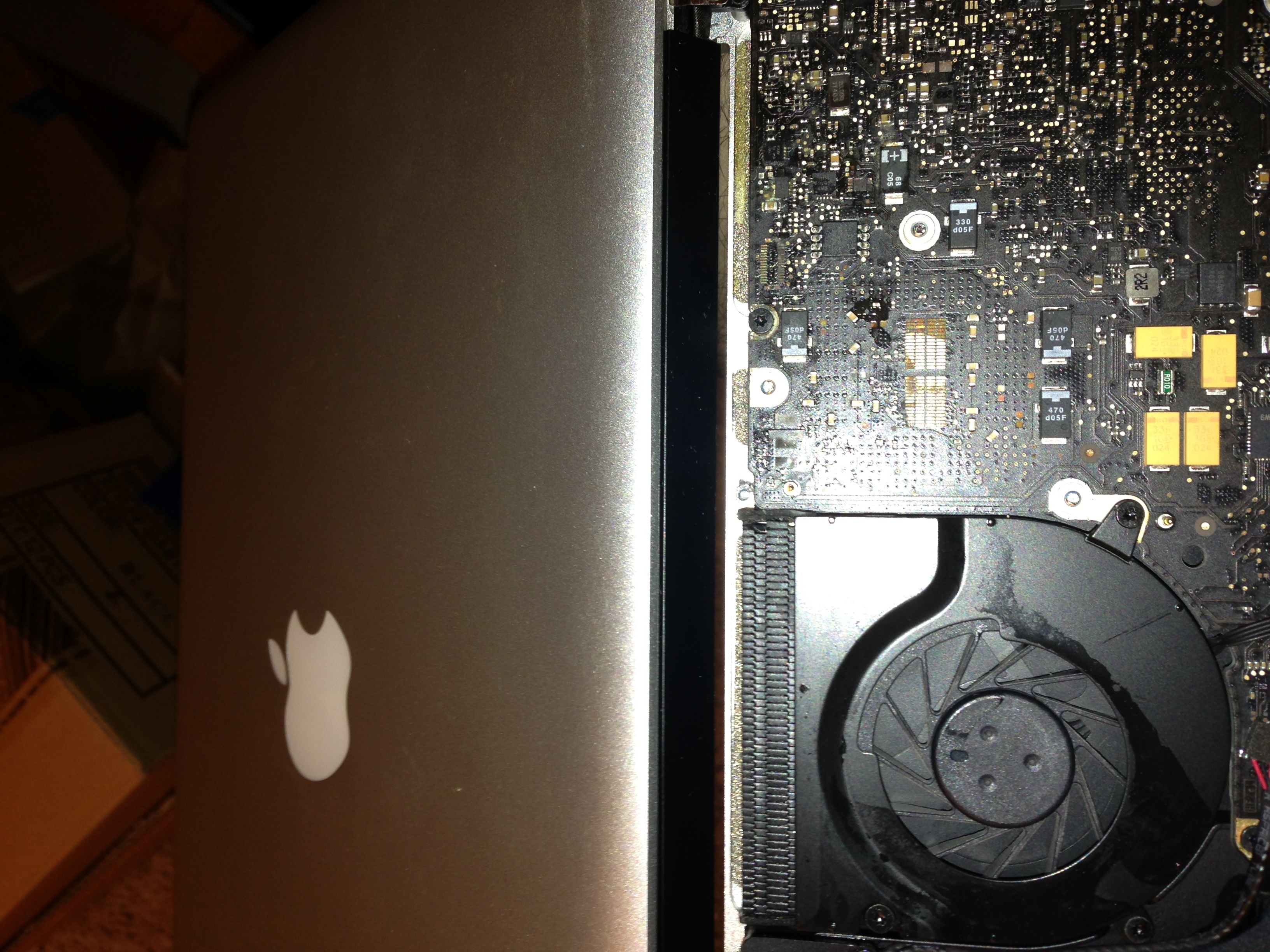

  8. blitzftw thread starter macrumors newbie
    Joined:
    Mar 4, 2013
    #8
    Pic after cleaning.
    It's been about 24 hrs since it has happened.

    So I was able to follow the iFixit teardown guide and removed the logic board. There was no residue on the mobo side under the keyboard. I also went ahead and removed the keys and there were no cofee stains.
    It seems the cofee only got in through the vents and went directly underneath the mobo and sat on the bottom plate and near the dc board.
    So after cleaning the dc board and some other residue in the edge areas with isopropyl aclohol, I let it dry since last night.
    It turned on sucessfully this evening. I was able to back up the files that I needed.
    There were some issues with the keybaord at first, but was fine after a while.
    However, after shutting the system down again(maybe after 20 mins of use) ,it no longer powers up.
    Any ideas? Could it be the dc board?
    Edit: Forgot to mention that indicator light comes on for battery status and battery is change when magsafe is plugged in. Does the DC board have a seperate mechanism for powering on? Or is the power button faulty?
    I hope I didn't turn it on too early....I did NOT use any water, just isopropyl alochol. The residue was on only on DC board and a few edge spots. Dried with absorbent paper towels, rice and air dry.
