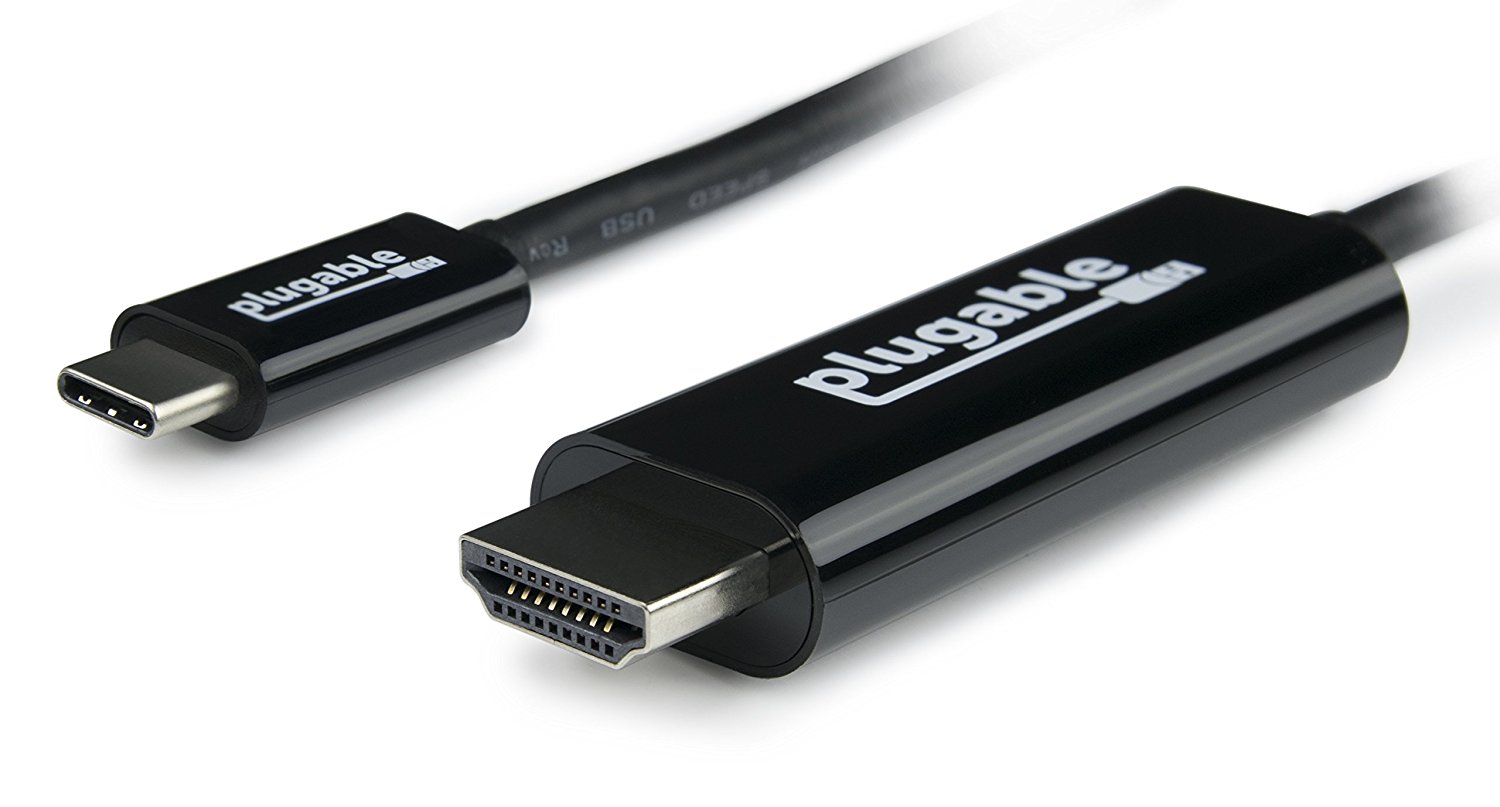

A USB-C to HDMI 2.0 adapter will be the best option. Any well-reviewed one, that has been tested at 4K on a Mac, will do. I'm not sure where you're located but here there are good ones made by Anker and Plugable and others, e.g. this.
Some advice: you might be keen to look for a cable rather than an adapter. These exist, but since USB-C to HDMI is not especially straightforward, they usually have one bulky end, e.g.:
Bear in mind the size of that when choosing a cable if the port on your monitor is short on space.
(You can also go for USB-C to DisplayPort if you want, but at least over here they're more expensive and harder to find.)
