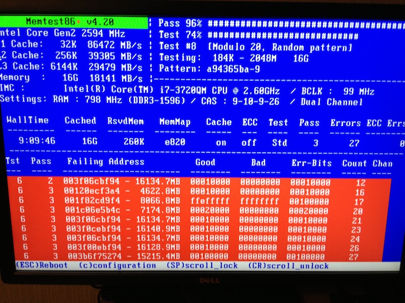

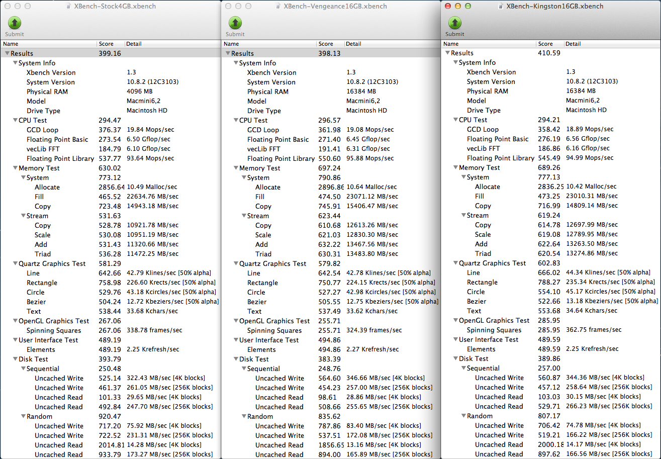

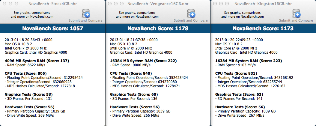

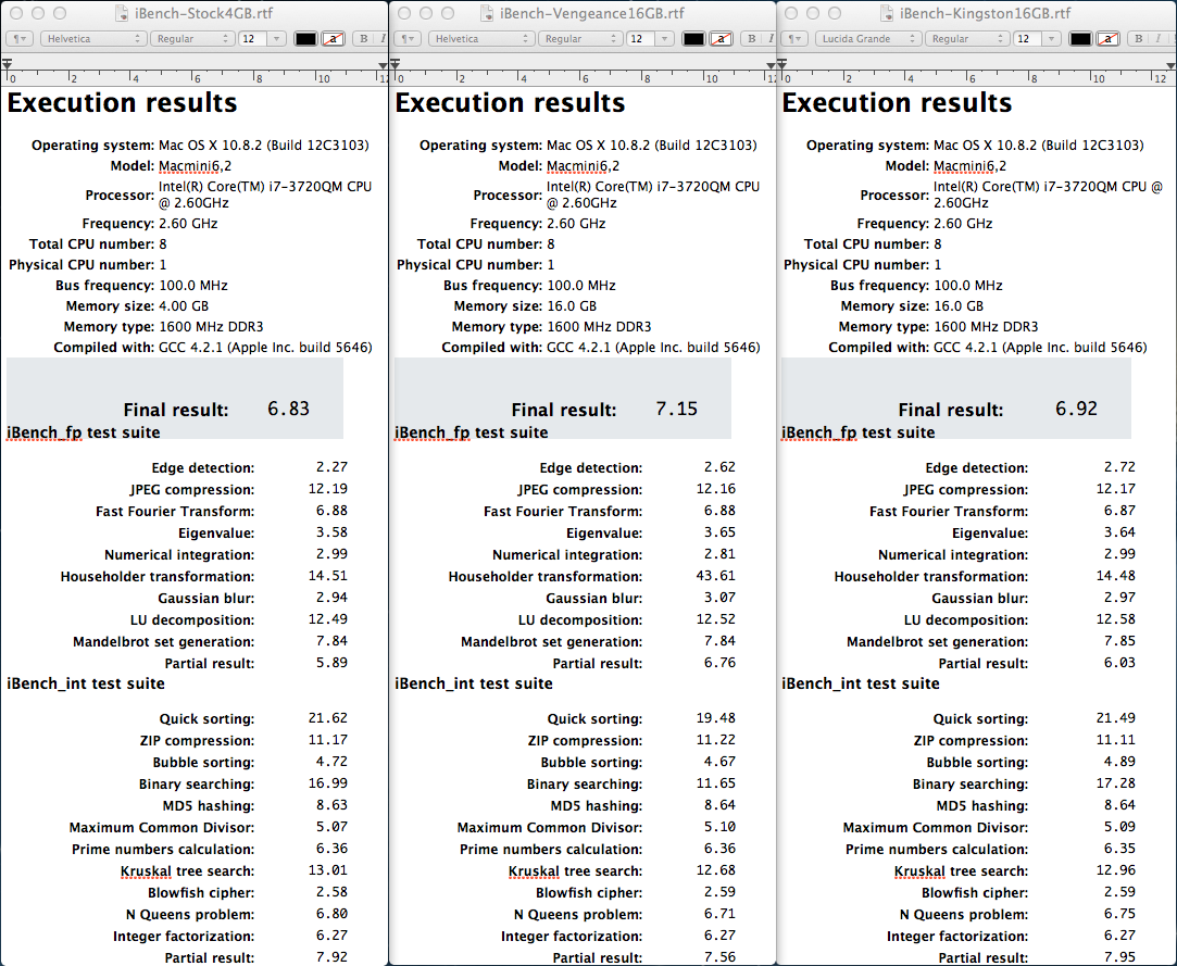

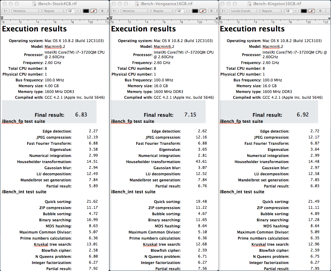

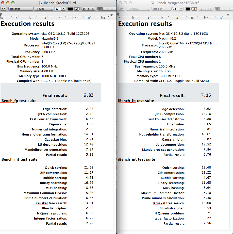

    Update; This started as isolated test of the Corsair Vengeance RAM, but has now grown to also include the Kingston HyperX PnP RAM. Kingston info starts in post #13 (http://forums.macrumors.com/showpost.php?p=16695272&postcount=13)
    Finally managed to get a hold of the Corsair Vengeance 16GB 1866MHz CL10 Kit (CMSX16GX3M2A1866C10) to try it out in the 2012 Mini.

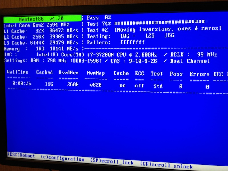

    Popped it in, booted into Apple Hardware Test and verified that my suspicions was right; the 2012 Mini runs the RAM at 1600MHz.
    Ran the Apple Hardware Test fine, then Booted up Memtest86+ to verify the timings: 9-10-9-26 (First picture attached). Let it go quickly for 1 pass, worked out fine.

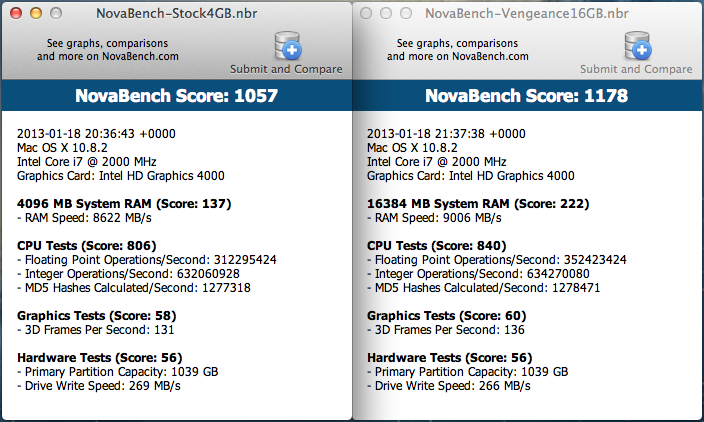

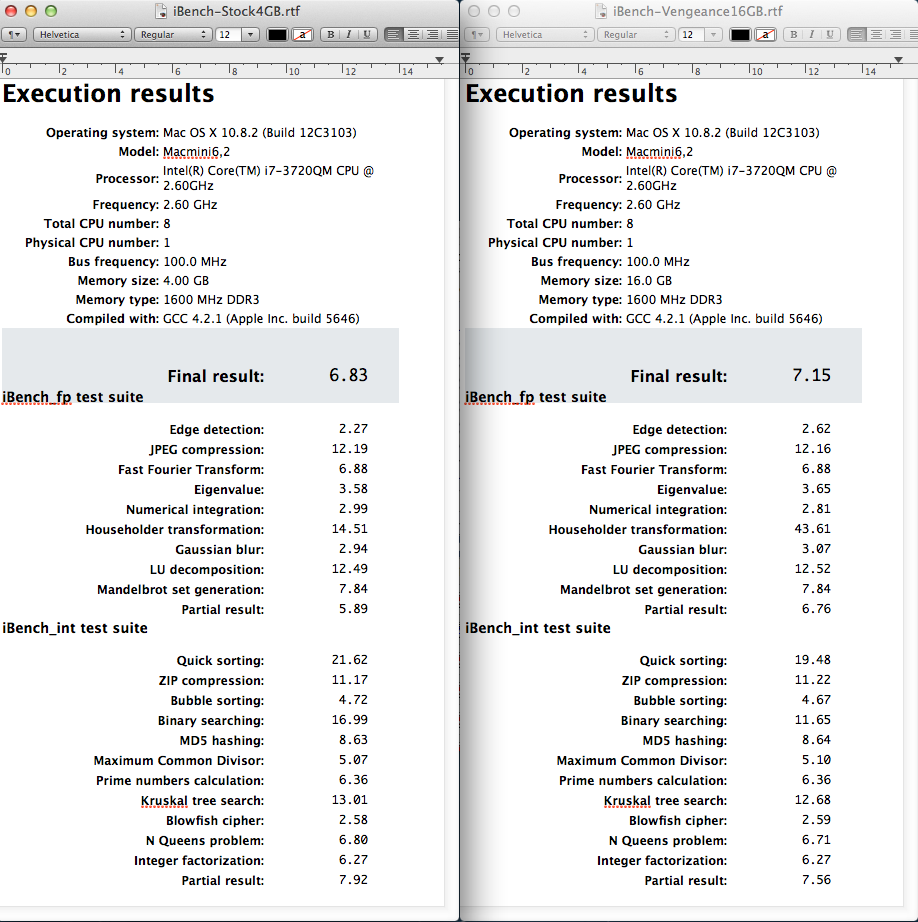

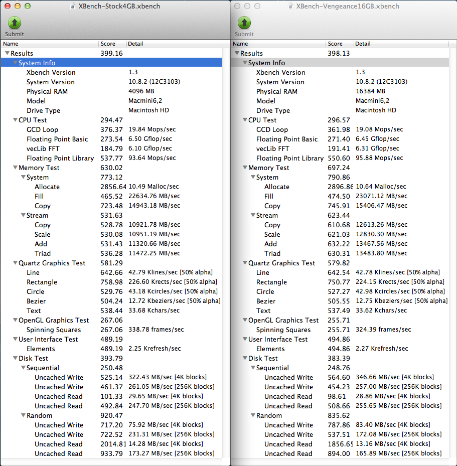

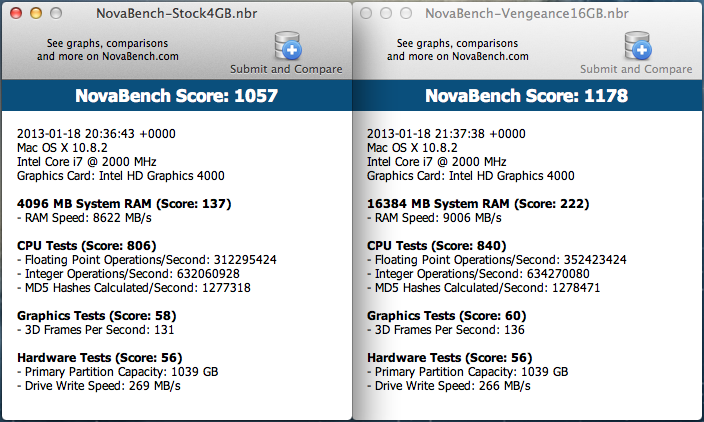

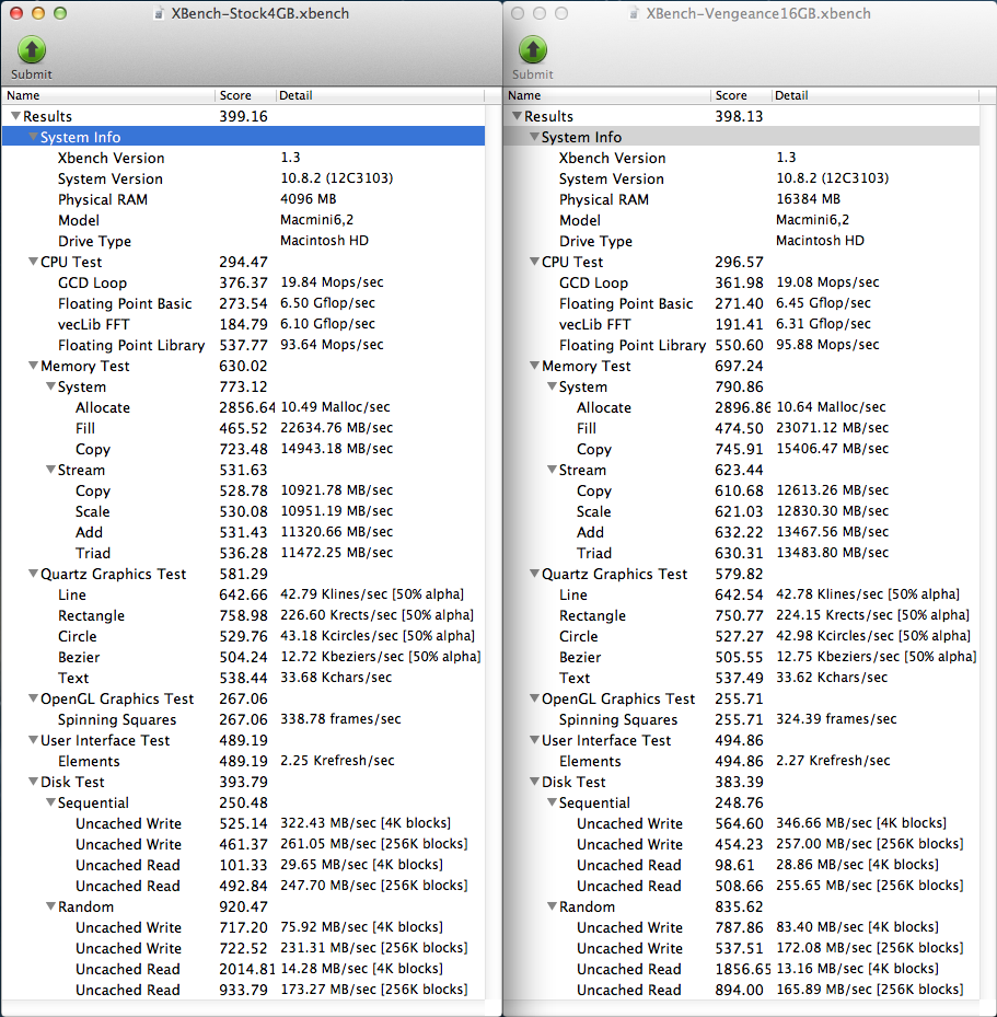

    Booted into OS X and ran iBench, NovaBench, XBench and Geekbench in that order. I attached the pictures of the summaries from iBench, NovaBench and XBench and the RAM tests really does get a boost from them.
    The Geekbench results is available for comparison here: http://browser.primatelabs.com/geekbench2/compare/1549130/1548933
    What can be seen is that the RAM performance of the Vengeance 1866MHz kits are really good. Some of the tests (especially NovaBench) seem to give a better score for simply having more RAM. None of the tests however did allocate the amount of memory that it should be noticeable with just the size increase.
    I also ran bandwidth, both 32 bit and 64 bit, to try to isolate out a smaller part of memory and do bandwidth testing, but everything there fell within statistical margins, and could hardly be registered by visually inspecting the graph given as output, so I believe that in the end that tool is more CPU bound than RAM bound.

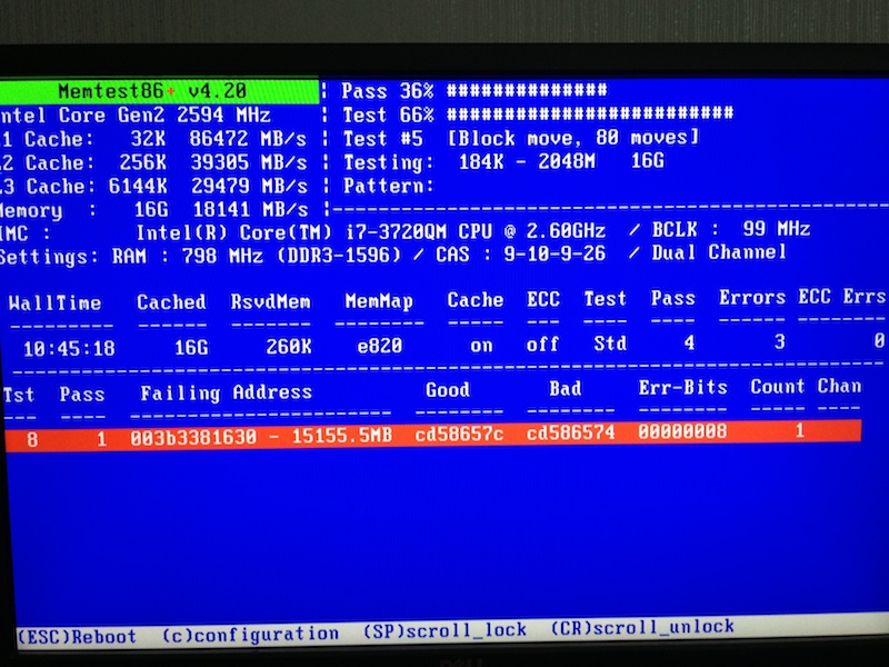

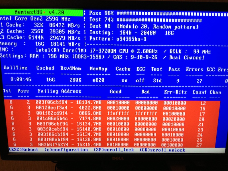

    Word of caution here; After doing these tests last night, I once again booted up Memtest86+, and let it run over night. When I woke up I found that it had completed 4 passes, detecting 3 errors... (Last attachment)
    I might've caught a bad kit, I'm not sure. I'm going to go over and try to replace my kit at the retailer, with my photos as evidence of it not being quite healthy. I will also have to see if I will be getting a new Vengeance 1866MHz CL10 Kit, or if I simply should exchange it for one of the Kingston 1600MHz CL19 Kits that has been reported as good by other forum members (but which is almost $30 more expensive at my retailer).
    The Kingston 1600MHz Kit's (both the "regular" and the Low-Voltage) is running at 9-9-9-27 timings compared to the 9-10-9-26 timings of the Vengeance 1866MHz (when run at 1600MHz), so its not quite clear which one is theoretically faster. It all boils down to exactly how the application you are running uses the memory.

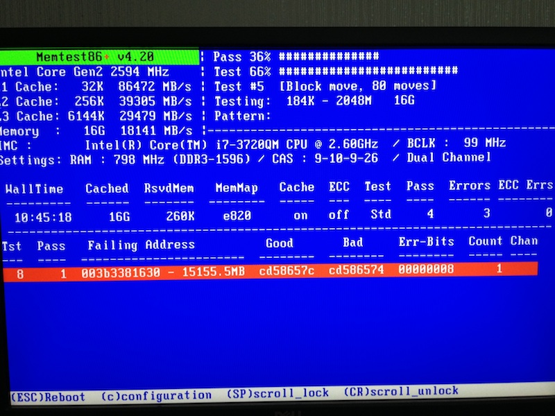

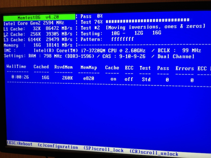

    And to follow up; Went to retailer, had the RAM kit exchanged to a identical kit.
    Came home, ran Apple Hardware Test, all fine just like first kit.
    Booted up Memtest86+ again; 2 errors detected on first pass, final result before I gave up was 27 Errors a few percent from 4 passes completed.
    Either I've been unlucky, and got two duds, or this RAM kit really does not like running in the 2012 Mini.
    Will see what to do about it tomorrow when I visit the retailer again, but the idea to switch to a Kingston HyperX PnP RAM running at 1600MHz with CL9 feels more and more tempting. :)
    Edit; Added photo of Memtest86+ result.

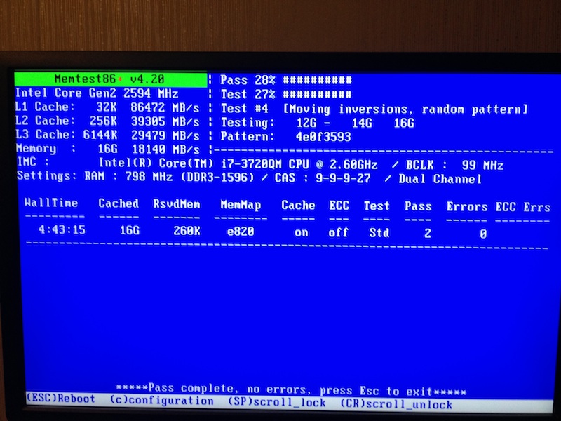

    Allright...
    As mentioned, the retailer agreed with my thoughts, so instead of trying for a third set of Corsair Vengeance 1866MHz RAM, I went with the Kingston HyperX PnP 16GB (2x8GB) 1600MHz CL9 RAM (KHX16S9P1K2/16).

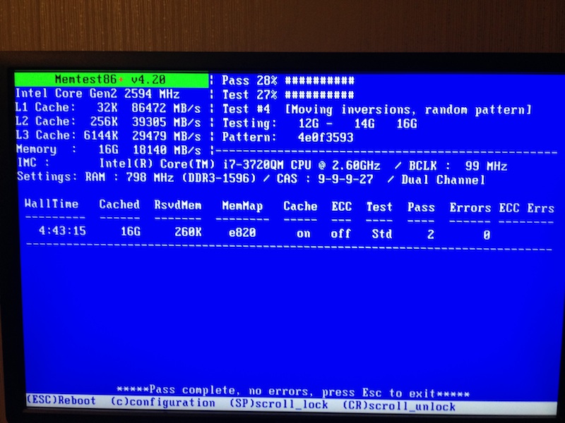

    Ran the same procedure as last time; Installed the RAM and ran the quick Apple Hardware Test to see that it seemed okay.
    Booted into Memtest86+ to get the timings, which in line with philipma1957's comments about the HyperX RAM indeed was running at 9-9-9-27. This time I also let Memtest86+ run for two full passes, to verify that it wasn't catching any issues already, came out without any errors detected (first picture).
    After two passes, I booted into OS X, and ran the same tests; iBench, NovaBench, XBench and Geekbench.

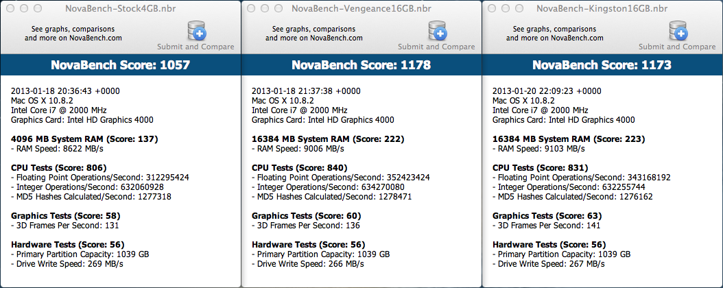

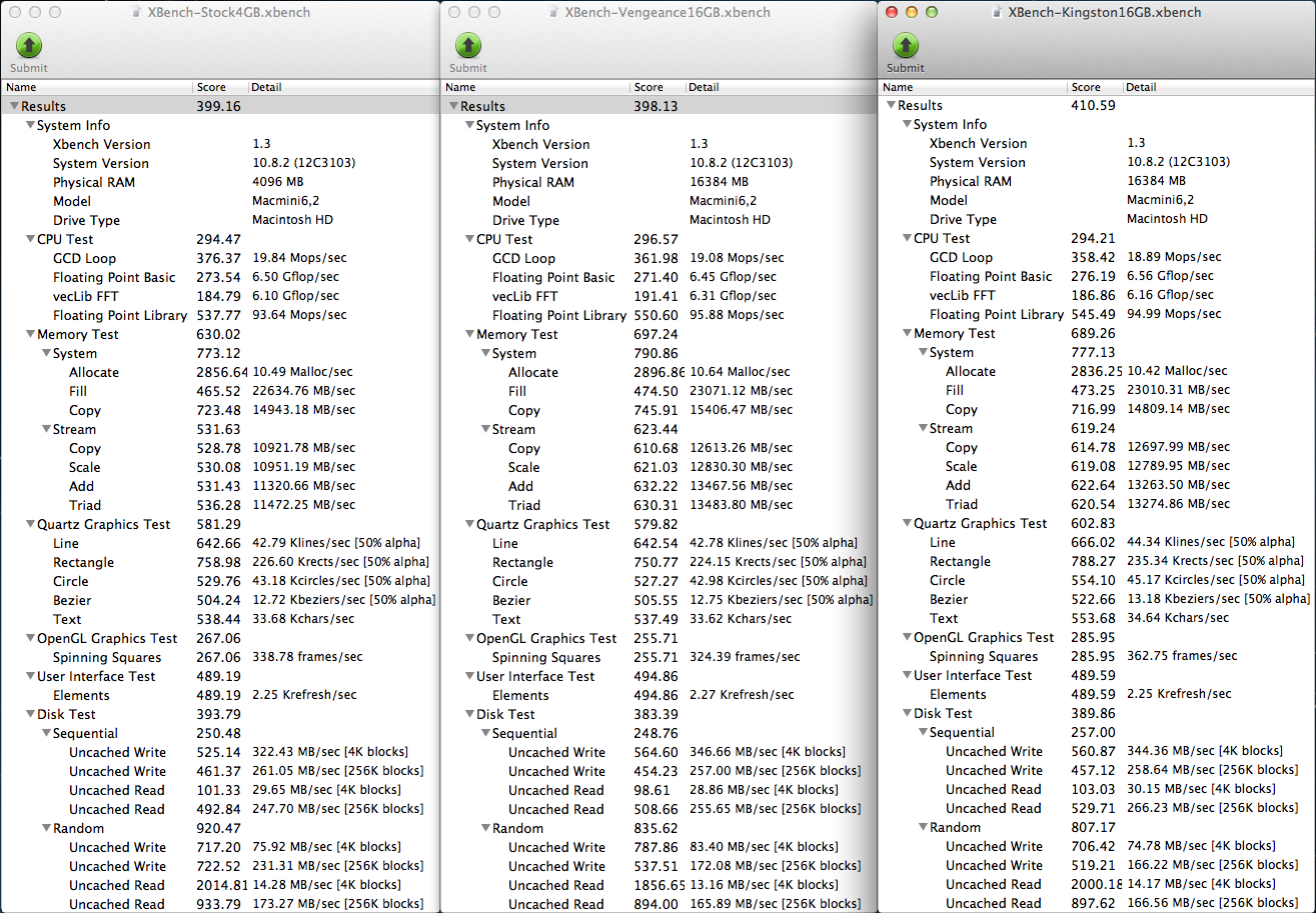

    So, now I had a set full set of benchmarks from three sets of RAM to compare;
    Stock Apple 4GB: 11-11-11-28 @1600MHz.
    Corsair Vengeance 16GB: 9-10-9-26 @1600MHz.
    Kingston HyperX 16GB: 9-9-9-27 @1600MHz.
    The second, third and fourth picture attached is the results from iBench, NovaBench and XBench side to side accordingly.
    For the Geekbench comparisons;
    Corsair Vengeance vs Stock 4GB: http://browser.primatelabs.com/geekbench2/compare/1549130/1548933
    Kingston HyperX vs Stock 4GB: http://browser.primatelabs.com/geekbench2/compare/1557287/1548933
    Kingston HyperX vs Corsair Vengeance:
    http://browser.primatelabs.com/geekbench2/compare/1557287/1549130
    It's back and forth which one has the upper hand. One cycle less of tRCD for one cycle more of tRAS does show a bit in the stream tests where I'm guessing the specific tests have a bit different memory access/write behaviors, thus there is a bit larger difference between the two RAMs in these tests than the others.
    All together, not really that big of difference between the Corsair and Kingston, both of them are ahead of the stock 4GB RAM the Mini was delivered with, which I'm guessing is mainly due to the better timings.
    After performing the tests, I put the Mini back into Memtest86+ and let it run over night again. In the morning, it had complete three passes without detecting any errors.
    So... Performance wise; with the current EFI where the Corsair Vengeance is restricted to running at 1600MHz frequency (with very unclear future for ever being run at 1866MHz in the 2012 Mini) is very similar to the Kingston HyperX.
    Stability wise, out of my small test batch of two kits, which both as far as I could tell by the packaging had been shipped to Sweden all the way from Australia (or do all Corsair packages come with Australian warranty information?) was quickly put down by the Kingstons.
    If I'd known I was going to end up with the Kingstons from the start, or if the retailer would have had it in stock, I would probably have gone for the Low Voltage variant of the HyperX though, running at 1.35V which may decrease the heat generated. But that test I will leave for someone else to do. :D

  17. magebarf thread starter macrumors member
    Joined:
    Dec 29, 2012
    Location:
    Gothenburg - Sweden
    #17
    Just put in a "proper" report of the Kingstons in post #13...

    I'd love to see someone do a benchmark running 1333mhz RAM. Just curious is all. Looks like the decrease in latency from the Stock RAM to the Kingston is marginal. Of course we also don't know how much of the increase in speed is solely due to latency since the benchmark was done with two different amounts of RAM (who knows if the 4GB test was hitting the max RAM during the tests). Either way, doesn't really justify the extra $50 (difference right now between "normal" 1600mhz and the Kingston HyperX) just to get less than 3% faster benchmarks (geekbench anyway). Even the GPU benchmarks from Xbench only shows a minor increase and some of that could have been the fact that OSX allocates more system RAM to the GPU when more than 4GB is put in.
    EDIT: Before anyone questions me on my thought process, 8-10 years ago, I used to buy expensive RAM trying to get every small percentage point out of my system. Ya know what I realized? In the end getting a 3% faster system at 6-8% of the overall system cost was silly. A buddy and I did a blind real world test (sat down played some FPS, surfed the internet, ripped some movies, etc.) and in the end I couldn't tell if I was running the fast RAM or the "slow" because you just don't notice 3-5% difference. 1 FPS is near impossible to tell, a video encoding finishing 30 seconds faster after it had run for an hour really wasn't noticeable, and in the end a Video plays back just the same whether on the faster RAM or the slower. Just my .02 worth.
  19. magebarf, Jan 22, 2013
    Joined:
    Dec 29, 2012
    Location:
    Gothenburg - Sweden
    #19
    Well, the actual latency numbers can easily be calculated, as we do know the RAM timings. What I don't know however is if the Apple 16GB RAM has the same timings as the 4GB set.
    But, the stock 4GB having 11-11-11-28 timings, vs the 9-9-9-27 of the Kingston, it is just to calculate backwards from the frequency (as the numbers are cycles).
    A bit harder is to evaluate what it actually turns out to in practice. :)
    As for differences due to 4/16GB RAM; I kept processes to a minimum when benching, so I can't say if any of them pushed above free RAM from the 4GB kit. I will run them later tonight with the Activity Monitor up, to see exact amount of RAM usage, to verify that this wasn't the case (which i do not believe). As I've mentioned though, I got the feeling that at least NovaBench gave arbitrary extra points for just having more RAM, even though it's actual performance test did not give all that much difference.
    As for the GPU tests though, none of them is really pushing the RAM bandwidth as far as I can tell, but to me seems more to be testing actual calculation performance. Seeing as XBench is a bit over 6 years old already, its also a bit outdated in the graphics tests I'm guessing.
    In the optimal outcome, where the Corsair RAM would've actually run in 1866MHz (which would be a even better outcome than I was expecting) I believe that the price difference would've been worth it for some people. For me, I felt that the documentation of it was worth a bit extra seeing as I could not find anyone that had actually tested the RAM.
    The jump from the Corsair Vengeance to the Kingston HyperX was more of an "best way out", trying to get fully working RAM. Seeing as it was the only proper 16GB kit (or Apple "certified" 8GB RAM sticks) my retailer had in stock that I could find any success stories for it was my easy way out.
    If I would've contrasted e.g. the Crucial 16GB 1600MHz CL11 Kit (which is half the price) against the Kingston HyperX from the beginning, I'm much less likely to have gone for the more expensive one. But compared to the 1866MHz Vengeance with all of its unknown variables when paired with the 2012 Mini, the choice was not that straight forward. :)
    As I said in the other thread; I've taken one for the team, and now with these experiences documented it will hopefully be easier for other people to decide if they think the same experimentation is worth it.
    I am fully with you on your reasoning, and this is most usually what the sane parts of my head tell me as well... But then sometimes the curious parts kick in and tell me otherwise. :)
    In this case, curiosity got the upper hand. Most probably due to mentioned lack of documented experiences from others.
