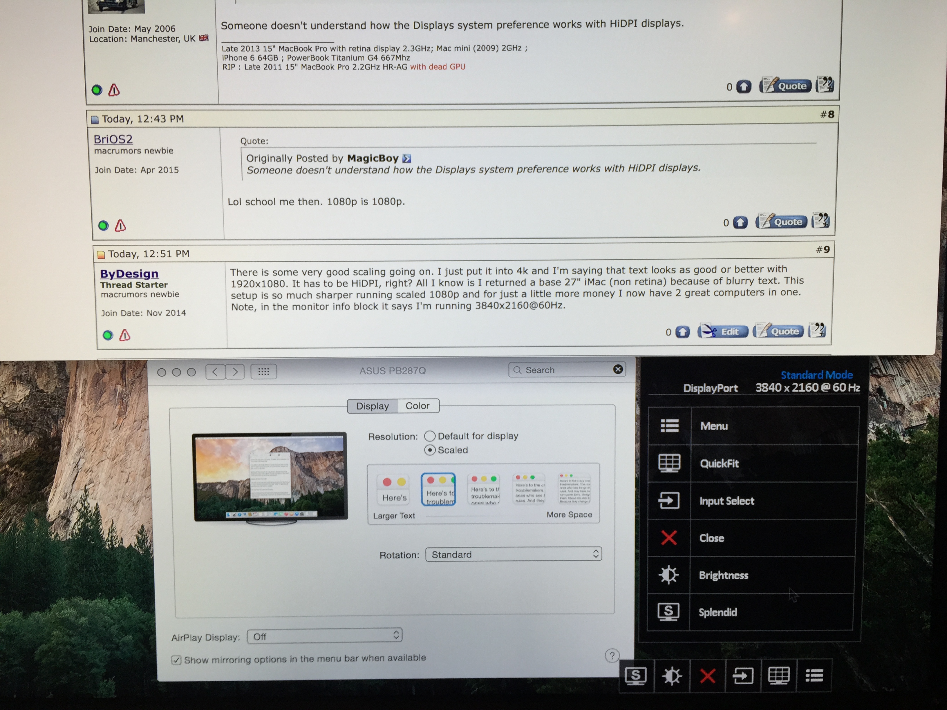

If you look at the Sig line of chevalier433 it states that he/she owns a Macbook Pro 15" retina early 2013. I would only assume that he/she read your question to quick and misunderstood that you were talking 2015 13" and not 2013 15".I'm guilty of doing this myself sometimes. If he/she read the question correctly then the answer chevalier433 gave was not accurate. Here is a picture of my 2015 rMBP 13" doing 60Hz as confirmed by my Monitors On Screen Display. The picture was taken with my iPhone 6 Plus.
Now keep in mind that not all is rosey at 60Hz for everyone! I have enjoyed this big 28" monitor for light photo editing and web browsing but some think the lag is unacceptable. I tried one game and had nothing good to say as I uninstalled it.
