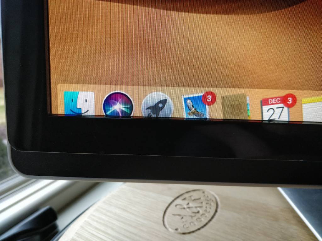

My parents got a new 2018 Mac Mini and it doesn't seem to be scaling properly.
I reset the monitor and it worked perfectly with a Windows 10 computer. I also hooked up the mini to multiple other monitors and everything looked good.
Any thoughts? The monitor is old, but I would them to be able to use it.
Thanks.

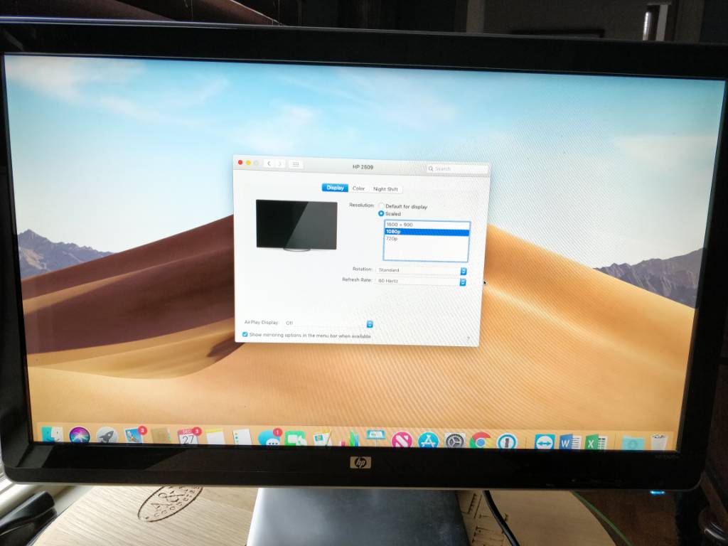

In the pics above, I see "1080p".
I'm going to -guess- that it's a 1080p display (i.e., 1920 x 1080), and that what you're seeing is what you're supposed to be seeing...

The Displays pref title line shows it as an HP 2509, so assuming it is an HP 2509m, then you have what the display is capable of doing, 1080p, or 1920 x 1080
Change the display resolution to "Default for display"
If you still have overscan issues, check the various built-in display settings. Should be an on-screen menu that you can bring up on the display screen, using buttons on the display itself. Try all the various options that you might have to see what makes a difference in the screen appearance.

It is HP 2909m.
We have it set to 1080P.
I looked into the monitor menu and overscan was grayed out. I couldn’t change it.

Try going to the "Image Control" settings in the on-screen menu (on the monitor, not the computer), and change the "Custom Scaling" to whatever the other setting might be. Save the setting, then cycle the power off, then back on.
Then, on the computer (your Mac), System Preferences/Displays. Change the Resolution setting on that pane to "Default for display". Should be exactly the same on the monitor itself, but may get your screen edges under control (maybe 😎 )

The Displays screen from the OP shows it as an HP 2509.
The OP says it is an HP 2909m, but searching results in nothing with that model number, so could assume that the screenshot is close to correct).
The HP 2509m has DVI-D, HDMI, and VGA inputs.
That's what is seen on the screenshot!
Well, not exactly. The screenshot says HP 2509, not HP 2509m. Could also be a 2509p. The only difference THERE is a webcam built-in to the -p, and no camera on the -m, so likely more common without the camera. So, I am assuming a 2509m. In any case, either model has the same set of inputs.
