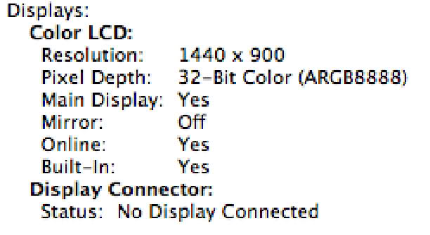

    So the main problem I have with the text is that it has this blur/glimmer, where it is noticeable that the letters are composed of not just black pixels, but quite a bit of red and green. I know they do this to approximate a smooth font on a lower resolution, but I'm surprised at how noticeable it is to the naked eye.
    Now here's what's interesting. If I zoom in with CTRL-two-finger-swipe, you can still see what I'm talking about:
    [​IMG]

    That looks more like a jacked up video card... I would have it looked at before you spend money on restocking fees etc.
    *edit - do you have an external monitor you can hook up?

    Looks like a problem with the way the font smoothing (or whatever Apple calls their version) is being done. Font smoothing makes the fonts look smoother by only lighting up certain colour pixels around each letter's edges.

    There could be a couple of differences you're seeing there, but I doubt it is related to the resolution of the panel, or that the fonts are "more pixelated".
    1: Snow Leopard changed the font options. You only have sup-pixel font rendering or greyscale font rendering now, there is no option to choose between CRT (greyscale) / Light / Medium / Strong text any more. (there may be a hidden preference somewhere, I'm not sure)
    If you are running an older version of OSX, perhaps you are using the light or heavy setting on your display. Alternatively, perhaps you're using the greyscale rendering on your Mac. If you change the option in system preferences > appearance, font rendering should look the same.
    2: The new panels are both brighter, and wider gamut than the old ones. This is probably emphasising the sub-pixel font rendering and making it more obvious. Personally I hate subpixel font rendering. I can see some of the benefits from it, but I find the colour fringing to be distracting.
    For this reason, I hope we start seeing even higher PPI screens from Apple. The higher resolution they get, the better text will look, and the better the subpixel font rendering 'trick' will work.

    For font to be "blurry" the engine powering those pixels needs to erring out. Panels vary in terms of color contrast, saturation, viewing angles and color reproduction. They do not vary in terms of displaying information in pixel-based terms. "Muddy" text makes NO sense when using the same hardware unless a issue is somewhere else.
    Im more inclined to believe it is a text-smoothing option in OSX somewhere causing this issue. Boot into your OSX DVD and see if the issue persists there.

    Make sure your font smoothing option is set for LCD and not CRT. Snow Leopard changed the font smoothing options, so you might want to play with that too.
