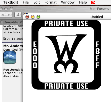

    I found this, but to be honest I have no idea what it is. Don't have access to a Mac right now to test it.
    Warning: taken from an xml doc (so pardon the code).
    <li>Mac <span class="caps">OS X</span> has a Unicode font engine called <span class="caps">ATS,</span> and when you type a character that doesn't have an assigned glyph in the font you're using, <span class="caps">ATS</span> will go hunting through your fonts to find a font that <em>does</em> have a glyph assigned for that character. In the case where it cannot find <em>any</em> font with that glyph, it substitutes a glyph from the <a href="http://developer.apple.com/fonts/LastResortFont/">Last Resort Font</a>. If you look at the <a href="http://developer.apple.com/fonts/LastResortFont/LastResortTable.html">table</a>, you see that the glyph in the Last Resort Font for the Private Use Area (U+E000 through U+F8FF) is the character "wum" from Dr. Seuss's <cite>On Beyond Zebra</cite>. To easily generate it (the given answer at <span class="caps">WWDC</span> was tedious but correct), pull up TextEdit, enable and switch to the Unicode Hex Input input method, press and hold the Option key, type "EFFF" and release the Option key.</li>

    I'm still trying to get the Seuss character - how do you enable and switch to the Unicode Hex Input input method in text edit?

    Oh, don't worry about that XML file... it's crap... WAY too summarised. I believe you also have to switch into Japanese

    You'll have to enable the good old flag menu in System Prefs>International>Input menu and check the box by Unicode Text Input.
      File size:
      22.1 KB
      Views:
      216

    Comes from the language that was proposed in On Beyond Zebra

    Actually, the character is called "wum"...the creature whose name it is intended to be used to write is called a "wumbus".
    And for anyone interested, here is the rather convoluted set of steps I gave to reproduce the character. It's actually a little simpler to display it using Unicode Hex Input...but that would not have been as dramatic. (Nor had I thought of it.)
    "Install 10.1.x.
    "Go to the International Preferences Panel and activate the Kotoeri Japanese input method.
    "Launch Text Edit.
    "From the Keyboard menu, switch to Kotoeri.
    "Open the Character Palette.
    "Switch to Shift-JIS view.
    "Scroll to the bottom and select an undefined character in the range greater than $F040.
    "In the upper left, this character will appear as a square with an X in it. Drag this character into Text Edit.
    "You will see a 'Private Use' glyph containing the letter 'Wum', as in 'Wum isfor Wumbus', from Dr. Seuss' 'On Beyond Zebra'."
    --blake (who asked the question)
