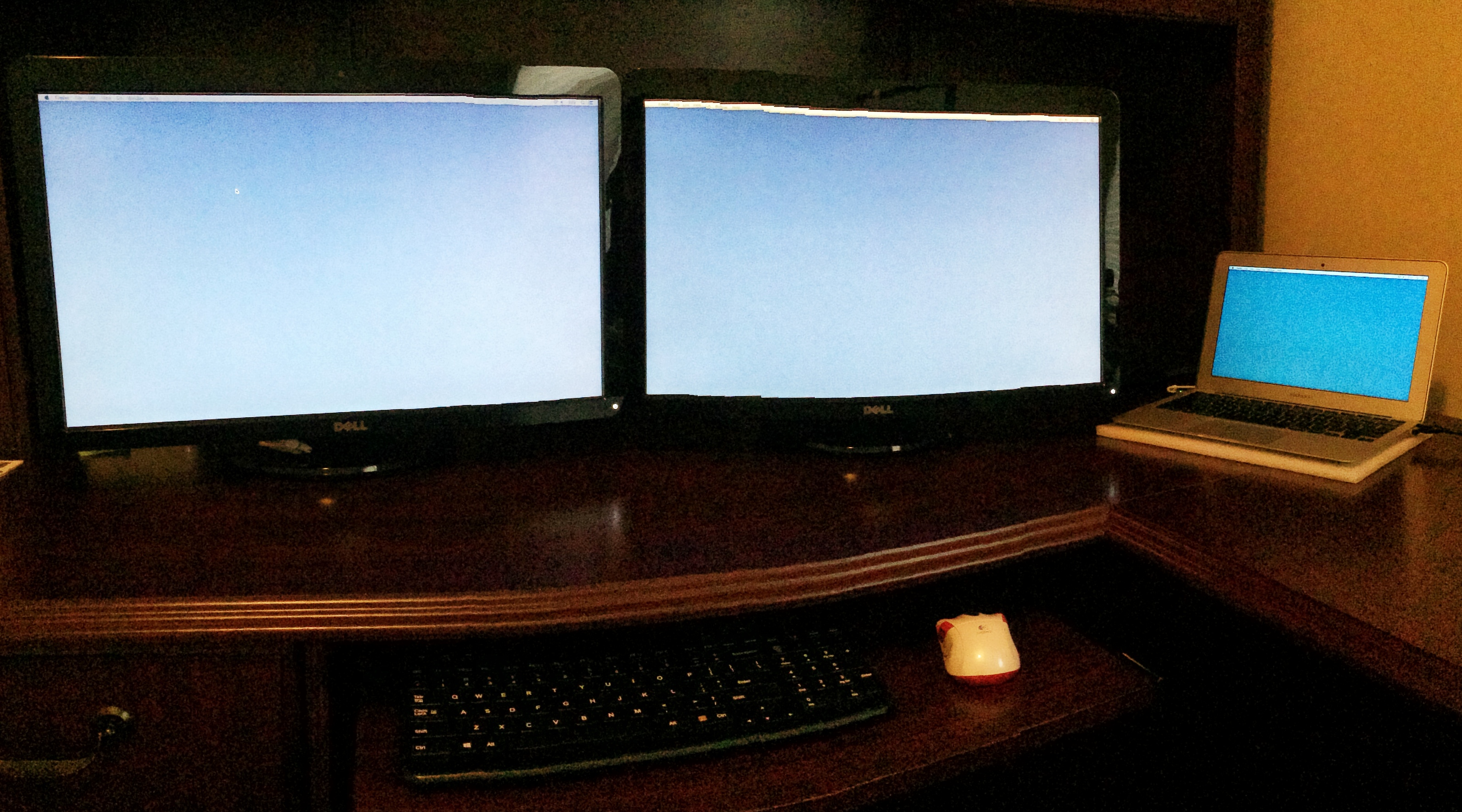

    I posted the same message in my thread about dual displays but thought it would be useful in this thread, too:
    I set mine up with 2 external monitors this morning. One is connected via mDP to DVI cable, the other via USB-to-HDMI adapter + HDMI to DVI cable. Both external monitors are running 2048x1152. As you can see in the attached pic, this also works with the MBA display as a 3rd display.
    Overall, quality is satisfactory, but not great. The USB-to-HDMI adapter is not an ideal solution. Though not horrible, doing anything on it is a bit jittery. For example, the mouse cursor does not glide across the screen as smoothly as it does on the screen connected to the mDP port. Also, if I drag a photo or a window from the mDP screen to the USB screen, the photo or window will turn black for a second or two before showing up again. Almost as if the USB display takes a brief second to register the contents.
    I think these are just limitations of a USB display. As far as I can tell, it's not really taxing the CPU in any noticeable way, and I didn't notice any performance slow down.
    I think this setup would work for somebody doing primarily office-type tasks, but would probably be pretty bad for video and photo applications.
    I'm still on the fence as to whether it's good enough for me or if I would be better off with a solution that does not require a USB display adapter, such as the rMBP 13" which has two mDP and an HDMI output.
