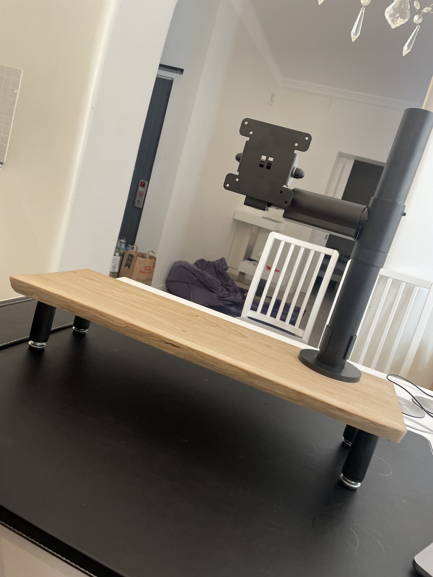

I have a similar situation. Not possible to use clamp nor drill, but still wanted vesa mount for flexibility and to improve deskspace under monitor. My solution - i built a monitor shelf with vesa mount drilled into the monitor shelf. See attached picture (still waiting for the ASD to attach) ?

Interesting Idea. Wondering how the stand will balance under the weight of the monitors. Will it be balanced enough to hold? I have 2 monitor shelves right now but not nearly that wide and their aluminum. This is an idea I might have to consider though.
Where did you find the legs for your shelf?

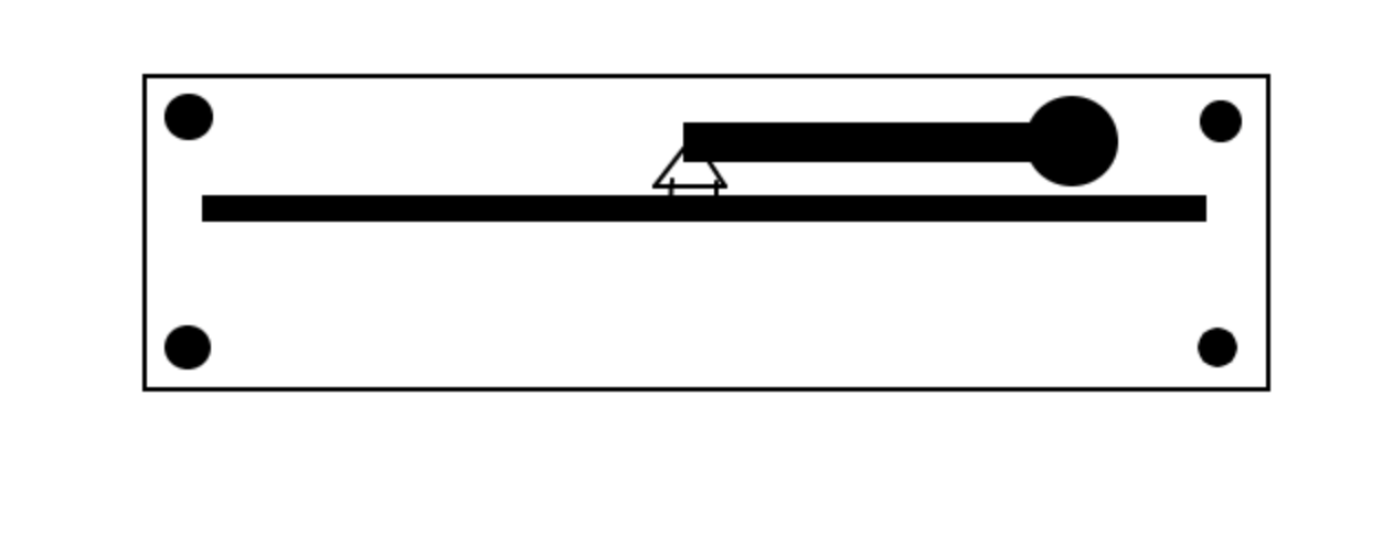

Yeah I also wonder that. Have tried to mitigate that for stable setup by:
- Vesa arm is lockable and will be configured to ideal height and position and then locked into place. Arm is actually meant for Point-of-Sale systems. Was the cheapest and simplest vesa arm I could find (approx 99 USD).
- Heavy and solid shelf (solid oak) about 1 inch thick. Heavy!
- Placement of arm will ensure monitor is ~in middle of shelf and center of gravity ~1-2 cm back from the center of legs.
Approx monitor placement in illustration:
The legs I found at Bauhaus:
https://www.bauhaus.se/mobelben-habo-511-3x10cm (~3 USD / leg)
IKEA also have many popular legs that can be suitable, for example:
https://www.ikea.com/se/sv/p/capita-ben-rostfritt-stal-30244346/ (~15 USD / 4 legs)
