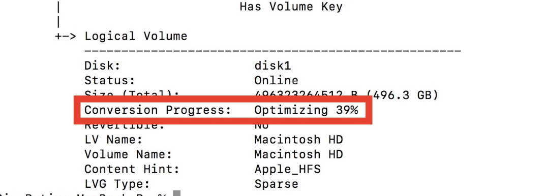

With the drive attached, enter this in Terminal and it will show encryption progress.
Code:
diskutil cs list
It will look like this if the encryption is not done.
Reactions: stanw
