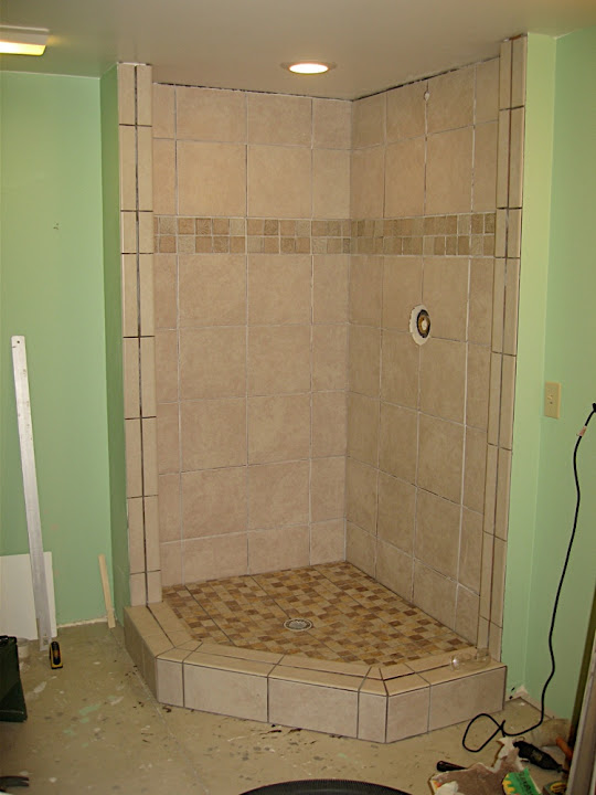

    Fwiw, this basement DIY bathroom project has been pre-occupying my "spare" weekend time over past few months.
    Now I'm in the homestretch, grouting the tile this weekend and installing the shower glass doors, so there will be more "play" time shortly.
    My goal was "done" by Easter, probably setting bath floor tile Easter weekend then toilet install/cabinet/sink install. So, weekend after easter....(sorry tmi, I'll be just glad to get this done)
