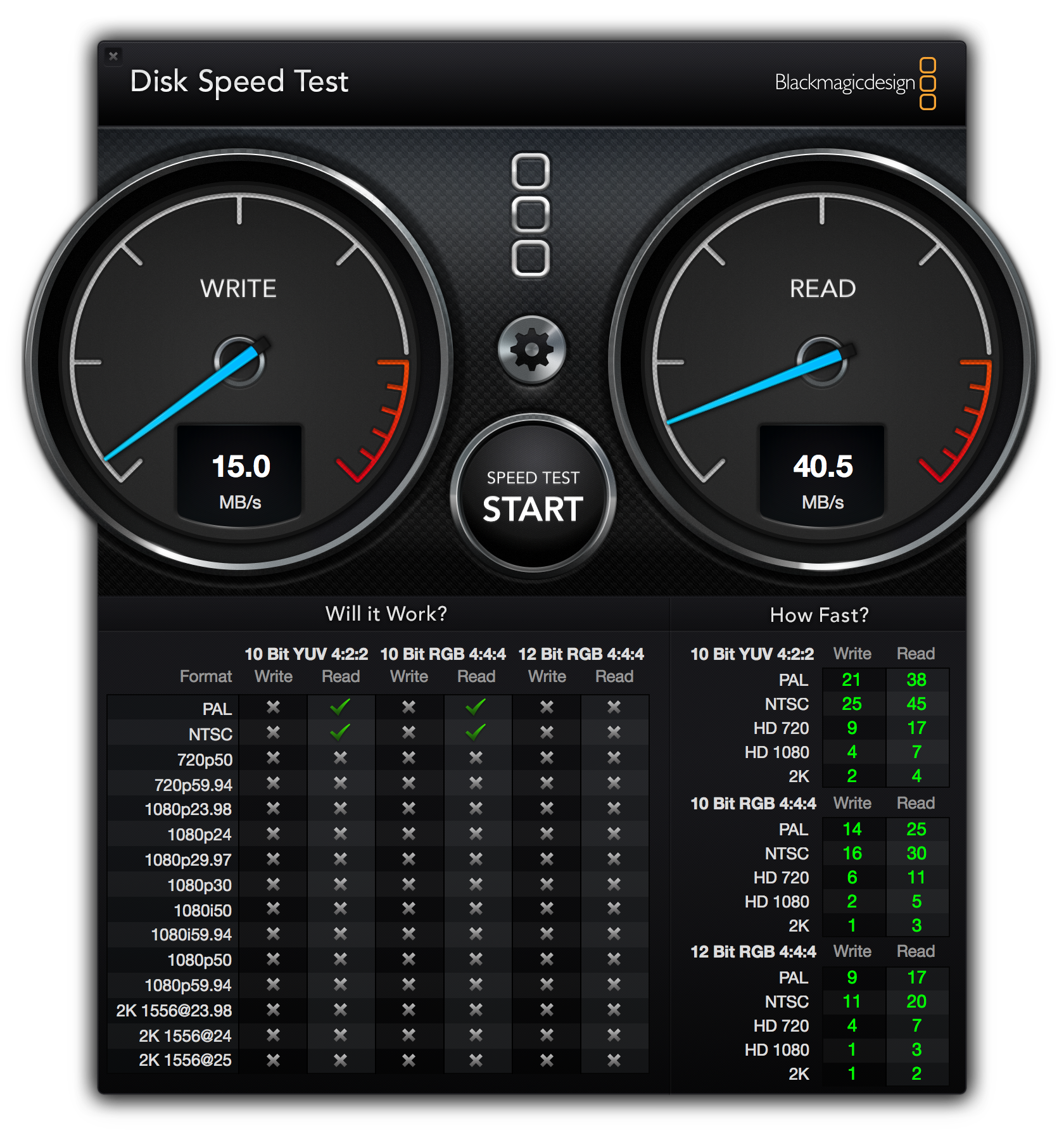

    I just tested every ports with two USB 3.0 flash drives. Both of them were only recognized by the one next to the Thunderbolt ports.
    And here ist a speed test:
    For that one:
    I don't understand why this issue appears again and again in every Beta and never exists in a final version. o_O
