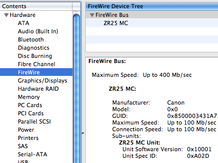

    If your camera is a miniDV tape camera, then firewire is your only choice for importing the video without loss. Otherwise you'd need to use an analog converter from the video out port you would use to hook up to a TV.
    I attached a clip of what System Profiler shows when my camera is hooked up.
    There are four points of possible failure of why OS X might not see your camera; the camera, the Mac firewire port, the cable, and human error.
    The camera should be turned on BEFORE you start System Profiler, otherwise you have to use the Refresh option.
    Cables are often the problem, so make sure your connections of fully inserted. If so, more the cable around and try the Refresh option several times.
    If you can try it with someone elses computer that would be a good idea too.
