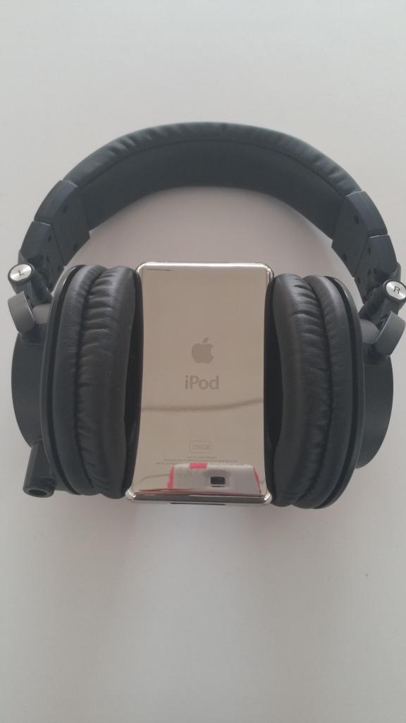

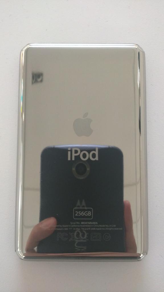

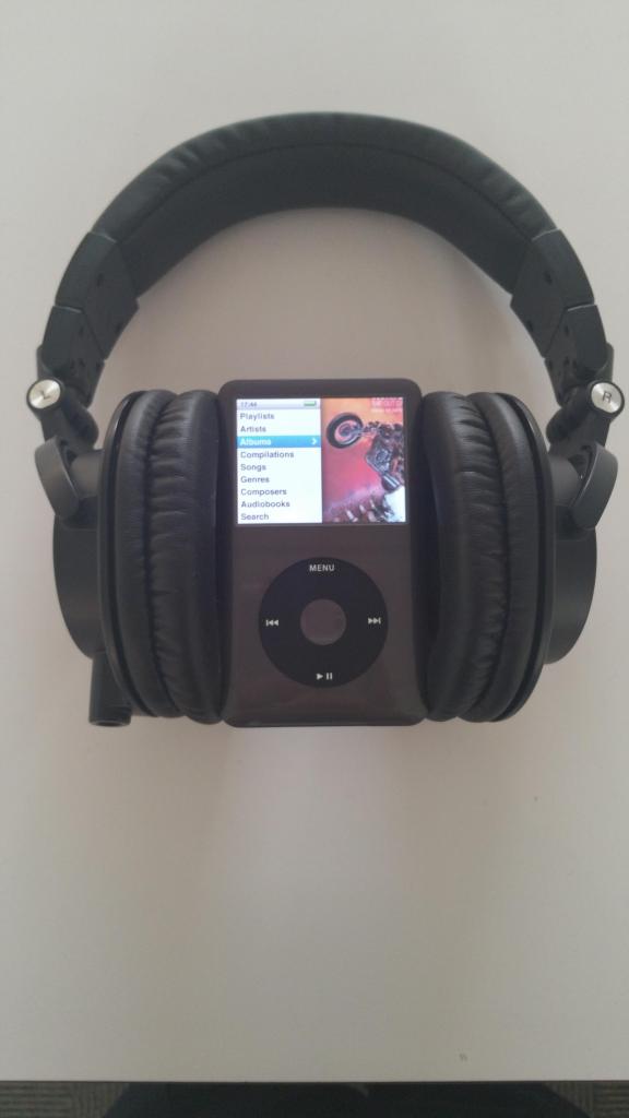

    Well finally finished my Classic upgrade. No moving parts and quite speedy.
    1 Brand new iPod Classic 7.5g 160GB
    1 Tarkan CF-SDXC Adapter bundle
    1 PNY 256GB SDXC
    1 256GB Metal backing thin
    1 Zagg Invisible Shield full body cover
    [​IMG]
    [​IMG]
    [​IMG]

    noodles, you've done something to be proud of there.

    Also, what's up with the different phones in the pictures (not trying to be nosey or anything)?
