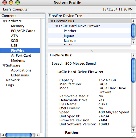

    Did you try another program like iChat (to see if it picks it up)? You can also download Gcam or Evocam from Versiontracker and try them.
    In System Profiler does it show up on the FW bus?
      File size:
      58.3 KB
      Views:
      49
