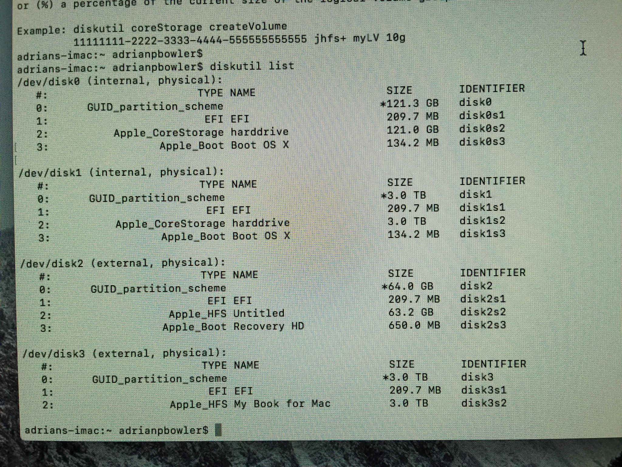

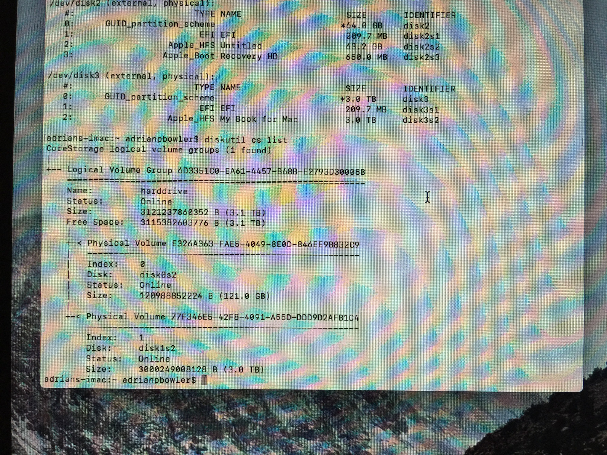

    Split Fusion drive on i-Mac running High Sierra was restored following Apple’s instructions .when attempting to reinstall the OS the fusion drive does not appear in the screen for destination disks.fusion is similarly not visible in Finder or Disk Utility.Both parts of the fusion drive appear with diskutil list.How do I make the Fusion drive re-appear?any suggestions

    Print the outputs of diskutil list and diskutil cs list

    2B141862-2053-4FF1-AB05-AAB972691A3F.jpeg 9E898166-9FFE-417C-A623-66C61FAD8F7C.jpeg

    Next time, could you please either copy/paste or take a screenshot? Kinda hurt reading that...
    Anyways, this does look a bit strange. You have an LVG, and it is spread among your two drives, but it shows no virtual disk in diskutil list.
    I would recommend trying the following things
    1) Use the resizeStack command to try and see if your cs volume is just set to be 0 in size.
    Syntax is as follows
    11111111-2222-3333-4444-555555555555 3211g JHFS+ New 3211g
    With 11111111-2222-3333-4444-555555555555 being replaced by your lvUUI
    2) If that didn't work, try deleting the cs group and remaking it.
    3) Output any error messages here
  6. BLUEDOG314 macrumors 6502
    BLUEDOG314
    Joined:
    Dec 12, 2015
    #6
    It's sounding like you will need to do a rebuild. I've had something similar to this happen and no matter what I did, they showed up split.
