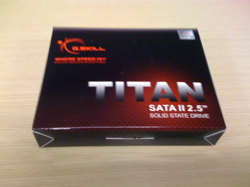

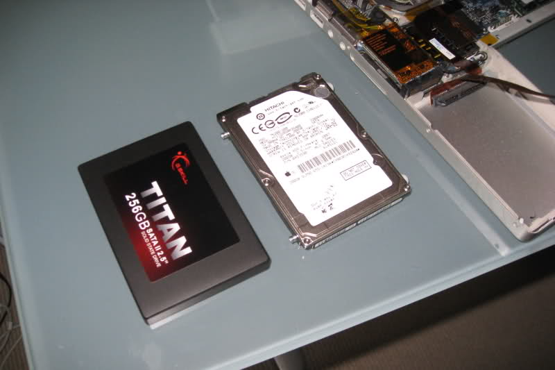

    My apologies if this post turns out to be a bit long winded. I've always wanted an SSD in my Macbook Pro. I bought my machine with a 200GB 7200rpm drive and it is rapidly filling up. So I told myself I wouldn't buy an SSD until I could go UP in capacity and UP in speed and fill that need for under $500. A week ago, I read the reviews here, here, and here, saw the price here, and decided that it was time to take the plunge.
    This is the newest G. Skill Titan drive. It actually links two SSDs internally into a RAID 0 configuration. That’s how it gets the major speed increase over the previous generation product. Most negativity I read about the drive is actually intended for the old device, not this one, I believe.
    [​IMG]

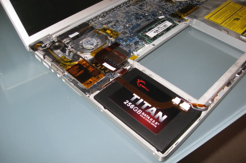

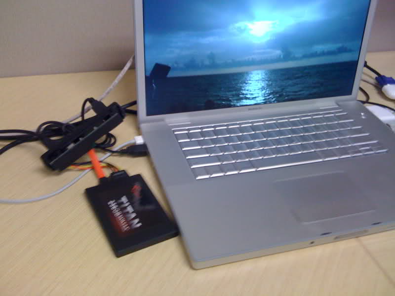

    I was at work when the package arrived and I couldn't replace the drive at that point. I was curious, though, about the temperature and noise of an SSD, since this was my first SSD experience. So I left the bare drive on my desk, hooked up power / sata, formatted the drive, and started copying files around. After about 30 minutes of large file copies, the drive felt slightly warm. But by slightly, I really do mean just slightly. I put my ear on it to see if I could hear something. It seemed silent at first, but once I pressed my ear on it, I could hear some sort of noise in there. I dunno... hard to describe... sounded 'electrical' I guess? Definitely not like the spinning of a hard drive. Nearly silent.
    [​IMG]
    I have the second most recent MacBook Pro. It’s the machine that came out in February 2008. It has the Penryn 2.4ghz (3mb cache) chip in it and 4GB of RAM. Pretty shell aside, the main difference between this machine and the newer one is that I don’t have the nvidia chipset, DDR3 memory, and faster frontside bus. The newer nvidia chipset obviously also has a different sata controller. And of course... this Macbook Pro doesn’t offer “easy” access to he drive bay. I'll write up a blog post in the near future and link to it with more pics of the surgery, but I didn't find the swap too difficult. Last time I had to really dig into an Apple laptop was when I put a 7200rpm drive in my iBook G3 700mhz years ago. If you’re comfortable with digging around inside a desktop PC, you can do this. If you’re not, I don’t think I’d recommend it. My plan was to swap the drives and then use the OS X disk utility on the Leopard Install disk to restore from my original drive.
    [​IMG]
    [​IMG]
    The drive replacement was a success! I was bit nervous pushing that power button... was worried the machine wouldn't turn back on properly! :p

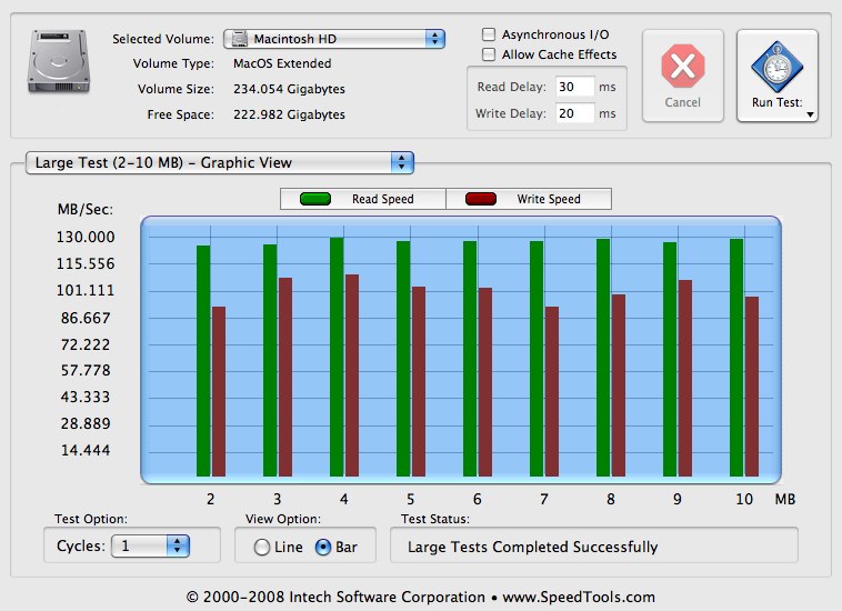

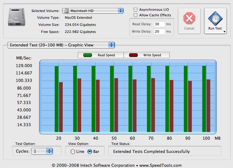

    I wanted to capture a before / after XBENCH disk comparison so last night, I shut down my MBP. I booted it up and ran xbench. Then I shut it down, rebooted, and ran it again, and then i repeated. I wanted to run it 3x to see how the machine scored. I had heard that doing SSD tests could provide a lot of vastly different results for each test so when I ran the SSD tests, I did the same process as above, and ran it 3 times. So the scores you see are an average of 3 runs. And I did not see huge jumps in scores between the same tests. All of the numbers were within 10% of each other.
    Old drive:
    Disk Test 41.51
    Sequential 66.29
    Uncached Write 105.08 64.52 MB/sec [4K blocks]
    Uncached Write 104.63 59.20 MB/sec [256K blocks]
    Uncached Read 30.49 8.92 MB/sec [4K blocks]
    Uncached Read 118.06 59.33 MB/sec [256K blocks]
    Random 30.22
    Uncached Write 10.08 1.07 MB/sec [4K blocks]
    Uncached Write 85.15 27.26 MB/sec [256K blocks]
    Uncached Read 77.70 0.55 MB/sec [4K blocks]
    Uncached Read 116.55 21.63 MB/sec [256K blocks]

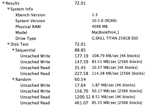

    New SSD:
    Disk Test 66.40
    Sequential 73.22
    Uncached Write 152.42 93.59 MB/sec [4K blocks]
    Uncached Write 118.80 67.22 MB/sec [256K blocks]
    Uncached Read 28.81 8.43 MB/sec [4K blocks]
    Uncached Read 202.35 101.70 MB/sec [256K blocks]
    Random 60.74
    Uncached Write 17.99 1.90 MB/sec [4K blocks]
    Uncached Write 143.18 45.84 MB/sec [256K blocks]
    Uncached Read 1029.45 7.30 MB/sec [4K blocks]
    Uncached Read 431.54 80.07 MB/sec [256K blocks]
    So it's definitely not as fast as the Intel drive. Now that being said, it can definitely be debated as to how useful an xbench test really is anyways. Its like those PCMark / SiSoft Sandra tests on PCs. They don't mean that much. Actually, not to get off topic, but man could we really use something like 3DMark on the Mac. I was on the Xbench site and it looks like the last update was in.... 2006!! That was three years ago! Hopefully they can update it. Moving on....

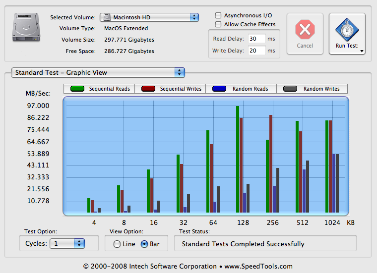

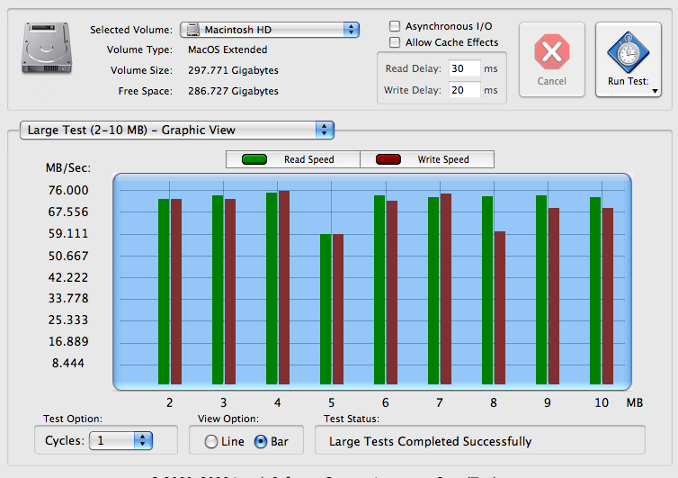

    ok.. took longer then expected..
    I didn't think it was worthy of a new thread since we're talking about the same SSD here..

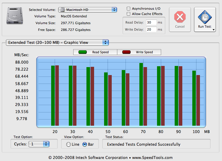

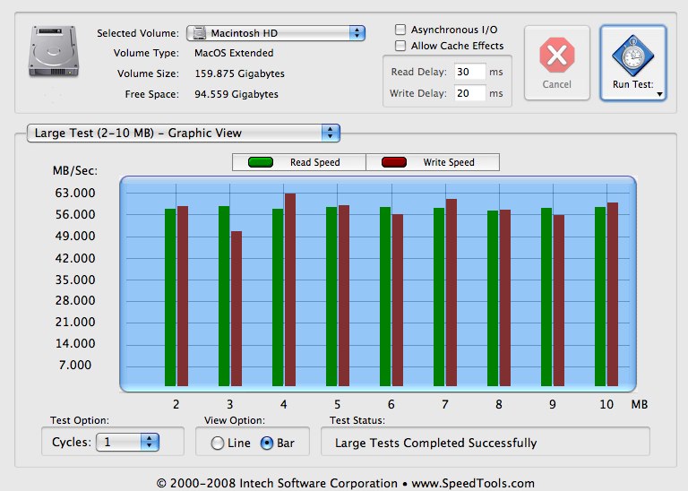

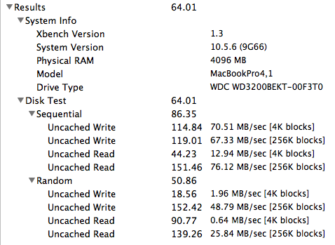

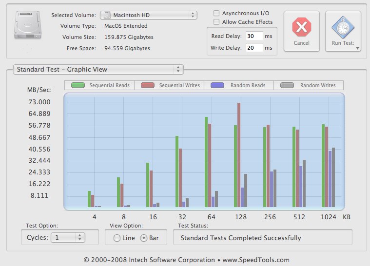

    My main machine is a Early 08 17" 2.5 Penryn Macbook Pro with 4GB Ram and the stock 200GB 7200 RPM Drive
    I have a spare machine here that's a Santa Rosa 2.2 with 4GB and the stock 200GB 5400 RPM Drive that's been waiting for a Western Digital 320GB 7200 rpm Scorpio to be put in it and sold on ebay.
    The way I tested is I first ran each test (Xbench and quick bench) 3 times after a reboot and took the middle number. The timings were done with my iphone stop watch.
    17" 2.5 with stock 200GB 7200 RPM HD (all times in seconds)
    Bong to full desktop - 48
    safari - google.com home - 3.4
    Firefox 3.0.0.6 - google home - 8.6
    word 08 - 5.6
    [​IMG]
    [​IMG]
    [​IMG]
    [​IMG]

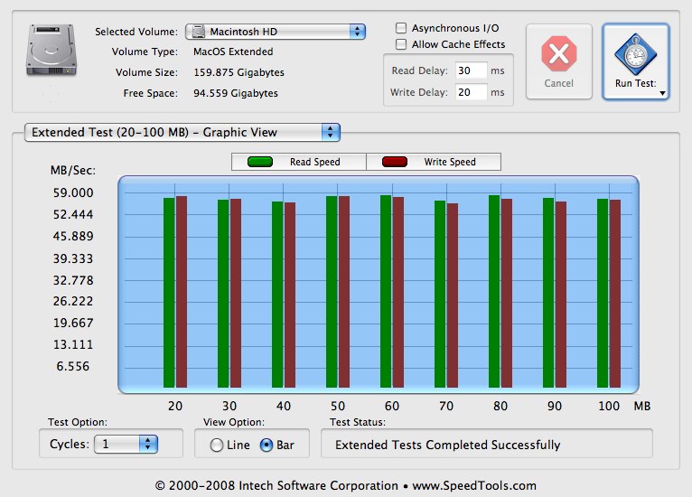

    Same Machine with the WD Scorpio 320/7200
    Bong to full desktop - 37 seconds
    safari - google.com home - 2.1 seconds
    [​IMG]
    [​IMG]
    [​IMG]
    [​IMG]

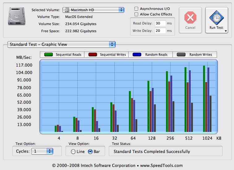

    Same Machine with the G.Skill 256GB Titan SSD
    Bong to full desktop - 24 seconds
    safari - google.com home - instant
    [​IMG]
    [​IMG]
    [​IMG]
    [​IMG]
