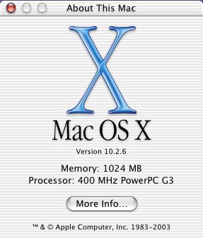

    Id say it's quite possible that a G5 could handle 16 GB, and maybe even more if bigger DDR chips are made.
    According to Apple.com, my iMac can only handle 512 MB of memory, but as you can see, that just isn't true.

    According to the Apple Developer docs, the G3 iMac can handle up to 1GB of memory.
    These are the documents to look at instead of the insert with the computer.
    The link I left at in a previous post is for ALL the macs, but they usually lag product shipment by a few weeks or a couple months.
