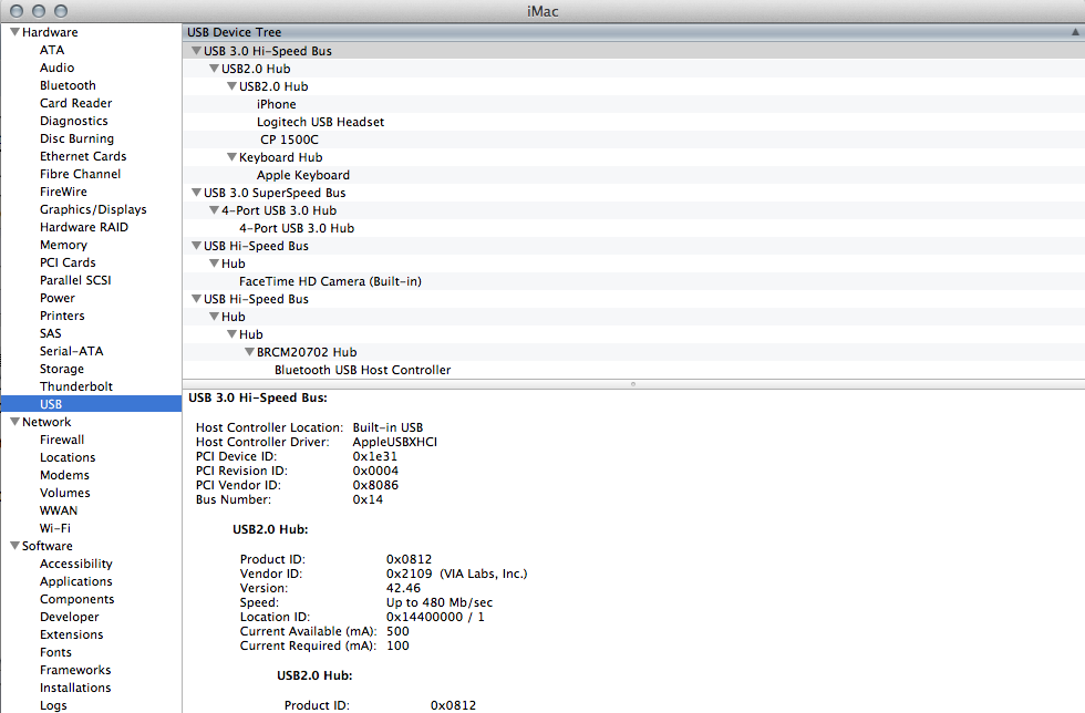

  5. OneUp thread starter macrumors newbie
    Joined:
    Mar 30, 2011
    Location:
    Edmond, OK
    #5
    Yeah, I went with this one. Right now it's the only thing plugged into the back of the iMac and all USB devices are running from it (keyboard, UPS, headset, etc). Unfortunately, I don't have any USB 3.0 devices laying around to test it with, so I can't tell if it's going to register as a USB 3.0 device or not...

    Well, looks like speeds are going to be the last of my problems.... With the Anker USB hub connected, the iMac won't wake from sleep at all. :( Is this something typical of powered USB hubs on the Mac? Any hubs that don't cause this?
