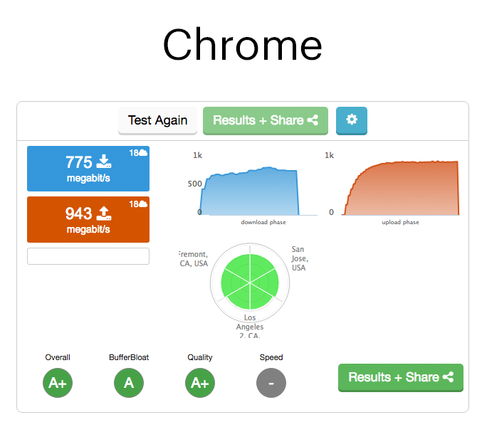

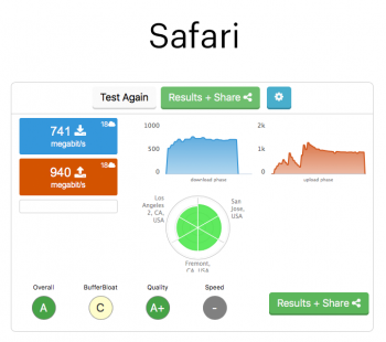

So I tried dslreports.com/speedtest on safari and chrome.
there was a much smoother test when doing this on chrome vs safari.. safari had TONS of bufferbloat
See the attached images
Oh and yes, I was testing this on ethernet, not wifi.

Looks exemplary to me. You don't have any problem with your "internet".
And either browser speed is way more than needed for human browsing.
You might want to make sure to use Google if you are downloading something big.
Your router is another factor. Do you have any QOS enabled?
I think you're picking nits.

Good detective work!
BTW, both speedtest.net and dslreports.com do offer an http: connection. Not sure what the app uses.
Maybe Chrome has some https: tricks up it's sleeve for processors that don't have the AES instruction set, and uses it's own code?
BTW, from that thread, Geekbench 4 single-thread crypto score was 147 (ouch!) on the W and 1636 on the X.
I just tested iMac Pro at 4408 (29975 multi 8-core/16 thread).
And 2012 Mac Mini i7 at 2770 (8311 multi 4-core/8 thread). 2012 Mac Mini i7 is still in a sweet spot. ;)
But pretty sure the iMac Pro uses the T2 chip for SSL encryption, rather than the CPU, at least for the system framework (and, so, Safari).
Yow, the Nehalam really sucks at crypto!
Interesting to see the huge gains on crypto score, indicating how important it has become and pushed CPU capabilities.
