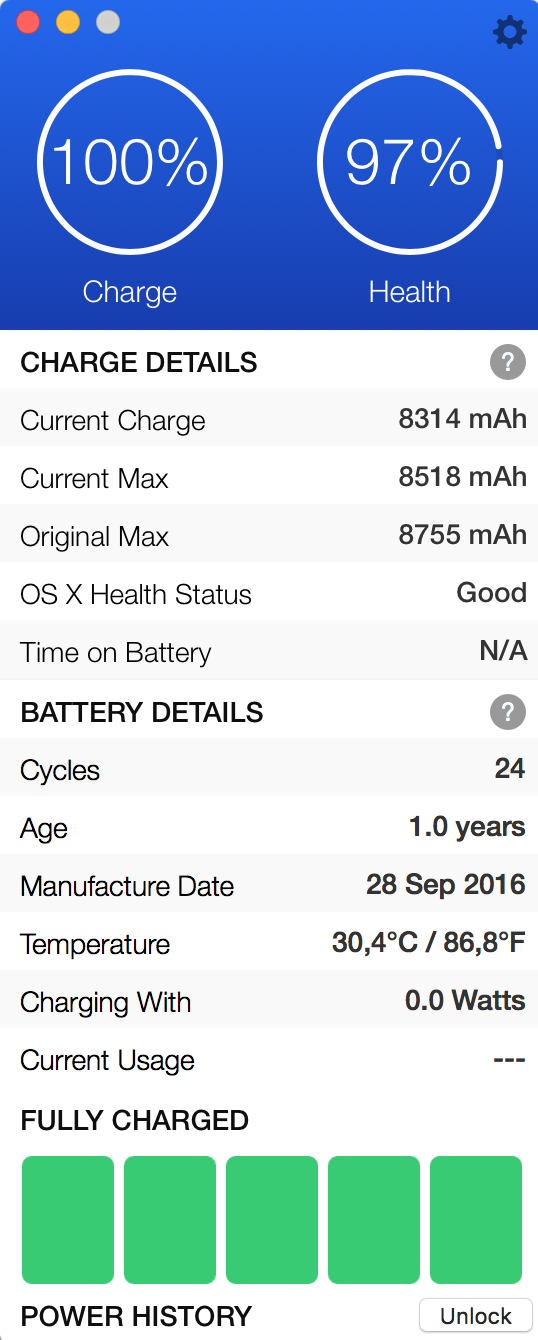

hello man .. pleas i wanna ask you something about the health battery on MacBook pro 2015 15inch. i have my mac same like you from 3 month ago its brand new from apple store. and the battery health now with me is 97% it's normal ??
sorry for my english if its bad !! :)
That is totally normal for it to range in the 90s like that and nothing to worry about.
I think the percentage numbers are at best estimates, and take a while to settle into values. Apple use 80% as their trigger value for replacing batteries. So 97% or 99% to me is just fine.
  • Applications that report on battery health statistics are not necessarily accurate. Further, the metrics that the battery reports (such as a health %) can fluctuate somewhat on a day-to-day basis- The value of these battery metrics are IMO limited, and the biggest single indicator of battery health should be the real-world runtime.
