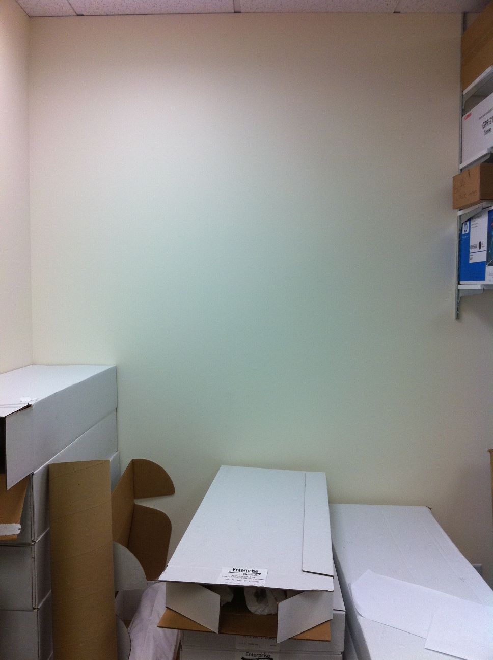

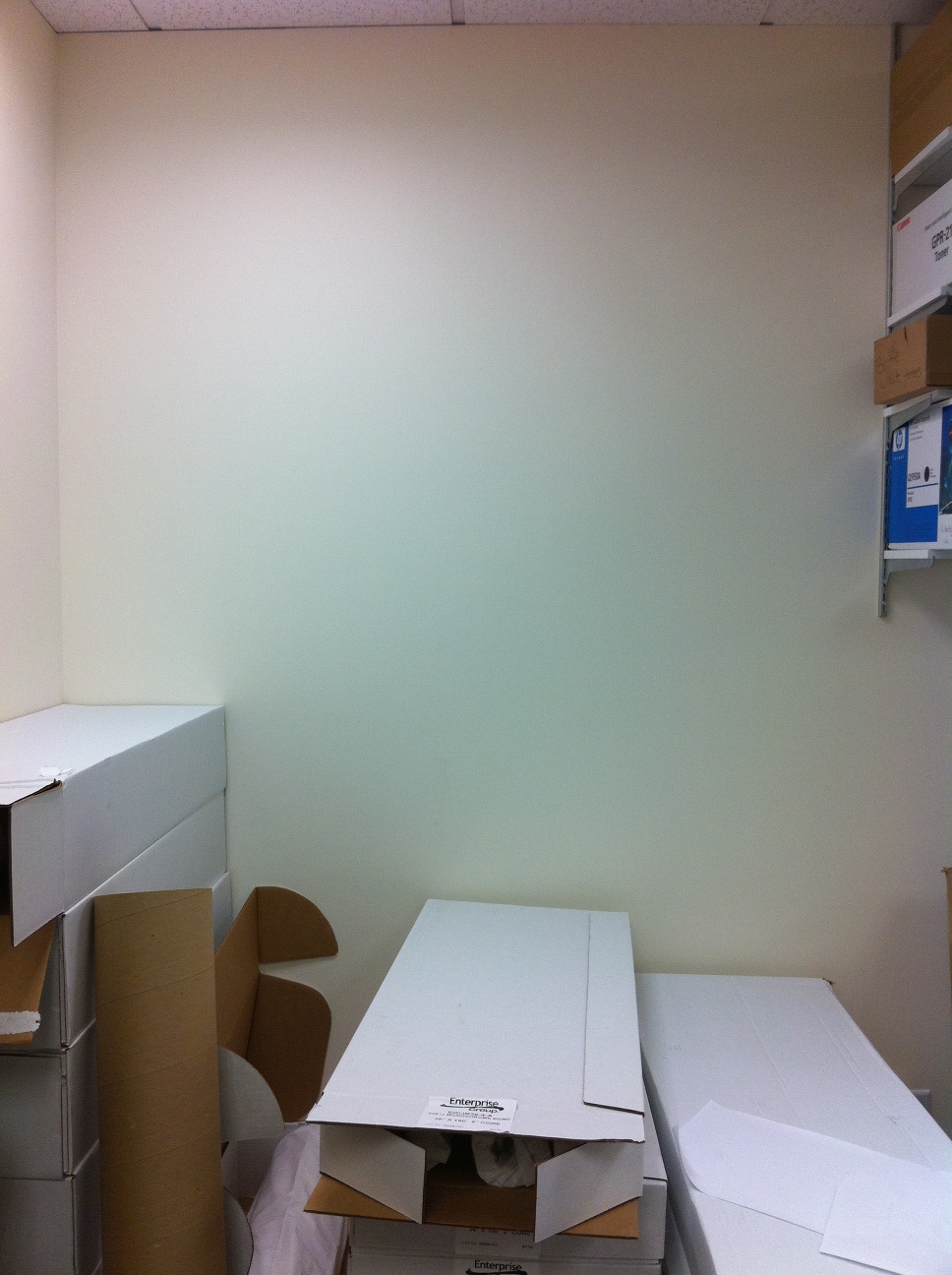

    Already tried to power cycle it
    Greeeeeeeeeeeat :rolleyes:
    [​IMG]
    edit: I'm going to cancel the appointment and wait to see what happens with hardware and software. Why change it for another green spot .....

    anyone else notice it and did you fix it without returning it?

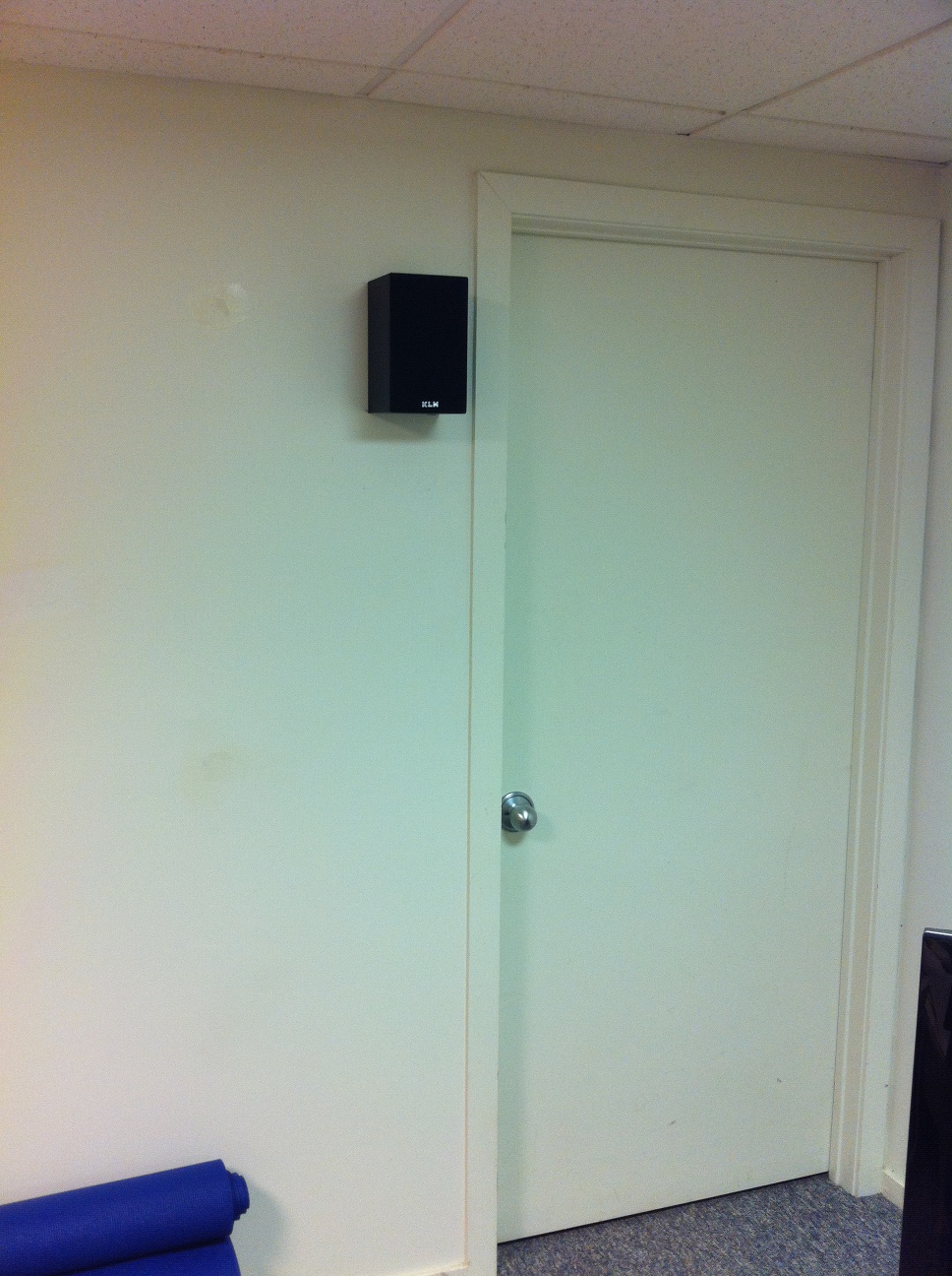

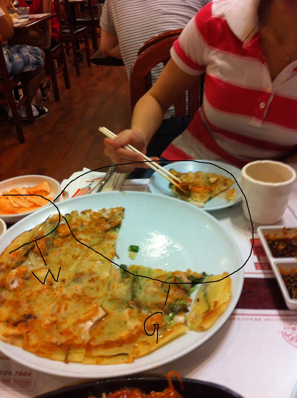

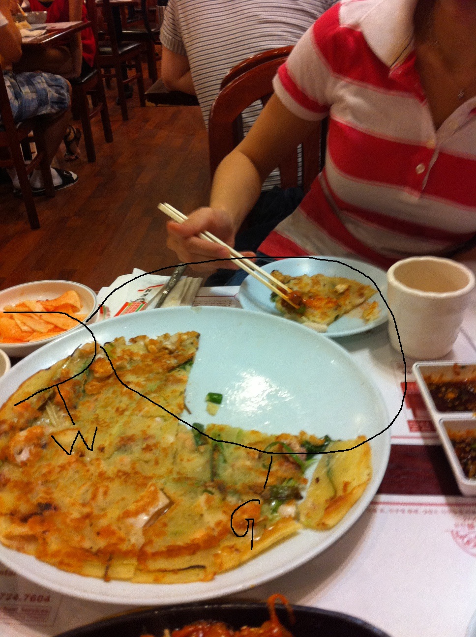

    OMG I have been on the phone with Applecare for the exact same reason.
    This is what the Applecare told me,
    that this might be normal for iphone...
    that iphone has an more advanced camera sensor like DSLR and that's why its picking up these things
    I took about two dozen pictures for Apple engineerings to analyze!!
    I uploaded some of the samples I took for them, except the one in the restaurant and it is not under fluorescent light

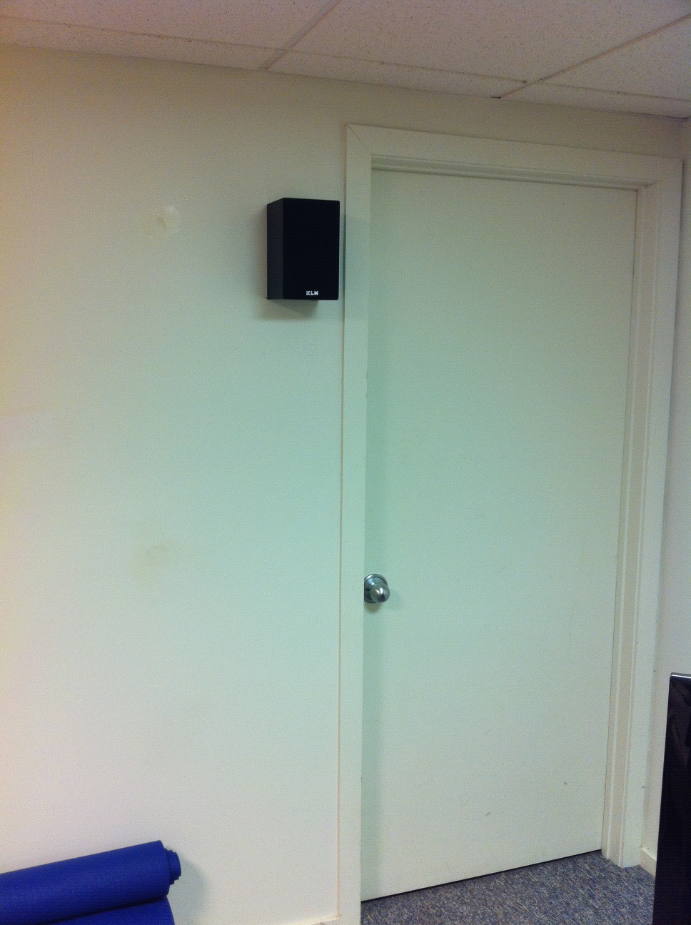

    that was actually my first thought but I discounted it since I had taken similar pics last week.
    I went outside and took a picture of the paper and got a nice, even result across the page (underexposed white lol).
    just strange that it only shows in the middle when the entire camera is obviously under cfl lighting.
    perhaps a lens issue

    #10
    good examples
